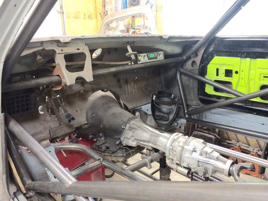

The view from the passenger window shows just how full of tubing this car really is.
Thanks. It is a somewhat complex set of tubes, and will probably be dangerous to even drive on the street, but I don't think I'd want to go 200mph in anything less. It does look a bit ridiculous, and I'm really tired of this stage of the build!

Dash bar is in. Hoping it doesn't conflict with any of my other planned additions like air conditioning!
Awesome metal work!! I'm not sure about other A/C system but don't think Vintage Air system will clear your dash bar. I have a few pictures of my Vintage Air system mounted with the dash off if you need them?

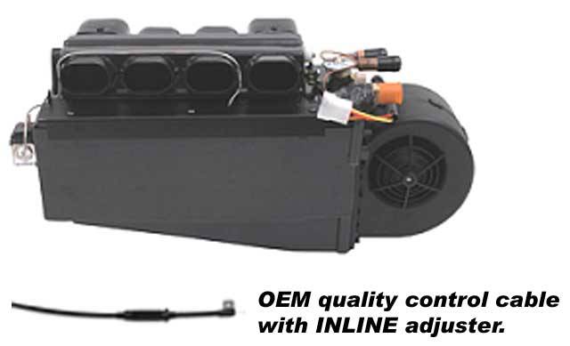

Thanks Pat, a picture or two would be great as would a dimension from the firewall. The bar is currently 10.25" from the firewall. My plan was to use a universal type street rod kit as I think they're pretty compact.
It looks as though the classic auto street rod cooler II kit will fit with room to spare.

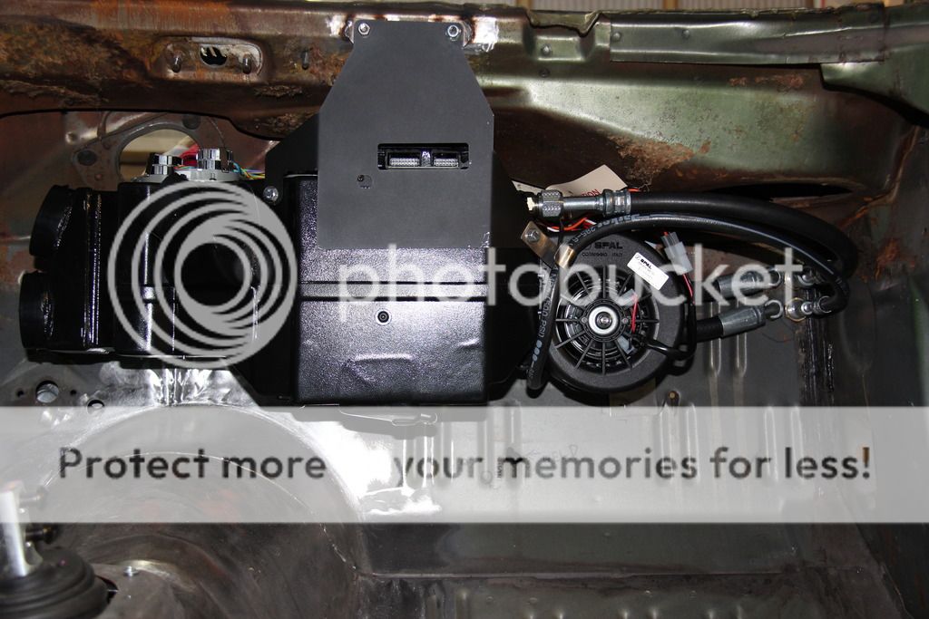

In this picture you can see the mount is flush with bottom of the dash flange, and it is also mounted to the fire wall. A street rod kit would be a better fit!
