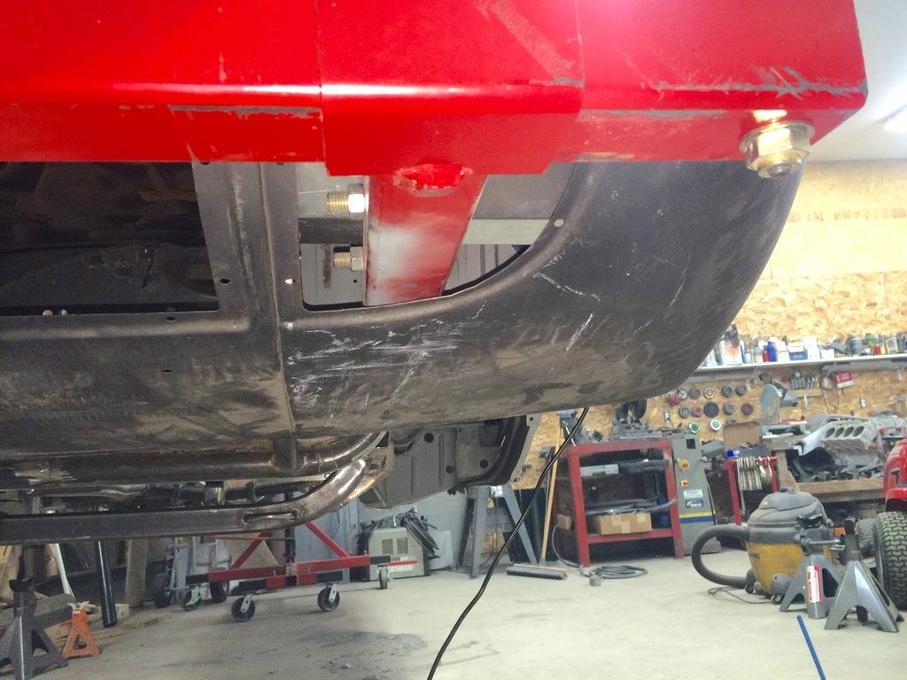

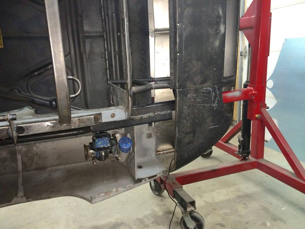

Thanks Pat. Now I have to build an extension for the rotisserie to accommodate that big nose....
So......I picked up some .187 wall 2x2 and made an extension for the rotisserie.
It was really tight going through the turn signal openings but there was just enough room. Now I can work on the lower fender extensions, valance panel and the chin spoiler/air dam/splitter assembly.
It's a 28' deep building and this setup takes up most of it!

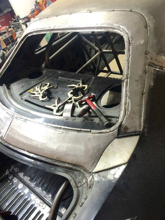

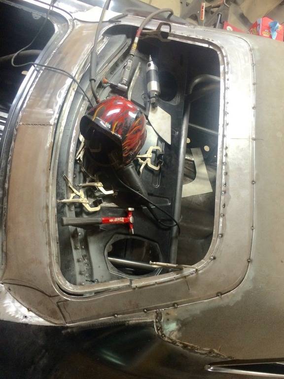

More time spent fixing this train wreck of a plug.
It would have never fit any car, let alone this one. I've completely deconstructed it and am in the process of reconstruction as it's fit to the car.
It was too wide by quite a bit and the shape was too flat. You can also see the window opening needed tweaking in both corners so the corner pieces would actually get anywhere near the rear window trim.
Once I finish the window opening, I will add the sheet metal pieces that flush up the inside of the plug and hold the headliner teeth. Then the plug will come back off so the bead rolling in the rear corners can be put back in the correct place.
Feel your pain, kind of. I had to do a lot of rear window frame fixing/rebuilding on my stock charger. That aero rear window plug/mod seems to me to be the toughest part of making a sbird or clona,. even if it fit right. I've heard of guys using cut out old Chevy Vega hatches., wonder how that could work/look right tho.
It works very well on the charger based Daytona clones. The bird clone is completely different. The rear window aero mod is the toughest part for sure.
