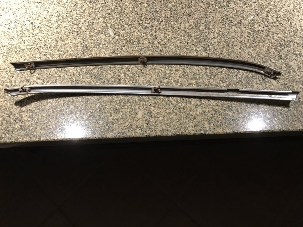

I found them Mike, one has all the clips the other has 2 broke but has 1 of them. They are pretty decent pm me with your info an I will get them to ya.

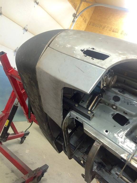

Using my template, I've been hammering out a lower fender extension. I may end up making and remaking these but I'll get there.....eventually.
Still need to fix the front curve on the fender and extension to match the nose.

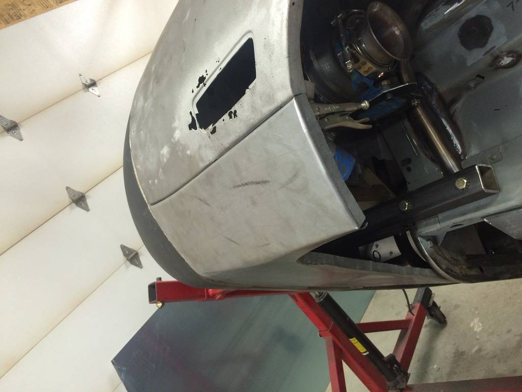

If I might make a suggestion. It looks as if the top fold that creates the lip for connecting the top of the extension to the bottom of the fender is folded too short. I would disconnect the two and let the fender drift out to match the nose and tack it to the nose temporarily the flatten out and re bend the upper lip of the extension at a higher point. Depending on how much material you have on that return lip you may have to add a bit of metal to it after you re brake it in order to have enough metal to make a decent connection. Just a suggestion but seeing how you have solved many other issues with the sheet metal you probably have figured this one out already. By the way your decision to use a lexan back window was a wise one. With all of the work you had to do to re shape the window plug you would have a tough time getting a piece of pre made glass to lay down in that opening or for that matter maybe even fit the opening.
Cheers.
The curve of the fender needs altered a bit. It's too tight of a curve in comparison to the curve of the nose. If I push it out with a brace, it looks like this.
And everything lines up. I need to remove the fender and take the front curve apart, re-form it and reweld it to hold the corrected arc.

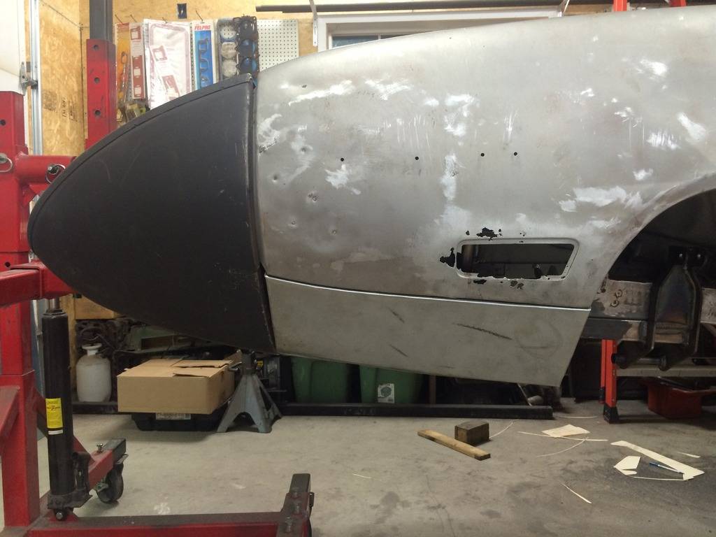

Here's the side view.
Some have commented that the extension should turn more vertical at the wheel opening where mine seems to follow the existing line.
Depends on how big a tire your running up front I guess. I like it the way it is.
That's the next order of business to figure out. I currently have a 15" front wheel with a 26" front tire. It should end up with a wider than stock front track width. I would like to eventually run a 17" front wheel with a 28" front tire. I definitely need to do some fit up before moving forward.
