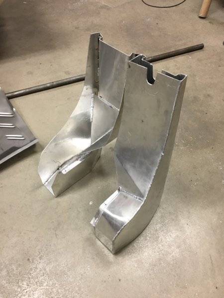

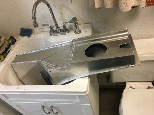

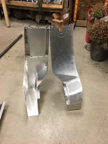

Even though it’s far from finished, I decided to leak check it in the shop sink and see what it holds. I estimated 4.5 gallons and it came in close at a little over 5. That’s 85lbs of just water weight. At least it’s behind the front axle. Barely!

I think you are better off than you believe! Water weighs in at about 8.33 pounds per gallon, so you have about 42 pounds of just water weight. Not too bad at all...

Thanks Hawk but there’s one of these tanks under each fender!
Doh! I guess I missed that part - must not have been following closely enough. I should never have doubted your number with the work going on here!:rolleyes:
No worries. I figured you just forgot the X2 part. I’m trying to be weight conscious, but I’m going to build it the way I want and see where it ends up. It can’t be any heavier than my other porker lol.

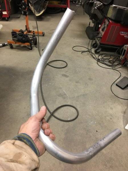

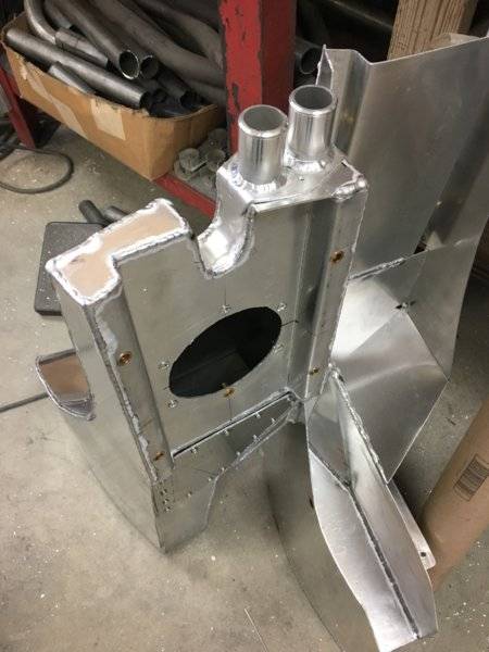

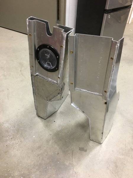

Working on the second tank. This one went much quicker. I also bent up some 1-1/4” aluminum hard lines for the intercooler.

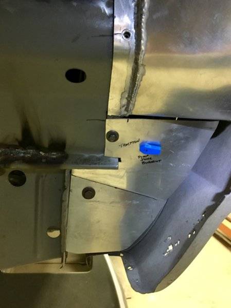

I made a trim panel for below the tank and incorporated a plastic drain to get rid of the hot water after a run. My buddy informed me that they’re right in line with the rear tires lol
Very unique way to use normally wasted space - cool stuff!! The great build continues...

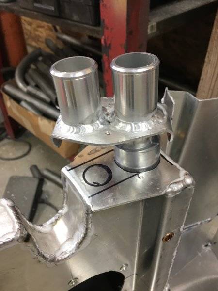

So....it’s the end of the intercooler tank fabrication. Literally. It’s the end, lol. I needed to be able to service the pump which means replacing it and/or the lines so the end needed to be removable. I turned the hose ends in the lathe and welded them into a bulkhead panel. I’ll use RTV to seal it and secure it with 4 screws.
Those tanks look great, nice job fitting them in an unused space.

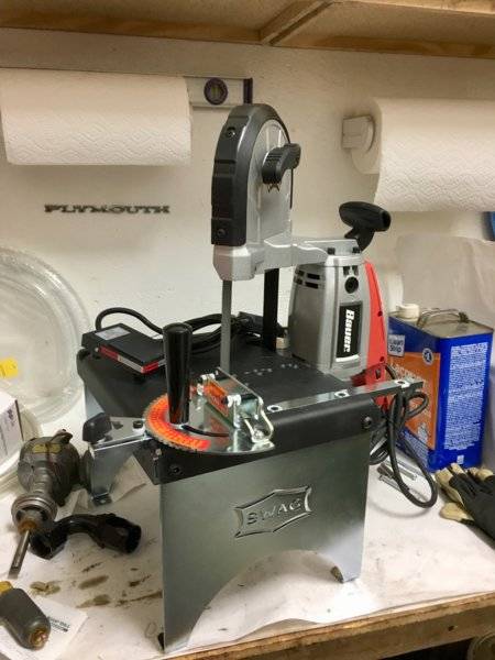

Picked up a new toy. Wish I’d bought this at the beginning of this project lol...
Looks nice, where did you find it? I might need one of those!
