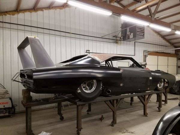

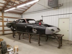

Thanks guys. Those wheels belong to a buddy of mine. We were using them for mockup to determine backspace on mine. I’m going to order double beadlock versions with a 6.5 backspace. He’s got 17” fronts coming so I might have to put this thing on the ground soon to get a real good look. Been busy working on everything but my car, lol.
a/c , never thought that way on my 63 , but i installed electric door window lifts . there were way littler ten all that stock mech . were are you putting the compressor ? and i like the cage action . stepping up my engine . so i'll be stepping up the cage as well . who's k frame is that ?
a/c , never thought that way on my 63 , but i installed electric door window lifts . there were way littler ten all that stock mech . were are you putting the compressor ? and i like the cage action . stepping up my engine . so i'll be stepping up the cage as well . who's k frame is that?
Compressor will be a low mount serp belt SD7 on the passenger side with the alternator right above it. It will all attach to my motor plate. K-frame in my car is one that I built patterned after the RMS Alterktion. I have no idea who made the one in that 65. It’s not my car.
