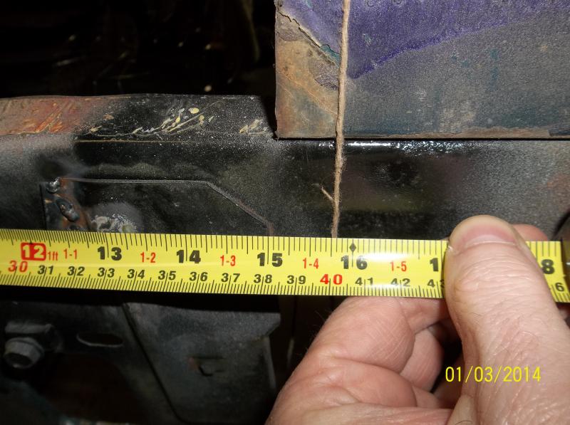

100_0585.jpgWhile changing the rad saddle from a 22" rad to a 26", I had a few people inform me that only the passenger side support needed changing. I replaced that side and took measurements (before and after) and noticed a 3/4" discrepancy. It took a while to figure out where that actually was, and hence grafted a piece to the drivers side support to rectify that. I don't know if this is just this particular model, or if it applies to all. I hope this might help others if they run into this situation.

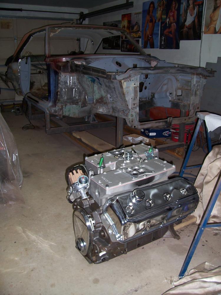

100_1914.jpgSince it is Friday night, how about some car ****? Lol
What car is the last pic? I thought you said this was a post car and by the VIN it is. Nice job tho.
photoshop central in the last pic lol , I like the floating hemi.
I kinda threw a curveball, bigblock...that is a 66 coronet. And super77se, sorry to disappoint... that is not photoshopped....that is actually sitting in front of the car, on a piece of wood....just some car **** for you guys... lol

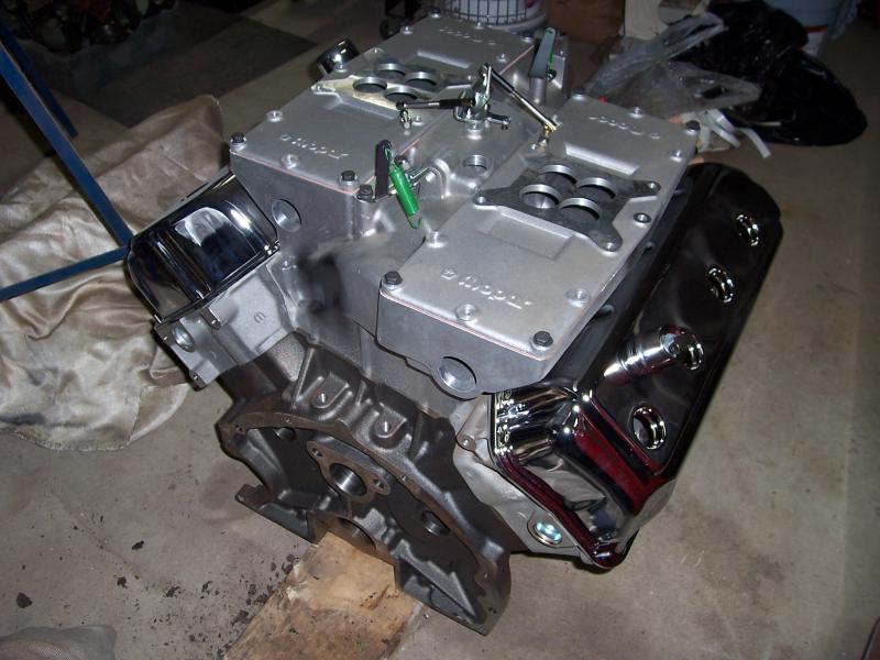

100_1916.jpgjust a mock up for a friend, he wanted to see what it looked like...
haha , wow great pic. the car looks outlined in black too. that is one badass engine. I wish it would "float" on over to my garage lol
LOL!!... I looked at the pic again and I do believe that is the flash from the camera that caused that outline...
