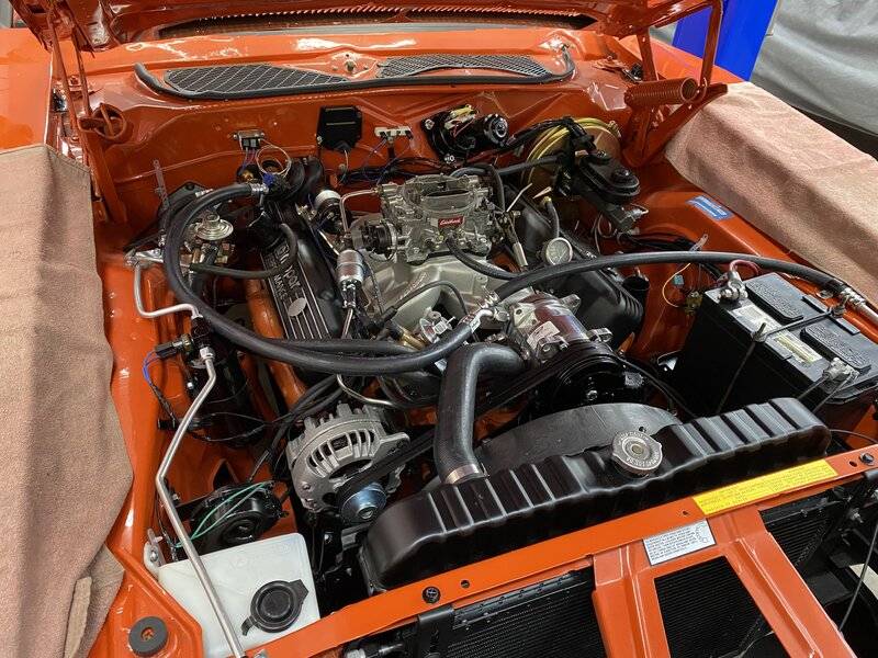

What make radiator do you have?
What side is the lower hose outlet on?
It’s an aluminum sold by auto city classic on eBay. My lower is drivers side but they have both.

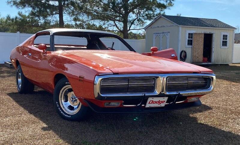

She just went around the block for the first time in 30 years! Engine, trans, and rear feel great. Spun the tires with no effort! Break in video coming soon...

Got it fine tuned. It likes 18 initial and has 18 inches of vacuum at 900 RPM. Nice and smooth but cranks up fast when I hit it. Oil, fuel, and water gauges are accurate and battery is charging.
Coolant was puking out the overflow but a new cap solved that, now it pressurizes fine. Left rear valve cover leak but got it snugged and it stopped. Rear main dry!

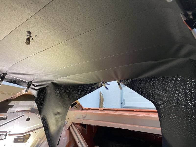

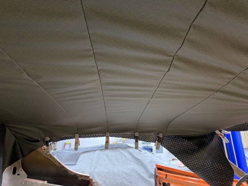

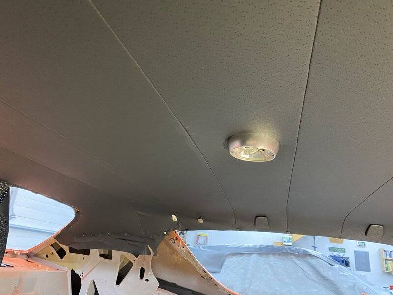

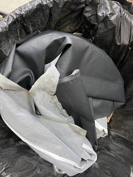

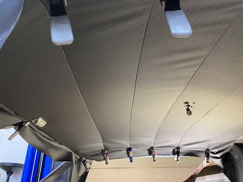

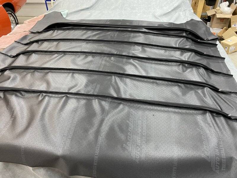

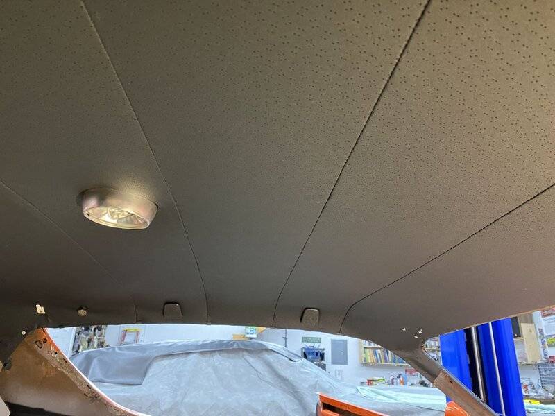

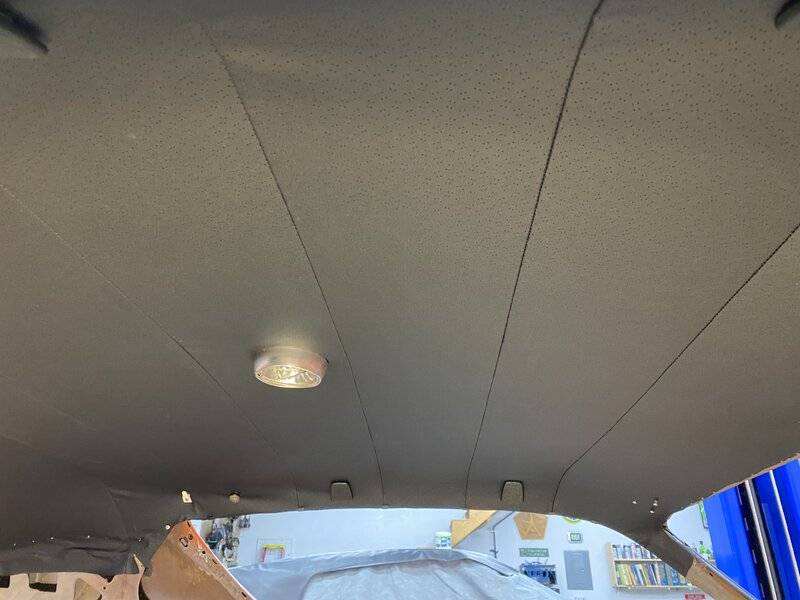

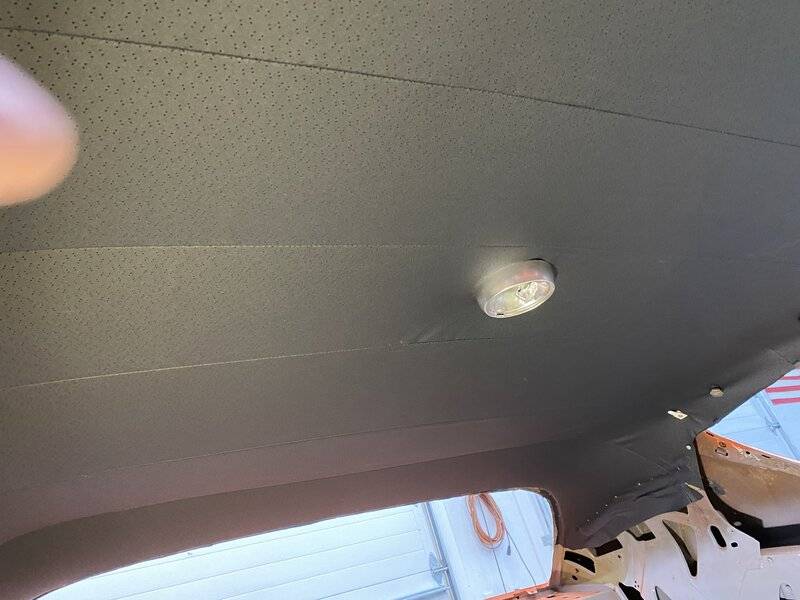

Headliner is done for the second time. What a difference a quality product makes. I screwed around with the REM headliner for three days, got frustrated and ordered a Legendary one. Took all of 5 hours and it came out great. The REM is in the trash. I used lots of good spring clips as I stretched it out. Worked out well.
