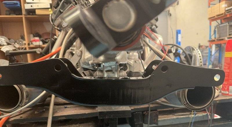

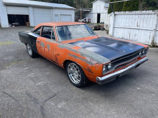

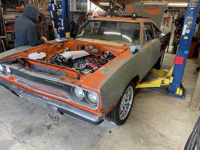

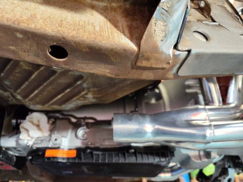

This is my 72 roadrunner/6.4 SRT with hooker headers sit up close to the body although they go close to the torsion bars

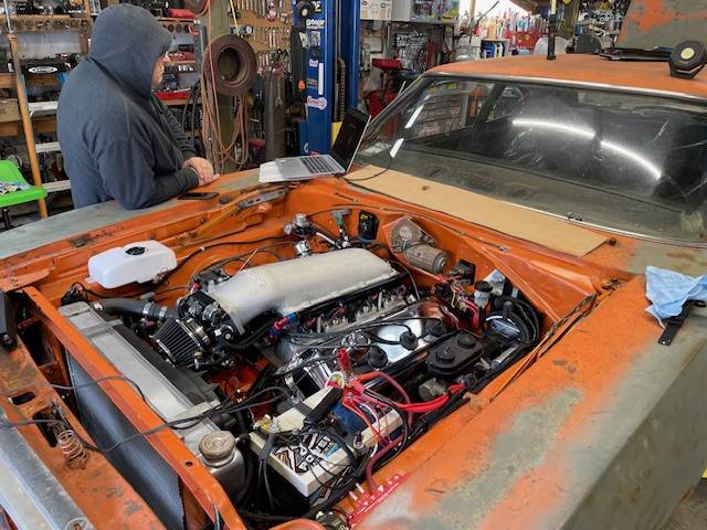

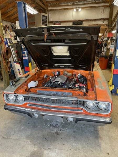

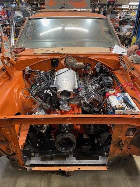

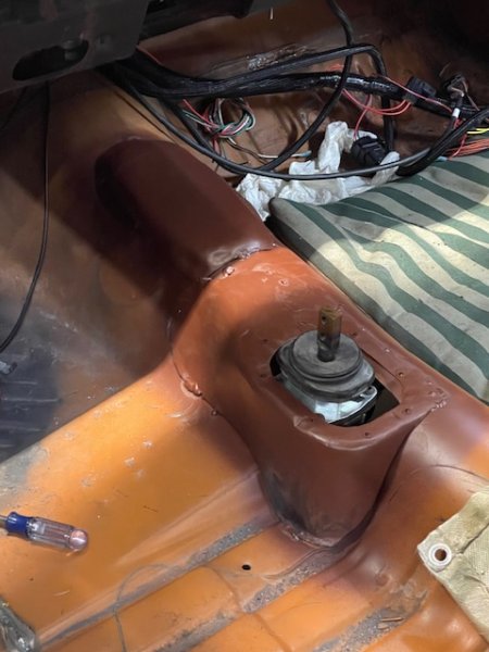

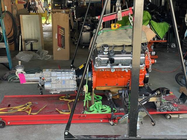

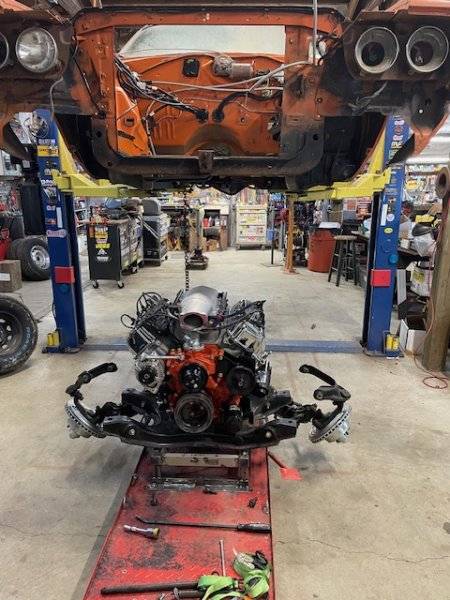

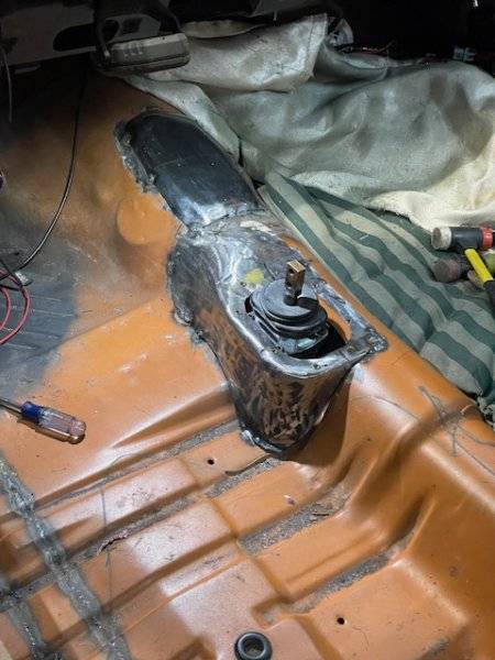

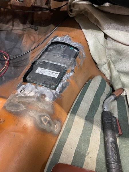

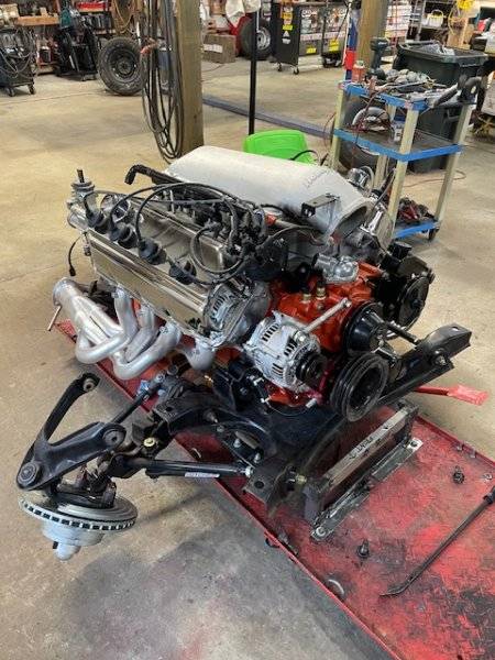

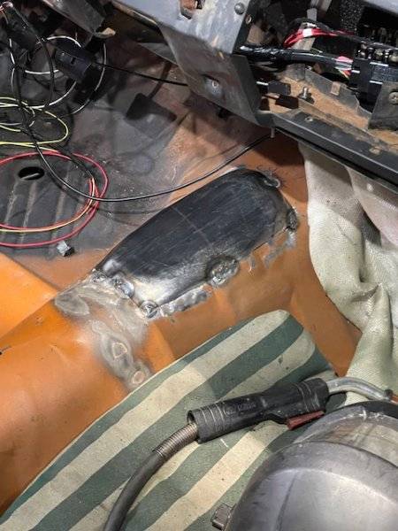

Its been a long 2 weeks but we were able to essentially build a running and stopping car. Got the 572 in, had to do some slight surgery to the floor pan but got it sorted. I cut down an old 4spd hump and made it fit the floor nicely (IMO).
For those really looking, the shifter is in the E body location on a 70 B body, this is what the owner wants and despite my reservations I think it worked out very well.

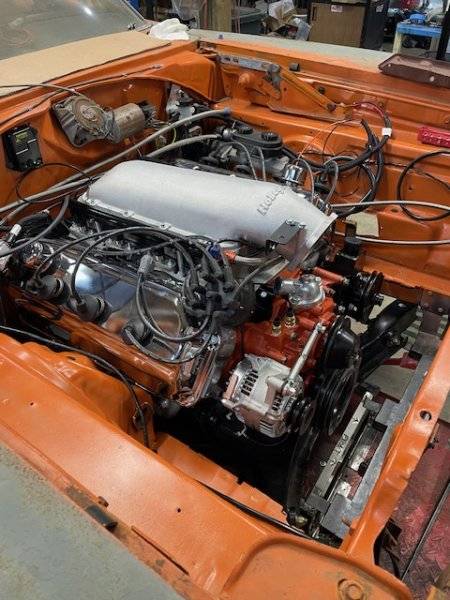

The engine fired up pretty easily and we had a tuner dial in and adjust some things. It is still pretty cold blooded but it is angry and you can feel the power waiting to be released.
Here are some pics
A few more pics. The car should be heading to Australia in the next few months.

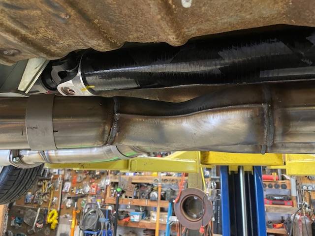

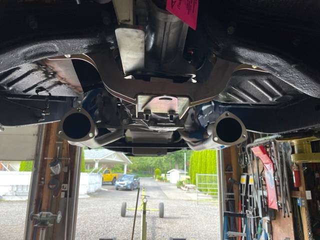

We are running 3" exhaust which fits pretty well and he ordered a CF drive shaft for it.
Looking good what state is it for .
What mufflers did you use i am using 3" Hooker Aero chamber with cat 5 cats which you have to have for licencing in WA also have to keep to less that 92 DB noise level for WA i think other states are different that going to look hot.
Queensland
We used Magnaflow mufflers and system. It has a nice rumble but definitely isn't loud. I am going to attempt to put some videos on YT, if I do I will post the link.

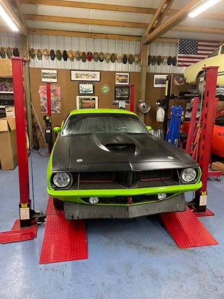

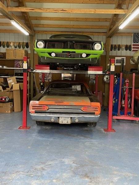

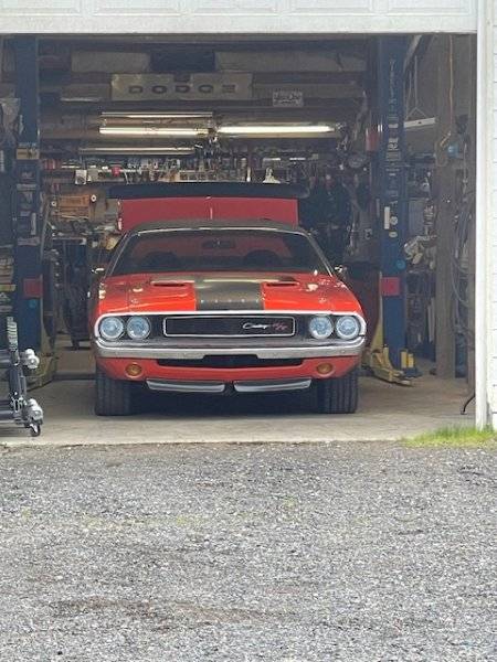

Well I don't have any updates on my Charger because I was consumed by the building of the 70 Roadrunner, then I bought another 4 post lift so I had to go and get that, then install it. Installing it was a bit convoluted because I had to get my 70 Challenger out of the shop along with my 73 Cuda.
The Challenger fired up so I was able to drive that out, but the Cuda did not want to play (fuel pump isn't working for some reason). All that said, I was able to get them out and get the lift put in.

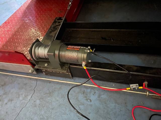

Then I had to get the Cuda back in, much easier said than done mainly because it has 315s in the back and I think 215 in the front. It does not roll well so it took some effort to get it onto the lift. I had to get a small winch and build a mount so I could pull it onto the lift which worked well.

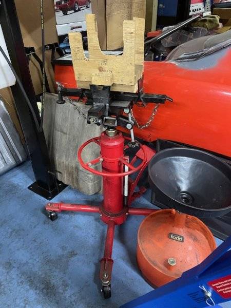

I also got a bonus with the lift, I got a very HD transmission lift as well as a oil recovery tank (think you drain your oil into). The lift had a bunch of pans as well as 2 lift plates which allow you to put a jack on and lift the car when it is on the lift.

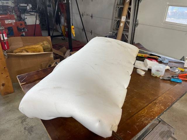

I have done some upholstery in the past but I am in no way an expert or even skilled at it, but I also am not a novice. The first think I noticed is that the $400 seat foam was not for a 71 Charger, rather it is for a 70 Cuda or a 71 Challenger with cloth seats. After looking online I found a new set of foam for a 70 Challenger with vinyl seats available from JEGS so I gave them $440 and received the new foam pretty quickly.

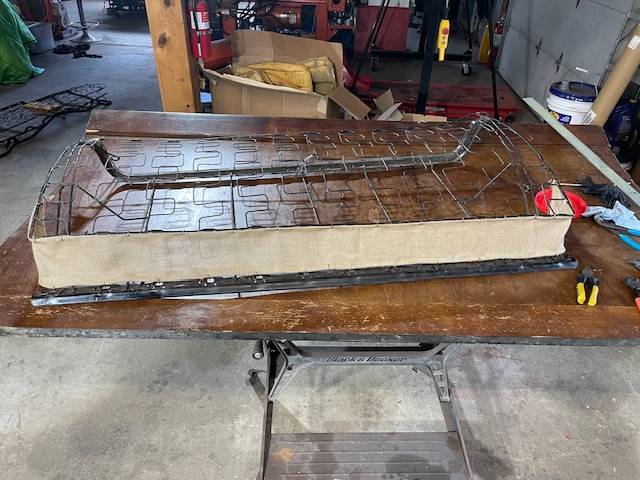

So now I was all ready... I began to recover the bucket seat frame and everything was going ok until I went to put the new bottom cover onto the new foam. I discovered that there was a lot of extra material in the middle of the seat which made me look at the differences between the cover and the foam (as well the placement of the listing wires onto the frame). Lo and behold a 71 Charger uses different foam from a 70 Challenger.... go figure.

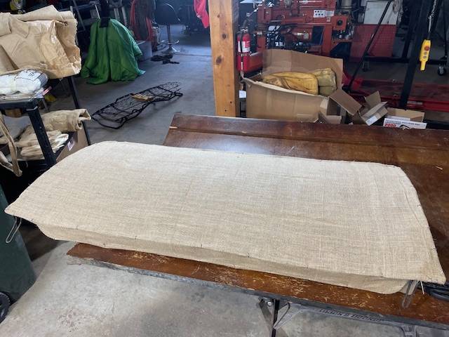

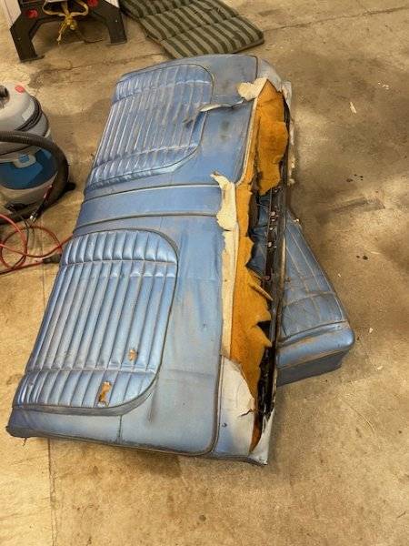

So after some thought I decided to just forgo the bucket seats and just redo the Charger rear seat. This went great until I went to put the cover onto it, it was then that I discovered that the 1.5" foam is a bit too thick. Also I think my technique was flawed here and it might be that the 1.5" foam would work (although it would be pretty tight), we will see. The stock stuff was about 1" thick.
So now I have 70 Cuda and Challenger seat foam but 71 Charger covers. I will eventually get 70 Challenger covers but it might be awhile.
I also discovered that 71 B body does not use cotton batting as did the 70 and older, they used foam and since I bought that handy kit from Legendary I now have some of that, but I can use that for my 70 RR or probably even my 68 Cuda.
