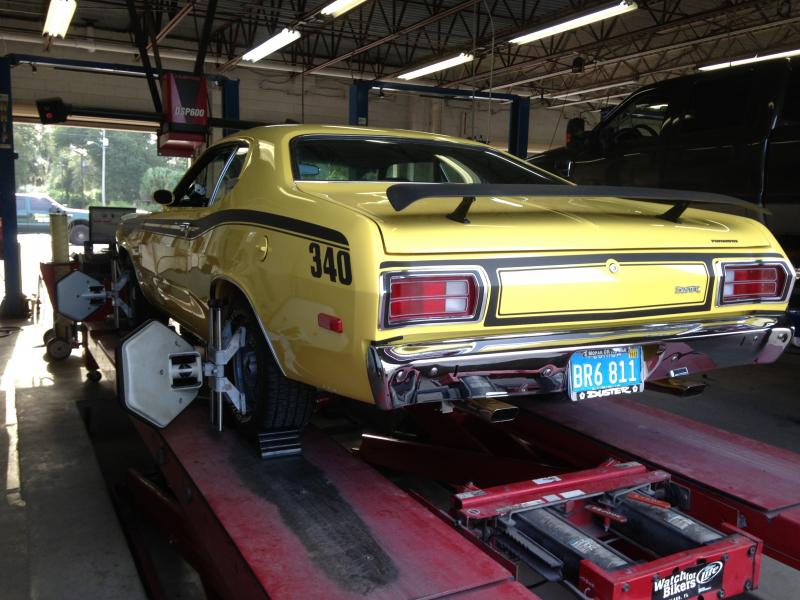

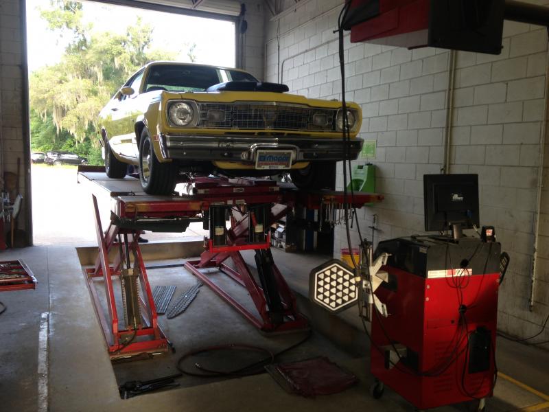

Made it safely to get the front end aligned. Here are a few photos of the car on the rack.

here is a photo after the alignment was done. The wheels look straight now !!! Lol.
The car drives like a dream.

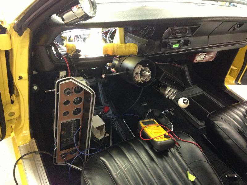

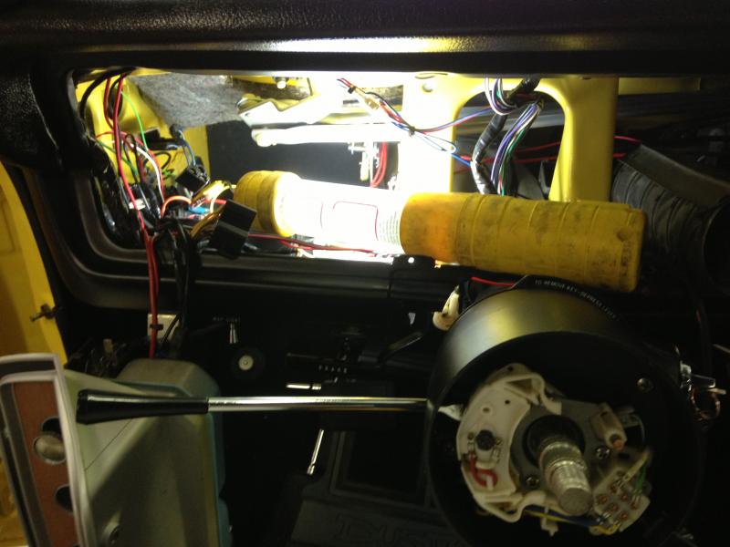

The good is that I have made some great progress with the wiring on the Duster. I had to pull the dash back apart and start tracing out wires one at a time until I was able to get the AC clutch and the heater fan motor working.
The horn is the last obstacle. I have power to the relay. When the wires leading to the horn from the relay are energized, both horns work. I checked the steering wheel horn contact and it grounds the system when the button is depressed.
The horns still do not work. I am thinking the relay is bad. I don't hear any clicking noises from it when the horn switch is closed.
Anyhow, here is a picture or two of what the dash looks like on the Duster.

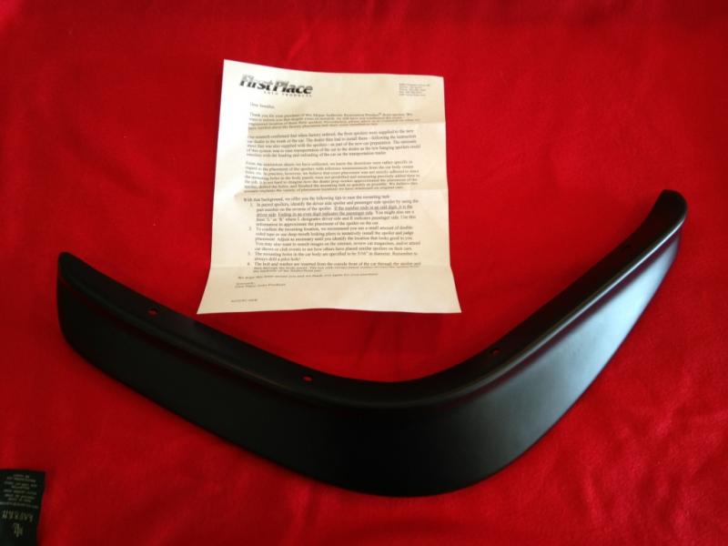

Parts Pictures as Promised
IMG_0328.jpgIMG_1862.jpgIMG_4693.jpgIMG_5585.jpgIMG_7339.jpgThanks for the thought and prayers everyone. You all are some wonderful people.
I sold the Duster back in December when it was still on the rotisserie. I used part of the money from it to live on, while my wife was out of work when she severed a ligament in her ankle. Then I used some to buy the RR, the parts car SSB, and the parts shown here on this thread. So I am sad to see it go, but things happen for a reason. I have always liked the body styling of the 71 and 72 B-Body Plymouths, so when I had the chance to get this one, I jumped on it. I have always wanted one, so I can cross this off the bucket list.

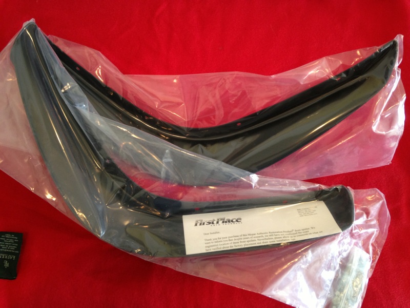

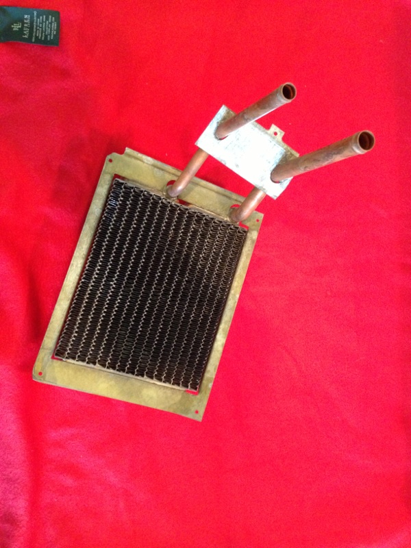

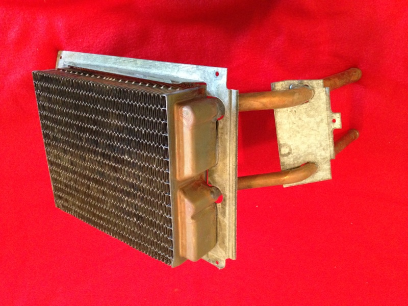

Here are the pictures of the heater core and the chin spoilers for the Bird..........

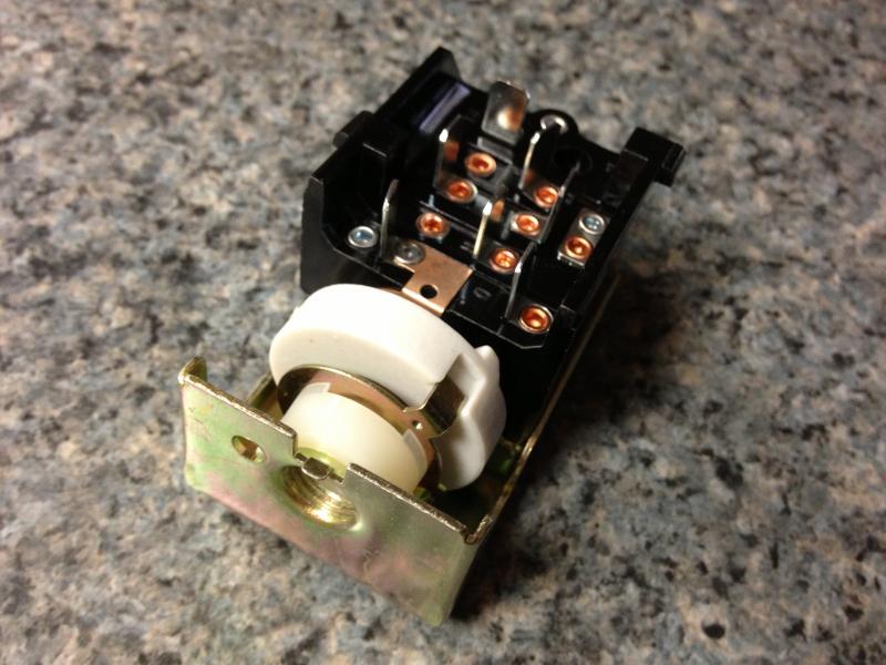

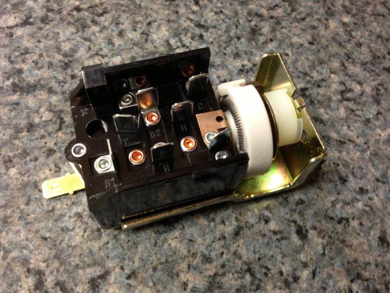

image.jpgimage.jpgThis afternoon I stopped by a local parts store and they had a brand new head light switch for the Bird in stock. I'm pretty sure this is a fairly common application part that fits many of our Mopar muscle cars.
Here are a few pictures along with the box end that shows the part number. It was less than $20 out the door.
