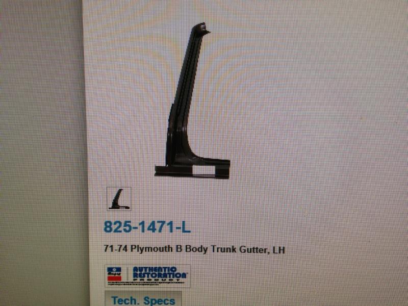

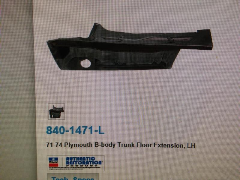

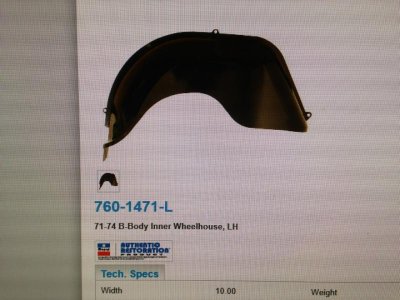

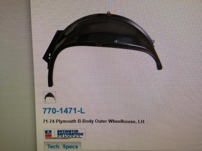

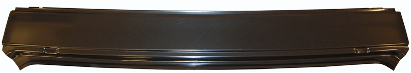

That's the one !!! I also need the outer wheel opening, trunk floor extension and trunk gutter for the driver side. Then the body shell will be good to go.
Your gonna think I'm crazy, but I've even been considering putting all of the original rust free bolt on parts back on the 72 SSB. If I did that I could get her on the road that much quicker.
Thanks for the link!!!
That should have stated "outer wheel housing". Oops

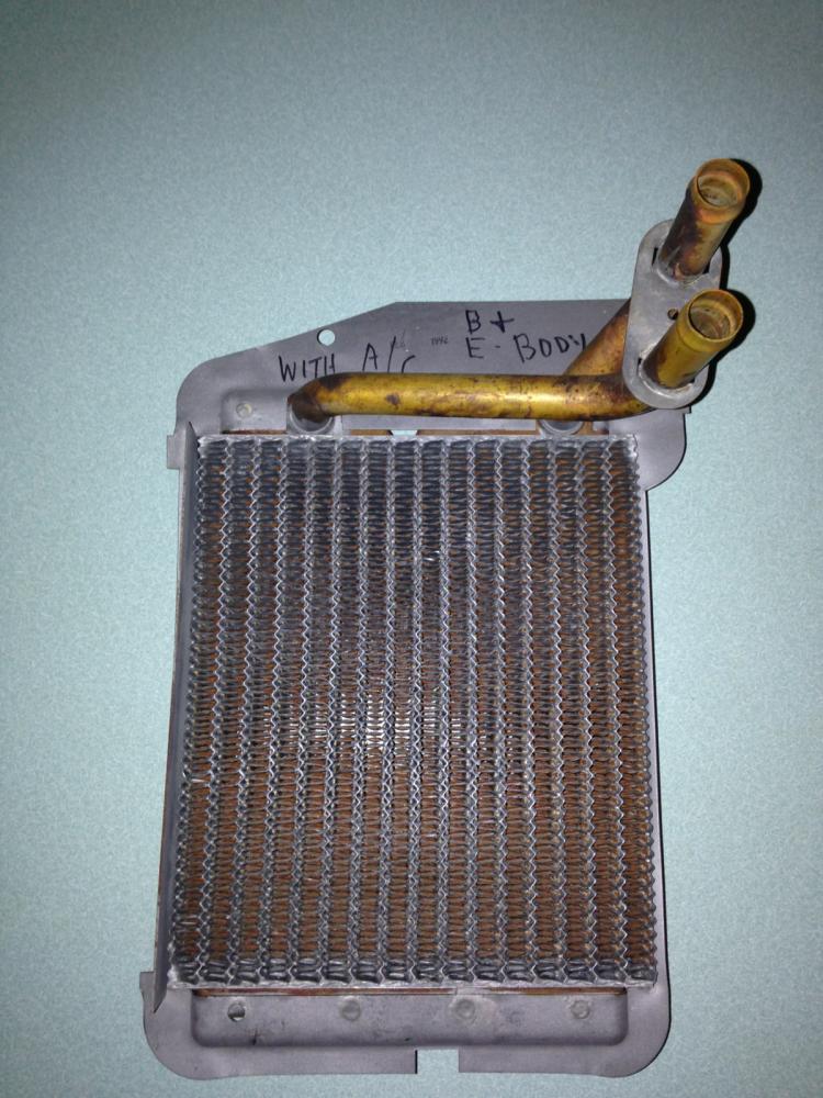

I thought I had a new heater core stashed away........... So I started searching for it and sure enough I did. It also fits E body cars with AC.

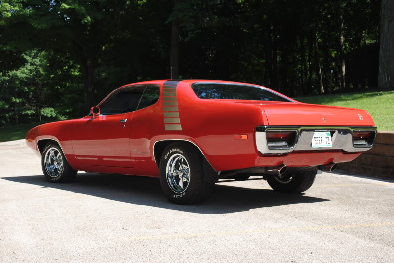

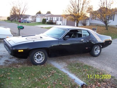

Now I'm just throwing this out there............ I found these pictures on the internet. If these car belong to anyone here I'm just using them to get an idea of what I might want the car to end up looking similar too. I'm really liking E5 red and black........
This car is going to be a nice driver and not "show" quality. Which ones do you like the best ?????
72 RR red chrome bumpers.jpg1972-plymouth-roadrunner-arrest-me-red.jpgBlack 72 RR magnum 500.jpg
I like the roof stripe. Not a big fan of the "tank tracks" on the fenders.
I will most likely be painting the bumpers. So I'm leaning towards red with a black roof stripe. I have a set of magnum 500's and the rally wheels. Unfortunately they are both 14 inch rims, but that what some of these cars came with. I also have a set of steel wheels and could go with the "poverty hub caps".
Any thoughts or ideas here ????
There is something about black with the matte black stripes that look soo good. White stripe looks good to. I agree with leaving off the fender stripes. Hint. Hint...Keystone Klassics. Man, you are going to have to start a new thread for the Runner!
I'd go with black, black strobe stripe, black cop wheels, black bumpers and no tank tracks. And, you are officially insane to do two projects at the same time:upside down: ! It's going to be awesome to watch, though!
Double Trouble..........
I like this scheme too. Thanks for the input.

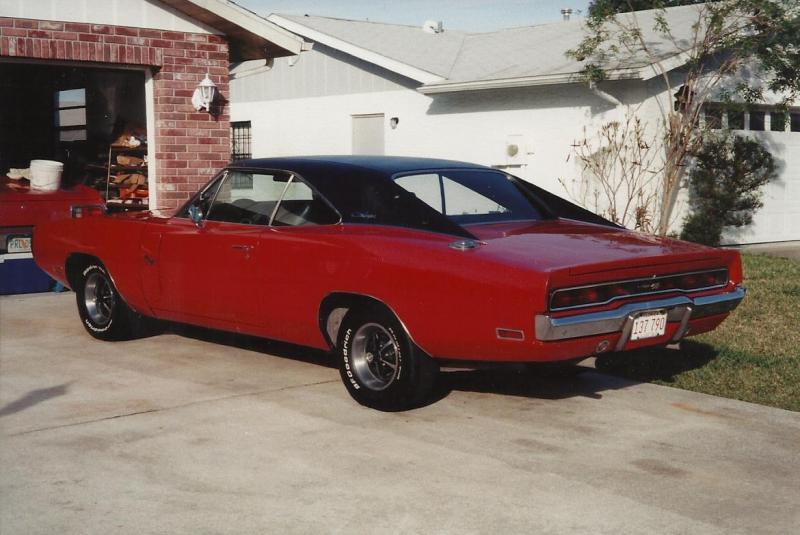

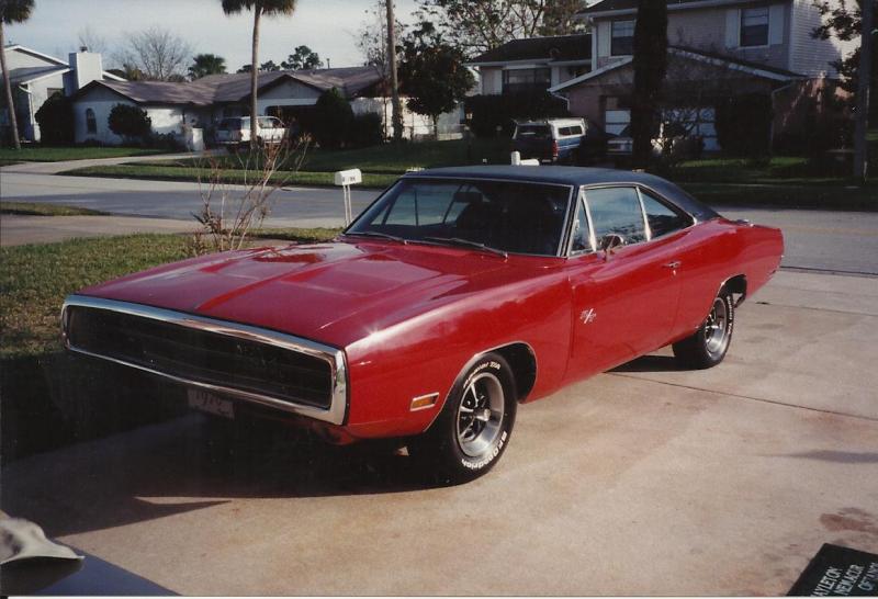

It's been too long since I had a nice driver car. The last one was in 1998 when I owned a real deal 1970 Charger R/T red with black vinyl top, Magnum 500's. I had to sell that one so that I could afford to go to school full time and not have to worry about working at a full time job. It killed me to do it but you do what you have to at the time to get by.
I'll have to see if I can dig up some old pictures of the Charger.

72 RR all black.jpgmopp_1212_4_1972_plymouth_road_runner_midnight_pride_.jpguntitled.jpg
Sorry, No tank tracks......... Just can't do it.
Man I was skinny back then.......... My hair was dark too !!!!!!
If you look close in the garage you will see the 340 Duster. At this time I had owned it for a few years. It was red then.

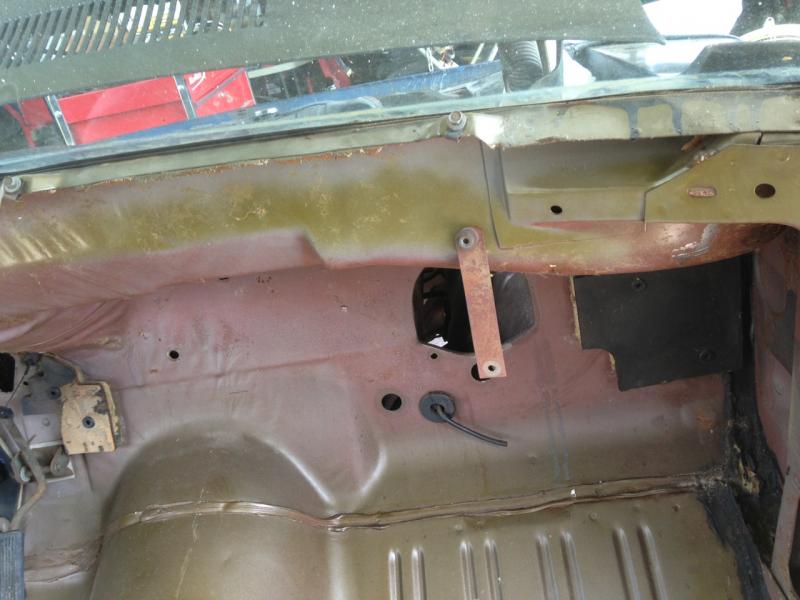

Window removal etc.............

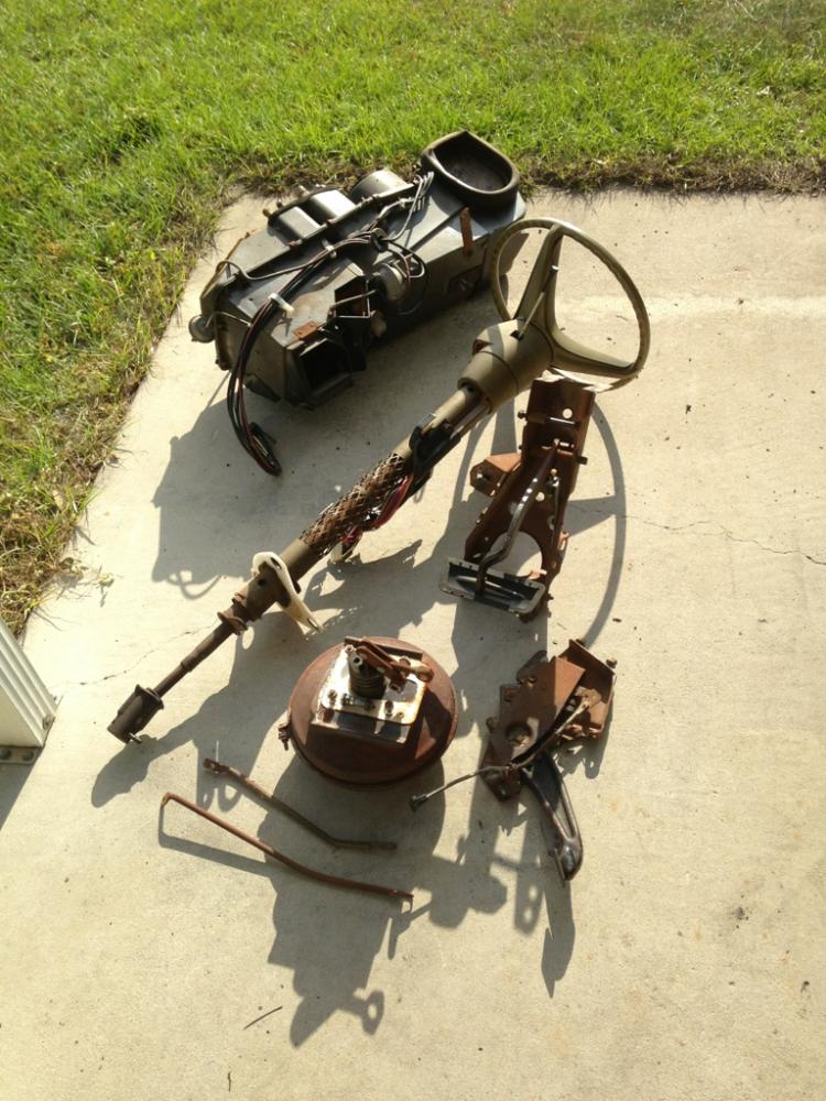

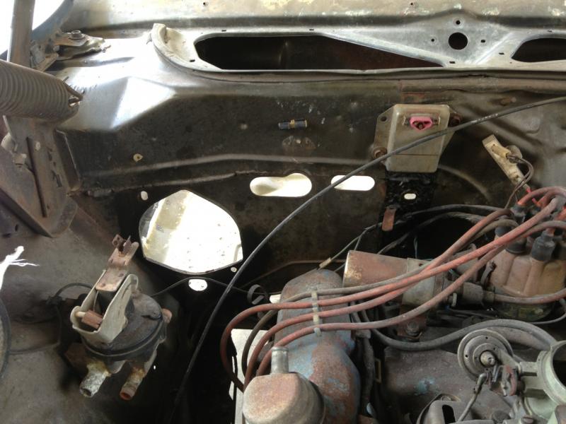

Today I was planning on just removing the AC / heater box from under the dash. Then I was going to install the heater core and go from there.
As usual, I couldn't leave well enough alone...........
I ended up removing the dash frame again, followed by the AC / heater box, brake pedal assembly, emergency brake pedal, brake booster, and steering column.
My logic behind this was now I can paint the floor pan and inner fire wall BLACK !!!! Yep. Decided on the color. Thanks for the help.

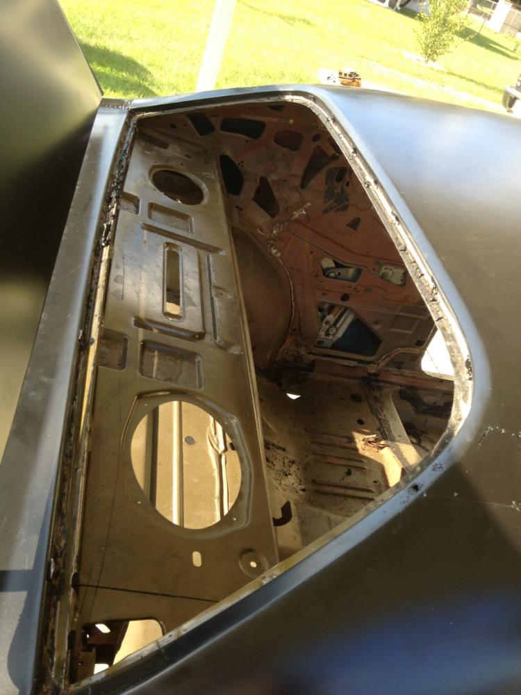

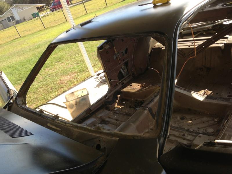

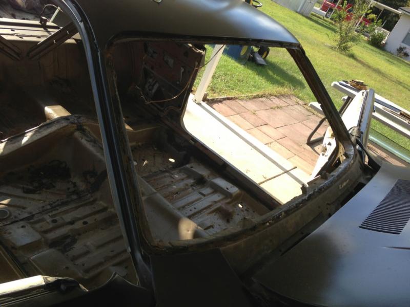

Then since I now had easy access to the glass, I removed the windshield and back window. The back window had to come out to remove / install the new AMD quarter panel.
I was very pleased that no rust was found behind the glass. Now I have to clean all of the old adhesive off around the windows, then start cleaning the floor and fire wall areas up so I can paint them black.
While I have everything off the dash I'm going to glass bead and paint the parts before I install them back in the car.
I want it to look good but I'm not going to go crazy with it. I'm just trying to preserve this car since the body is so good. If I put a good coat of paint on it now, it will last for many years to come.
I forgot to mention above, but I also removed the accelerator pedal, and all fire wall insulation as well, and the dome light. Now the inside passenger compartment is bare, ready for a good coat of paint.
I may end up replacing the deck filler panel too while I'm at it. I was looking closely at it today and it has a little rust. However, I may just end up patching it. It's really not that bad at all.
The area that has a little rust is at the trunk gutter area where the trunk seal goes.
I will know more after the quarter panel and adjacent metal has been removed.
Wait a minute. I thought you have to remove the glass to get the dash out ???
I'm glad I didn't cut her up for parts now.
Oh hell no
I've come to know how you operate so if you tear apart the steering column and rebuild it please show a step by step how to as I'm contemplating doing that on my R/T while the engine is out.
On 71-74 B body cars and all E bodies, you can remove the dash without having to remove the windshield. The upper dash frame mounting screws are located next to the defroster duct work at the lower edge of the windshield. You have to remove the speaker cover on B body cars to get to the screws. Its a pain to get to them and you have to use a long extension with a swivel.
On all A body cars the upper dash frame screws are located under the windshield gasket, so on these cars the glass has to come out first.
I don't remember what the deal is with 66-70 B bodies though. Sorry
