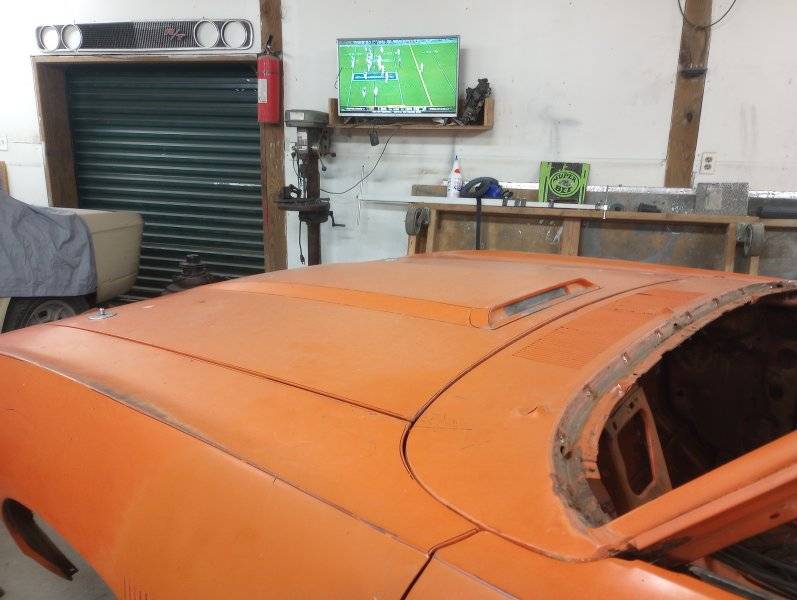

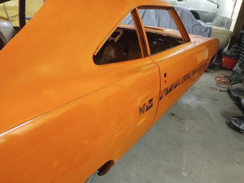

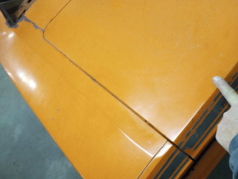

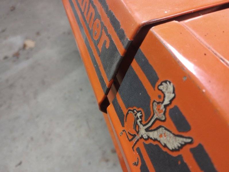

my first move is to gap everything as close to perfect as I can. The doors and trunk lid won't move for a while, as they will serve as my jig.
the doors were both hanging low, but the hinges were tight in that position..... and there was plenty of room for adjustment. All those bolts were TIGHT, and obviously never disturbed...... little lazy on the assembly line? :rolleyes:

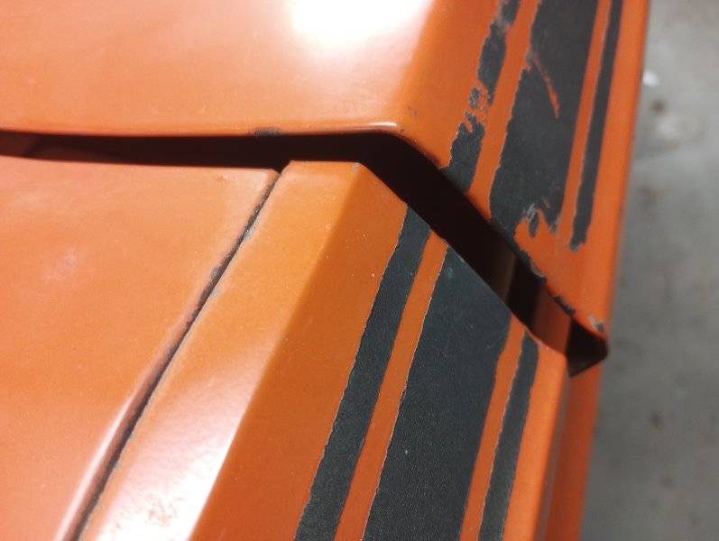

not sure what's up with the deck lid...... it's almost as if the trunk hinge brackets were installed too far rearward :eek:. Maybe it's one of those "Friday cars" :D..... nothing's bent, and it opens and shuts fine; so I modified the deck lid a little, it'll be our secret.
oh, I have a nice lower tie bar in my pile to replace the smashed one........ it was forcing the hood latch support too high :blah:

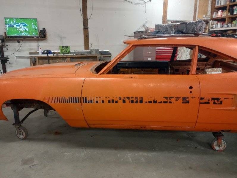

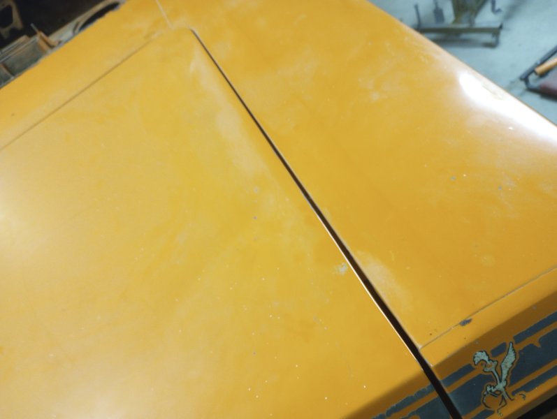

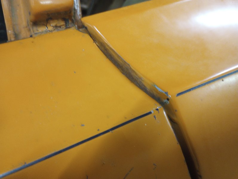

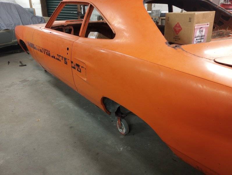

have some pictures ...... :poke:
before
View attachment 1787043View attachment 1787045View attachment 1787046
after....
View attachment 1787047View attachment 1787048View attachment 1787049
View attachment 1787050View attachment 1787053View attachment 1787054View attachment 1787055

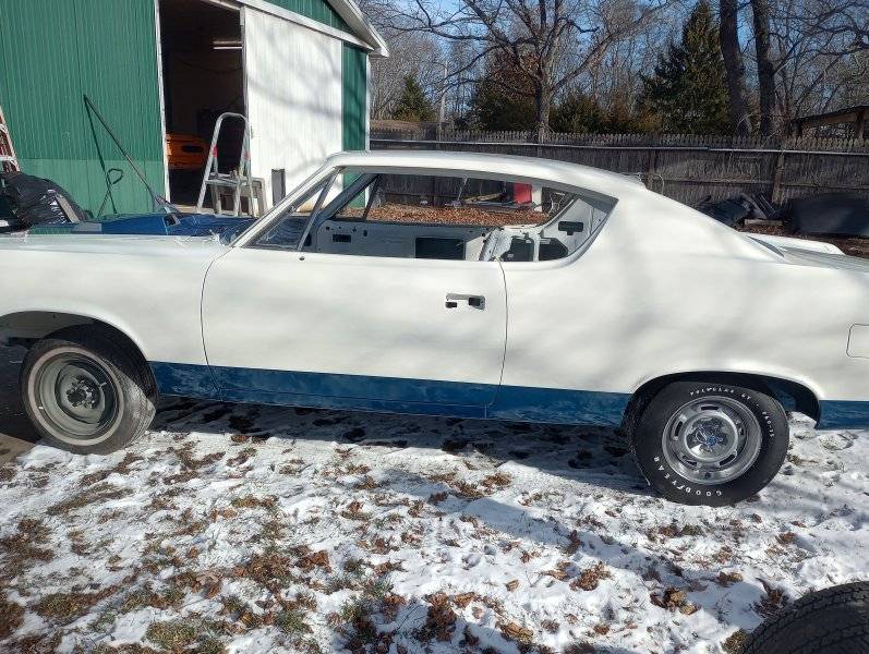

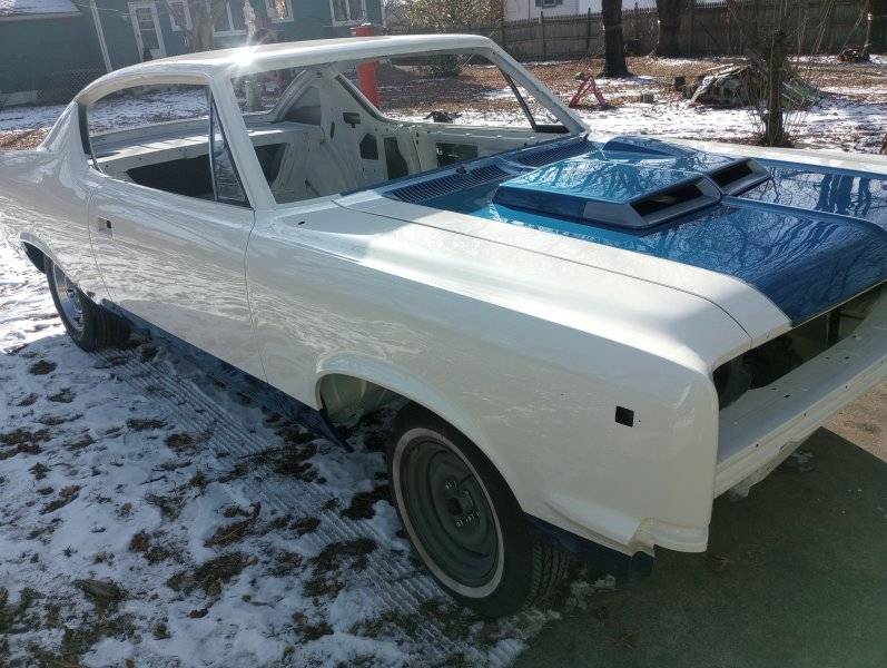

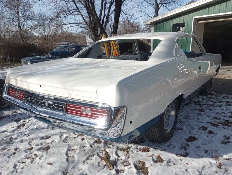

after you saw it and I said it was a factory looking job and was only gonna do minimal buffing....... I sanded and buffed for the better part of 3 days :BangHead:
but yes, Thank You

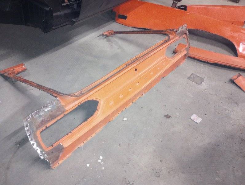

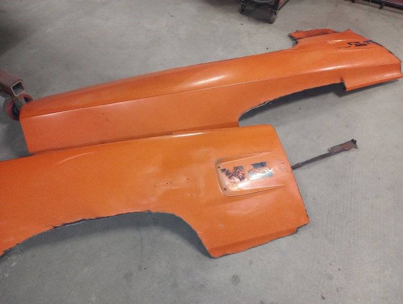

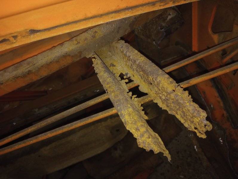

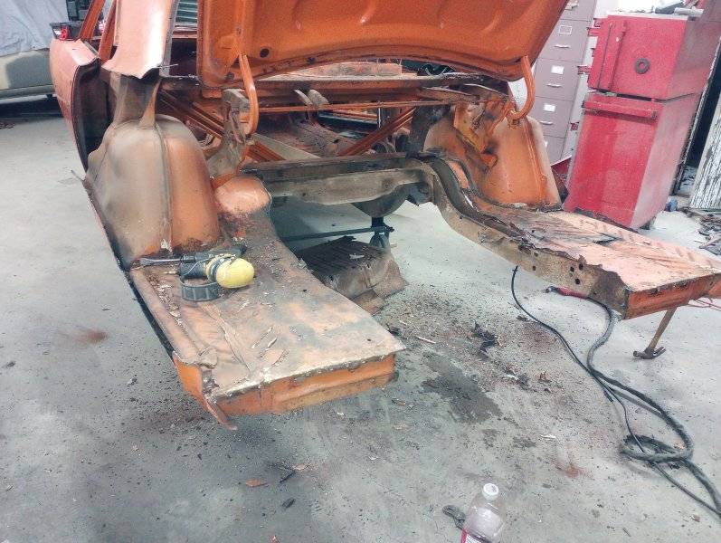

Now you can walk right up to the Dutchman. Those outer wheel houses look great! How is the tail light panel now that it's apart?
He's been up the asses of so many Mopars,we should call him the Mopar proctologist!

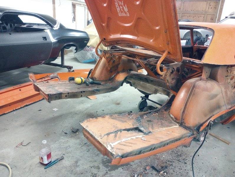

tail light panel is fine, one little crusty spot along the pinch weld........ I have to fab up a couple of dutchman supports
inside the rails is pretty clean
We know where the water sat, must have just pooled inside those and the center of the trunk till it gave out.
I hope to have the rest of this cleaned up tonight or tomorrow........ I need to get some sand next week
