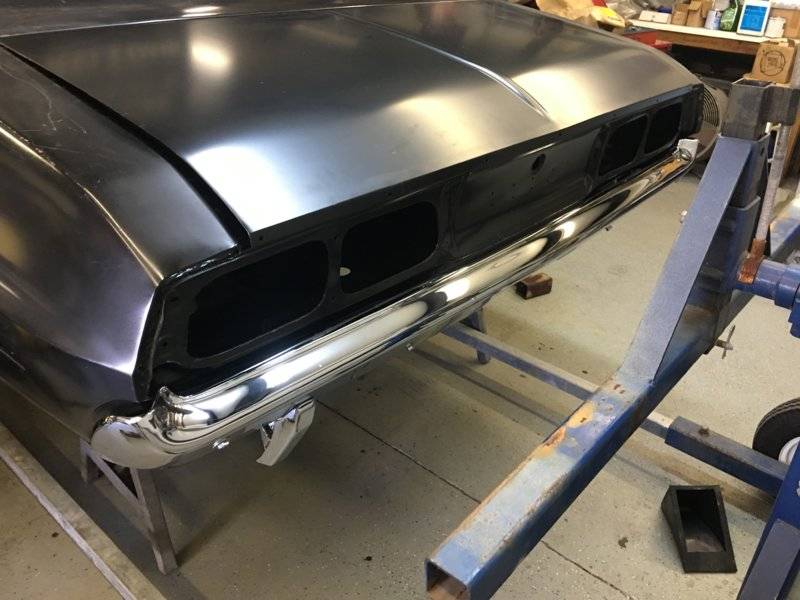

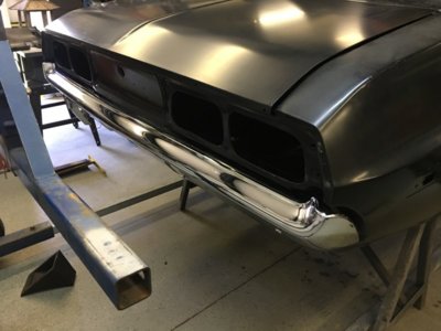

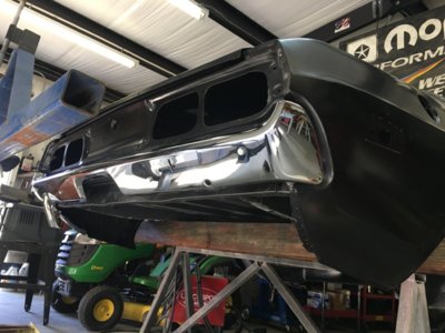

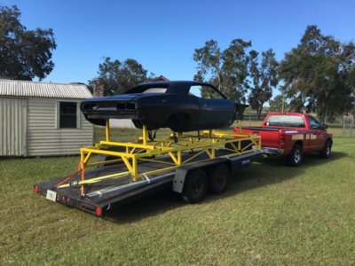

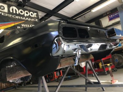

The car is off the frame rail jig and I test fit the rear bumper. Everything is lining up perfect.
Now I have the car on the rotisserie.

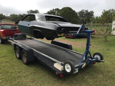

The frame rail jig is now at Todd’s Body shop. Since I left it at Todd’s he has used it to replace some sheet metal on a 1970 Challenger. The report he gave me is the jig has worked out great and all of the panels have lined up perfect on the 70 Challenger.
That car is now also on a rotisserie.
I’m currently building up a new set of supports to fit the 68-70 B Body Mopars.
I hope that I have them done in a week or so. Then we will try them out on the next car which happens to be a 69 Road Runner 2 door post car.

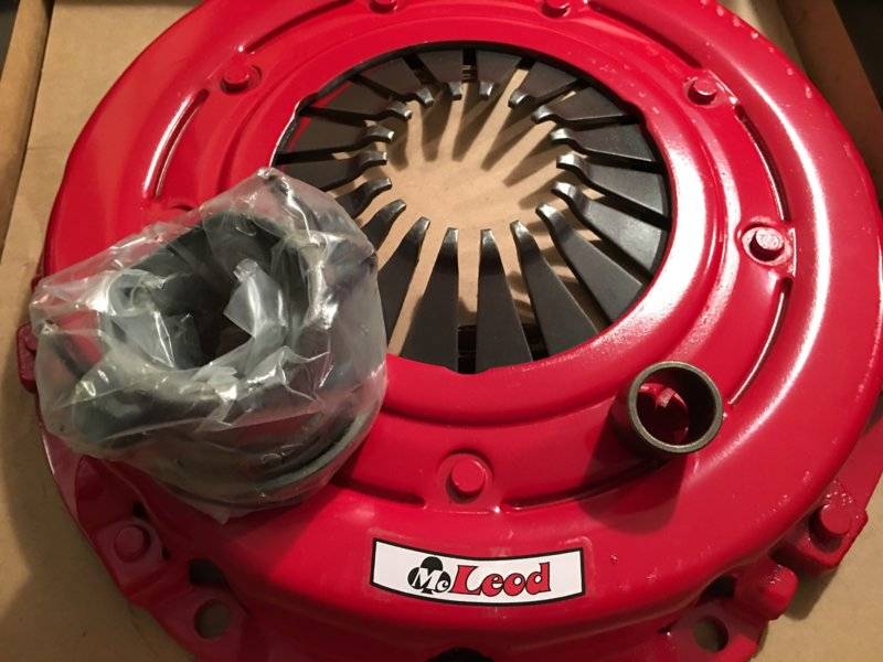

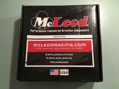

I went with a McLeod clutch and pressure plate assembly. It’s supposed to be rated at 500 HP and has a metallic ceramic disc. I was expecting a Borg and Beck pressure plate and got a little surprise when I opened the box.
This is supposed to be easier to drive on the street with a reduced pedal pressure. It’s made in the USA. It came with a new throw out bearing and bronze pilot bushing. I have a roller bearing setup to try in place of the bronze bushing. There’s also a plastic alignment tool.

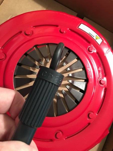

I kept and old 23 spline input shaft for this very reason. Plastic alignment tools often leave a lot to be desired.

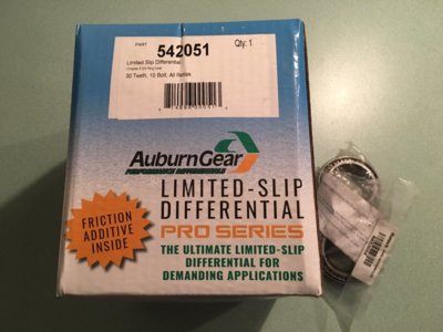

I ordered a sure grip assembly for the 8 3/4 carrier. This one made by Auburn Gear is supposed to be a good one for street use. It’s also made here in the USA.
Since the Challenger is going to have a warmed up 440 under the hood, I was concerned that the center chunk would be the weakest link. I’m not going to be drag racing the car, and chances are the tires will break loose before I break parts in the event my right foot gets heavy and my left foot “accidentally” slipped off the clutch pedal.
Hey...... things happen.

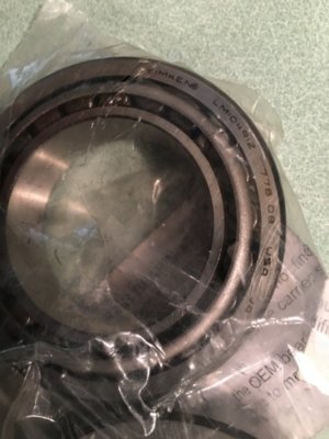

I ordered a set of Timken bearings for the car new Auburn carrier. It requires a different set of bearings from what may have been included with the installation bearings setup.
If it turns out that they’re included I’ll keep the extra set for the next 8 3/4 build.
I’m happy to report that the bearings are also made in the USA.

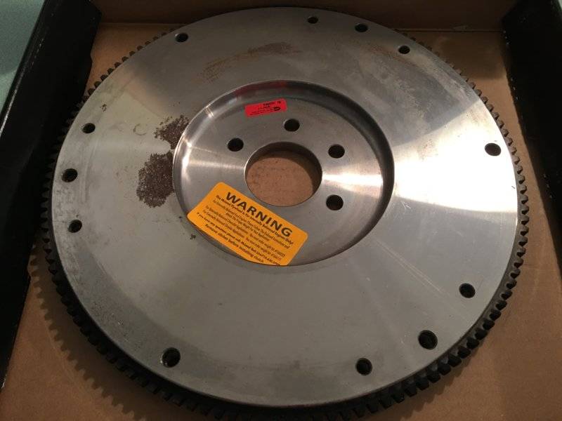

On a brighter note, more stuff for the Challenger arrived !!!! I ordered a McLeod billet steel flywheel. This one has 130 teeth, weighs 30 pounds and is for an internal balance Mopar. It's also made in the USA.
Here's the part number in case you're interested.
My flywheel arrived with a little surface rust on it. No biggie. This should clear up once the clutch engages a few times. I'll probably remove the surface rust before this flywheel gets installed.
It's SFI approved.
The back side has a place to add weights, should you decide to use this flywheel for a cast crank application. McLeod offers a separate weight kit. The weight attachment bolt holes are located at approximately the 1:30 to 2:00 o'clock position in this photo. There are 4 bolt holes. Unfortunately there's some slight surface rust on the back side of the flywheel too. But hey, it's billet steel and not a cast iron factory part, so I'm stoked !!!

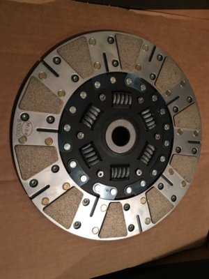

Here's another look at the matching ceramic metallic clutch disc, also from McLeod. It's a 10.5 inch unit and this has 23 splines.
The McLeod pressure plate uses special bolts. They're not included with the clutch / pressure plate kit, so you will have to purchase them separately.

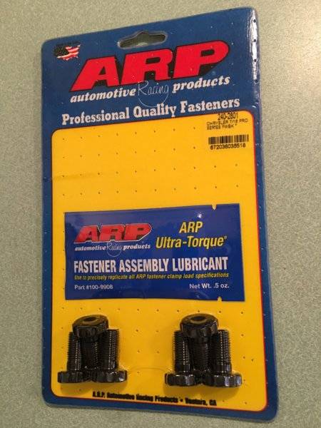

It would be really stupid to use old bolts to attach the flywheel. So I ordered a set that are made by ARP.
This is a set of 6 bolts and they have a 7/16 inch fine thread. The Hemi's used a 1/2 inch bolt. This should be what is needed for a 440. I'll know for sure soon enough. Here's a close up of the part number.

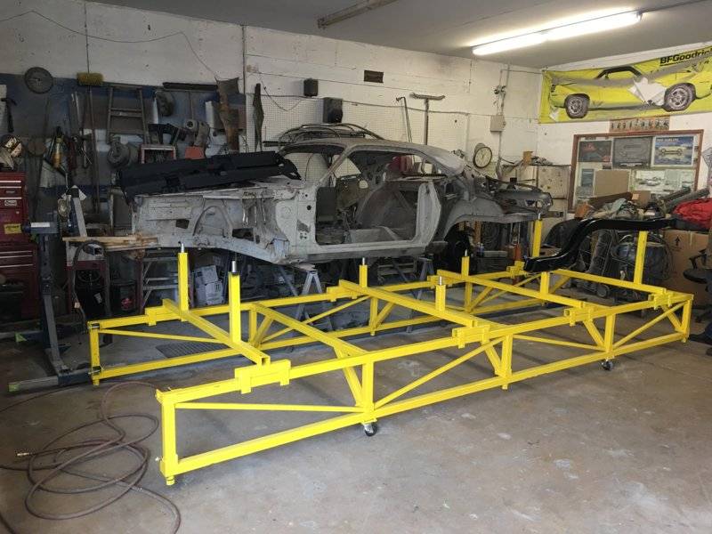

I built a frame rail jig and used it for keeping my Challenger in alignment as we spot welded the new AMD panels on. I’m really stoked about this car. The spot welding is now done and I can rest at night knowing that the car is square and straight. I’ll try to post some pictures of the process. Right now I’m using my phone to post.
I also have made some different stands for the frame rail jig. Now I’m able to build 68-70 B body cars in addition to the 70-74 E body cars by simply swapping the stands.

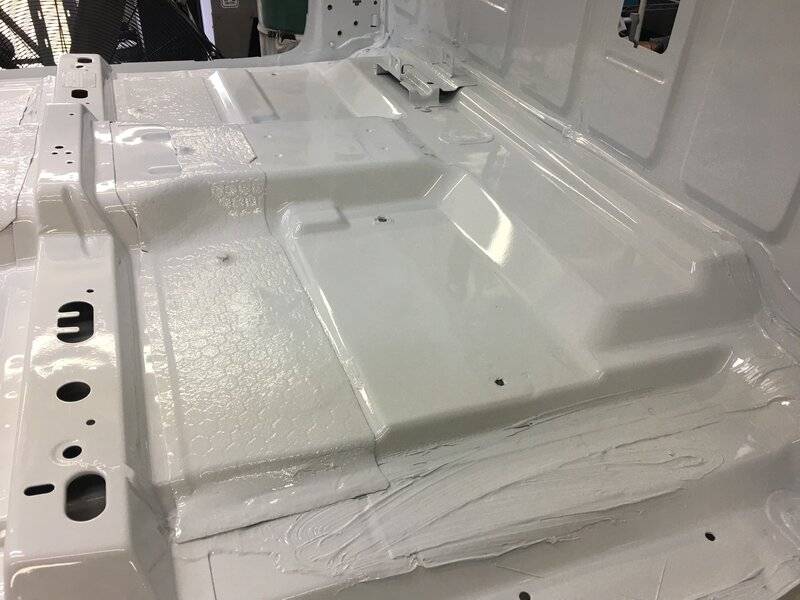

Here's a few pictures of the truck cab. I rolled it over about 45 degrees to show the top.
The overall look of the cab is shown here.
The inside looks just as good as the rest of it.

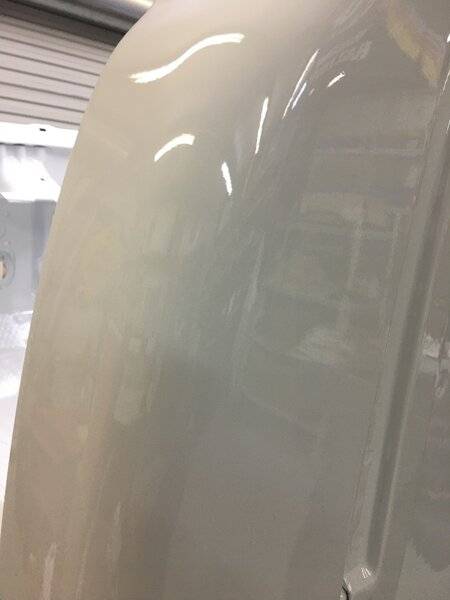

I used 3M cavity wax to help protect it from rust in the future. Here's a close up of the paint. Please keep in mind this has not been buffed out. It's the way it flowed out. I'm very happy with the results. IMG_1716.JPG
