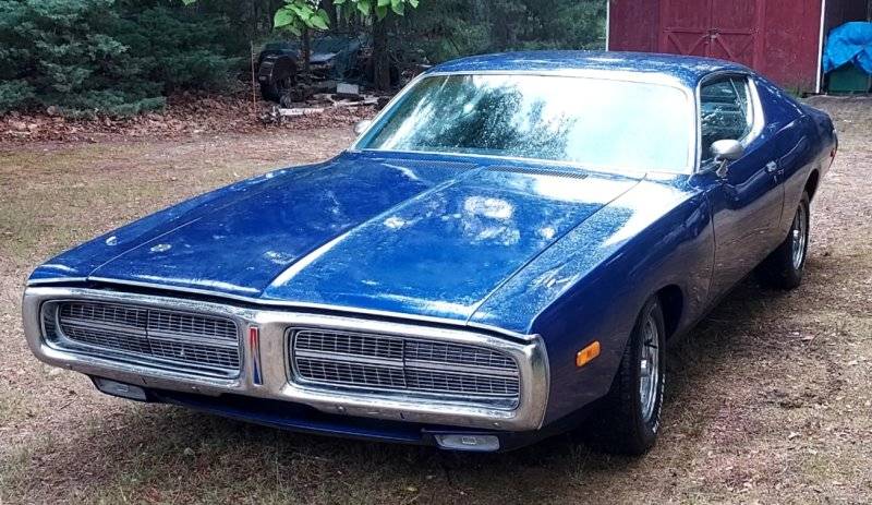

71 Runner followed me home

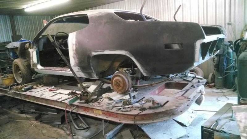

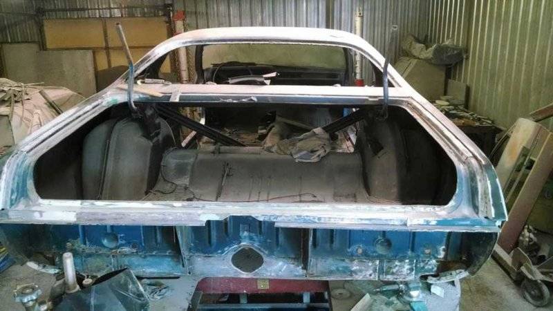

Waved goodbye to it this morning. Off she goes to get new quarter panels put on and some rust repair around the trunk opening.

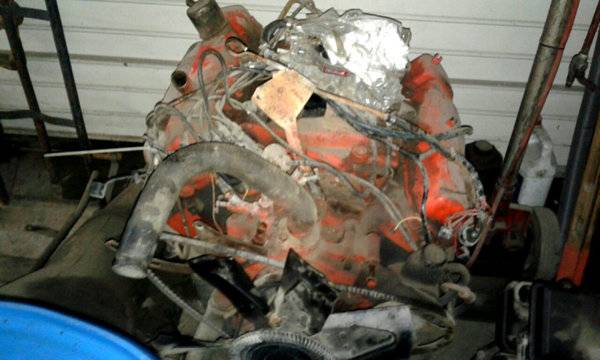

Well, it's not much... but I squeezed in about 20 minutes between errands and other projects to start pulling the old motorhome 440 down. Hey, it's a start.

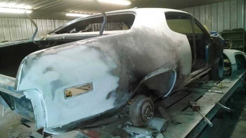

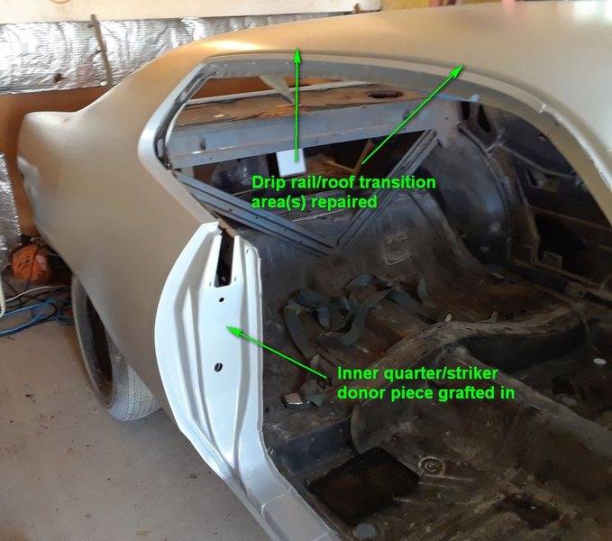

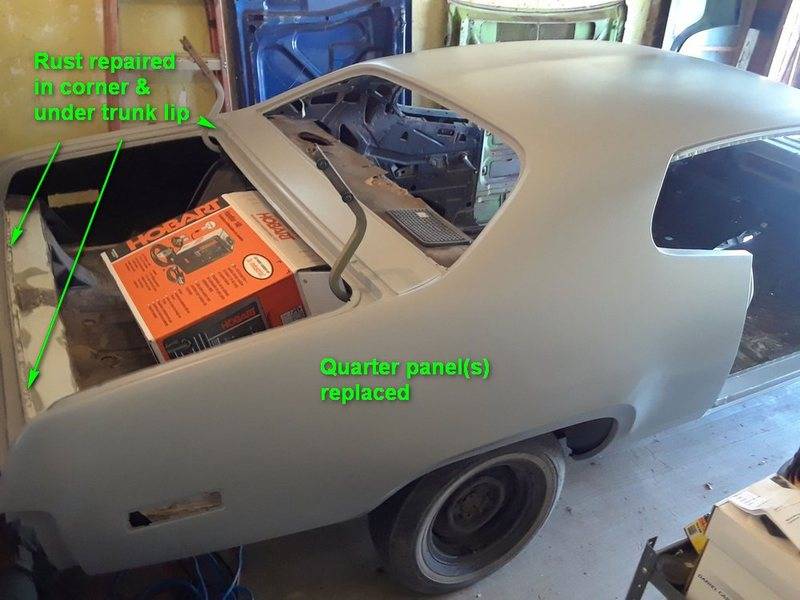

Been a minute, progress has been slow... but there has been progress. New full AMD quarters, and some repair around trunk opening & drip rail areas.

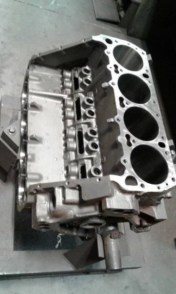

Block has been torn down the rest of the way & the shop's got it cleaned up. Pic is prior to line hone & square deck but that's been done since. 0.030" overbore is next. Yes, we sonic tested it first.

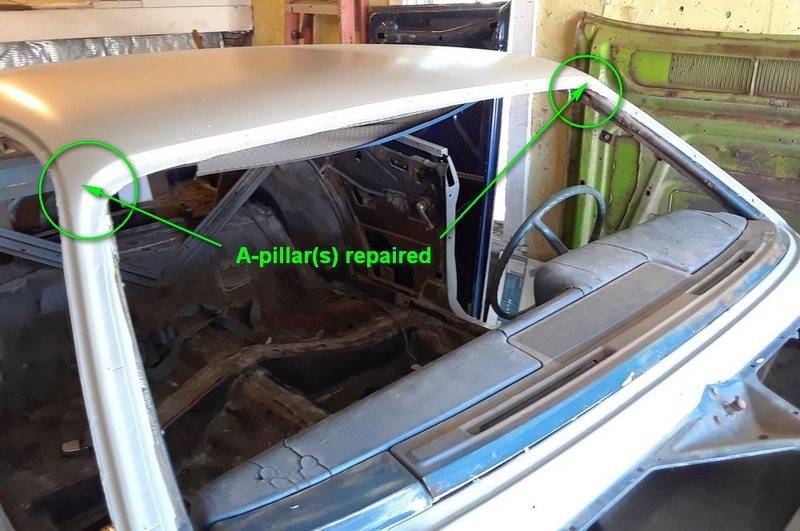

Not much new going on here, just primer... but I got the car back home this past week for a bit to do some grunt work stripping the engine bay down while my body man works on another project. But it feels good to see that the main fuselage is squared up & the heavy lifting on rust repair is done! :)
Still slow going... but the 440 block has now to date been align honed with ARP studs, square decked, bored & finish honed (with torque plates) to 0.030" over. Rotating assembly on the horizon...

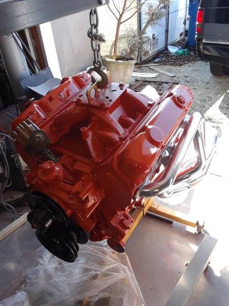

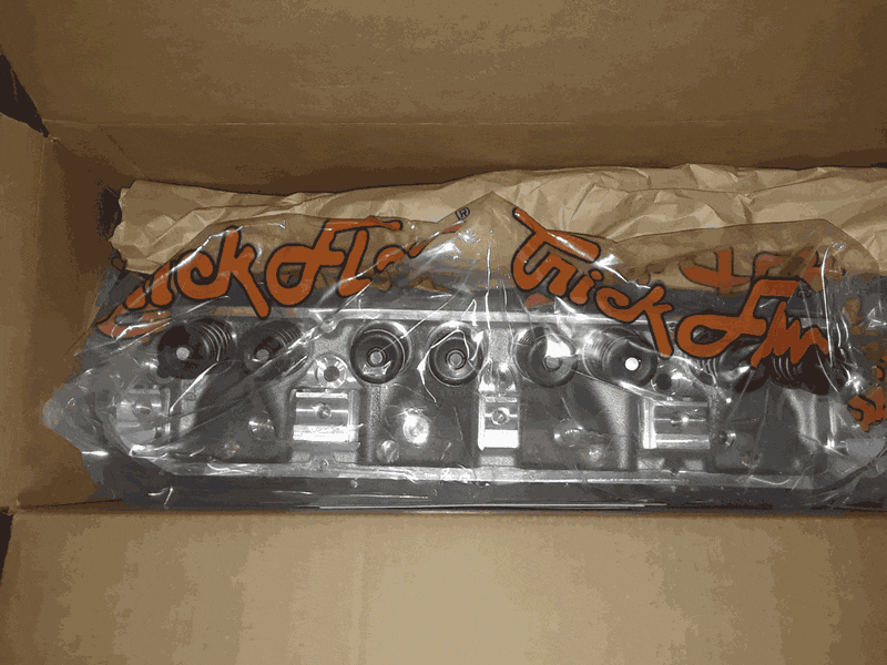

For now, just gathering parts. OOPS truck dropped these off this morning... didn't hurt my enthusiasm for the project one bit!

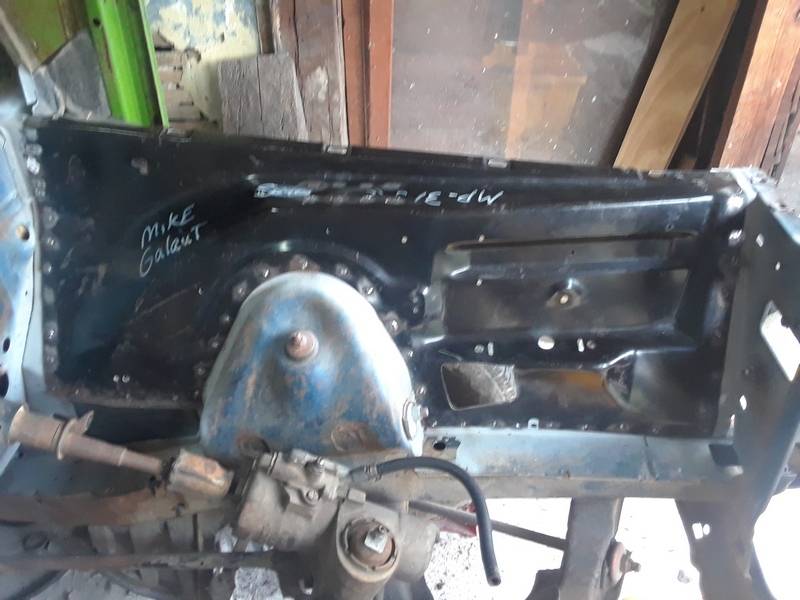

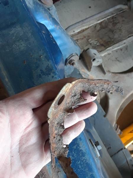

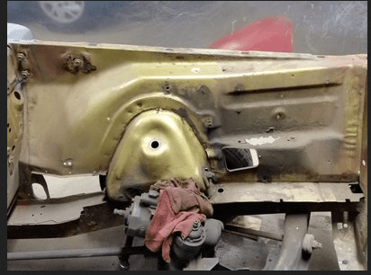

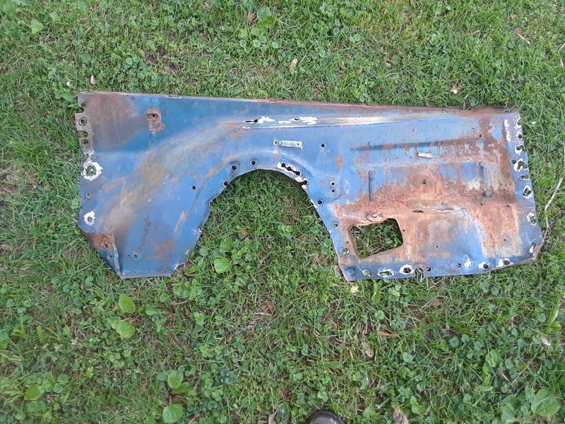

Seemed like the battery tray had seen better days...

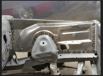

In fact, so had the entire fender apron.
Sick of looking at the rust for the last 2 years, I decided to make this happen:

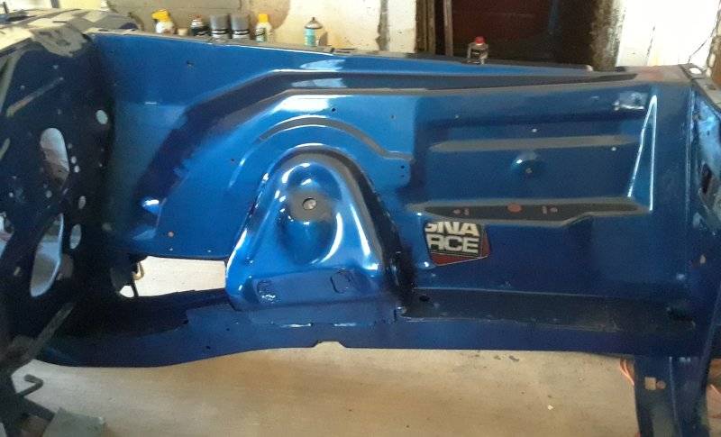

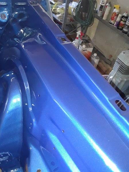

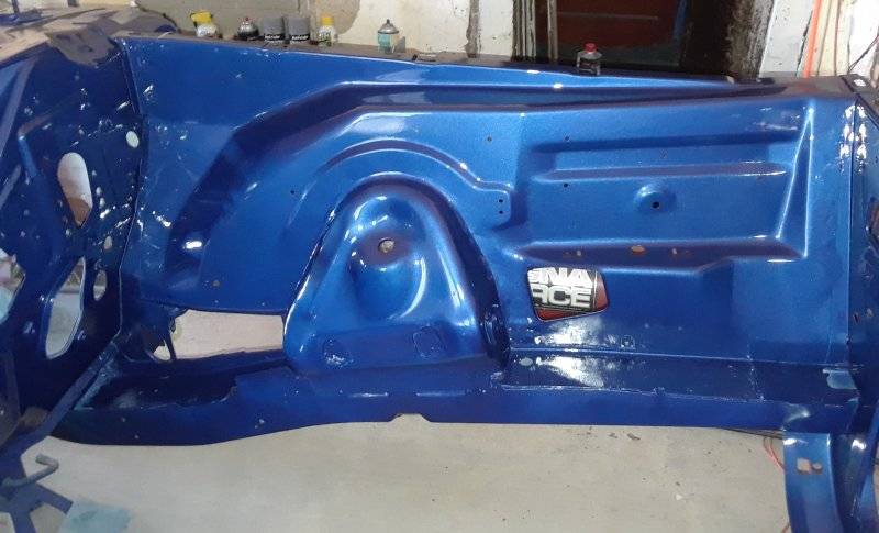

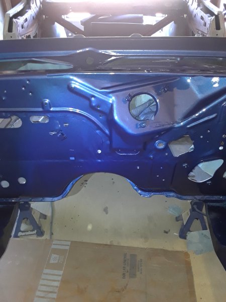

I finally got the engine bay & firewall painted today. My painter buddy made a house call. Lots left to do still but now I can put the K-member & engine back in! Stuck with the original GB7 Evening Blue.

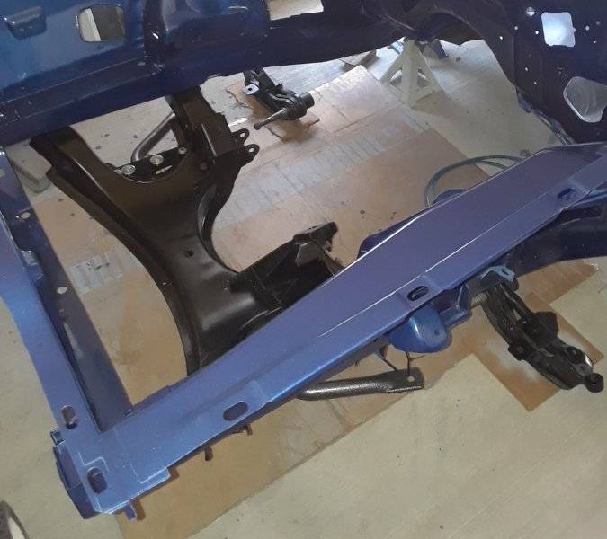

After I get the engine/trans & k-member/suspension in (and probably rebuild the steering column), I'll go back to working the panels with an eye to getting the inner/under sides done & the car jambed after winter. I'm doing the basic grunt work -- stripping, cutting, welding, grinding & my painter buddy is doing the more skillful stuff.

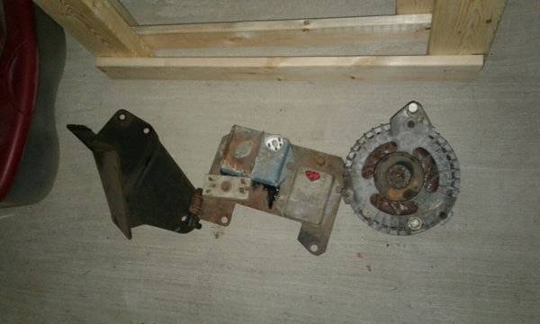

I have a lot of parts on hand, still need to get fuel lines, brake lines & master cylinder, alternator etc. Just ordered upholstery so I didn't get stuck on a 6 month or longer backorder. Have to rebuild sure grip & swap gears. Need to get an X or H pipe.
