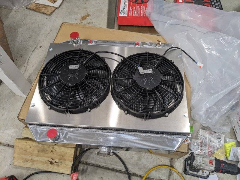

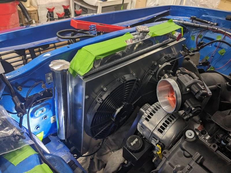

I was able put put shroud on my radiator and mount my fans. The shroud left a large gap top and bottom so I found some 1" expanding foam tape to seal it.

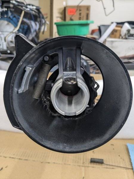

I also got started tearing my column apart to convert to a floor shift. I didn't realize how crummy this thing looks.

I'm reading about the lockout tube and whether it should go back in. I don't mind the wheel lock feature, but I don't need the linkage connection at the bottom anymore. There's also not a tapped hole for the allen set screw in the (middle?) collar. I've watched the cuda Cody videos, but that's for a 70 E-body.
I cannot really comment on this aspect and that column without taking it apart myself. I did take one non-tilt 71+ column apart somewhat but it was already pretty disassembled.

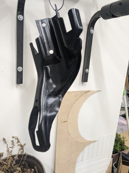

I got all my steering column parts painted and should be good for reassembly tomorrow assuming I'm not missing anything.
I also got my radiator and overflow reservoir mounted.

I got the steering column all back together. I used an old throttle spring to make the key return spring. I think it will work. I was pretty happy with how it all went together. Not to difficult or time consuming. The cuda Cody videos really helped. Now just gotta cut the hex rod to length and install the U-joints.

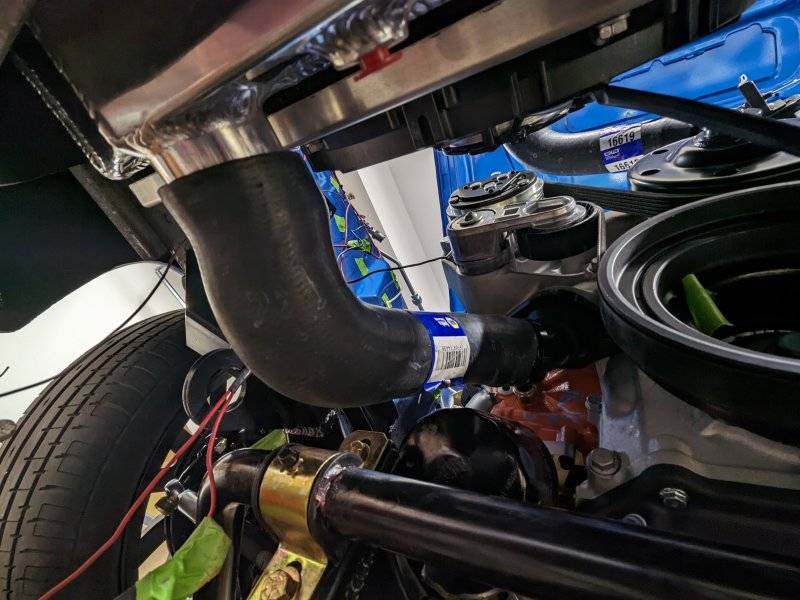

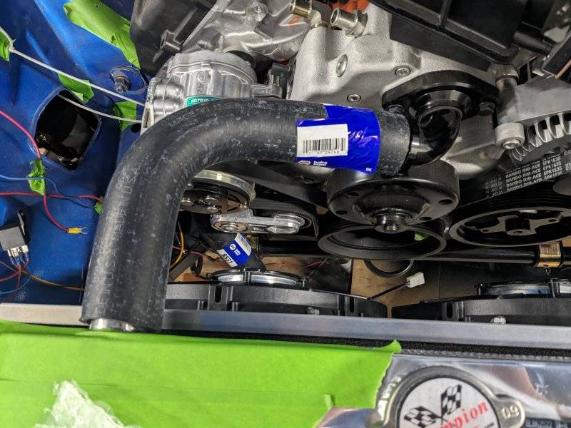

I've got a few things in motion, but I picked up some radiator hoses tonight. Both needed a little trimming, but they both work. One of the pluses of the Holley mid mount system is the swivel hose connections.
Top: NAPA 16619 (with reducer to the radiator)
Bottom: NAPA 9531
Bottom: NAPA 9531

Thats awesome, I might have to buy one of the bottom hoses, the one I have fits (after trimming) but not super great.
