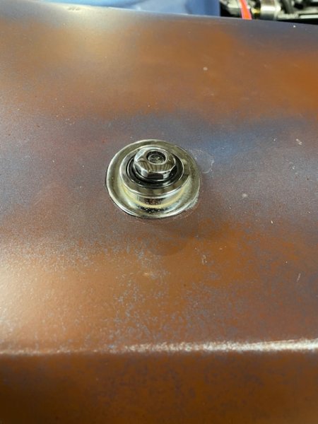

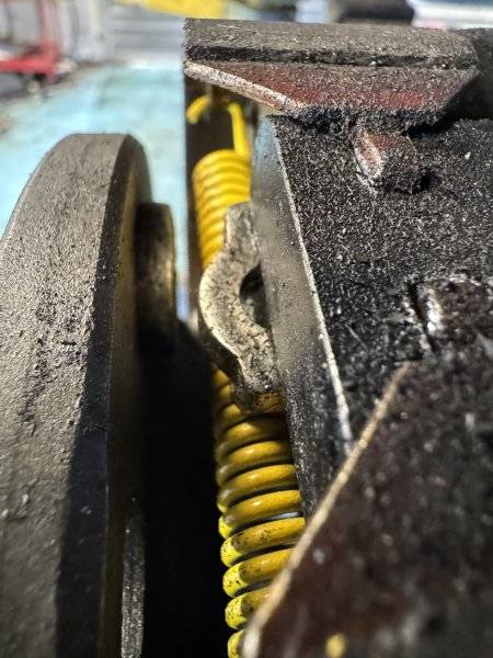

The original studs heads are close to .2 of an inch
Nice picture, good to see the original clearance. That might as well be a foot compared to what I have. I'm estimating 1/32" for mine. Maybe a 1/16th if I'm lucky. That's after the studs have flattened that side of the spring off and I ground down the heads of the studs a bit. Hopefully I'll get some answers tomorrow.

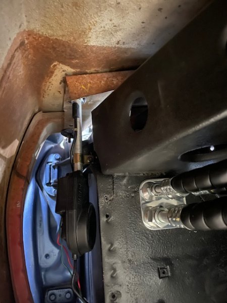

I'm looking to add a powered antenna, but it looks like clearance might be an issue. Has anyone added one on 3rd gen?

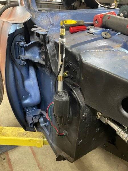

Yes I did on my Charger. First off you wanted a semi auto antenna, not a full auto. The reason why is because the full auto will extend to full length as soon as you turn on the radio. With a semi auto you have to use a switch (comes with it) but you can extend the mast as much or as little as you like.
It fits into the fender without issue but you really need to brace the bottom of the antenna because they will move around and become loose.
Here are pics of mine, notice in the one pic there are the bezels, there is also a aluminum tube cut at an angle, this is something I made to get the antenna to come up straight.
I hadn't even heard of semi auto antennas. The pics are really helpful, thanks. Sure would be easier with the fender off, but it shouldn't be too bad. I may not actually mind having the antenna go up all the way with the radio. I'll have to see if it goes up when the head unit powers on, or just when using AM/FM. If it's up all the time, I can create my own "on" signal and install a switch to have it come up when I want similar to the semi auto.

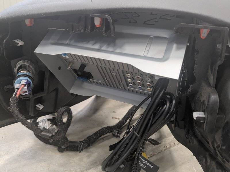

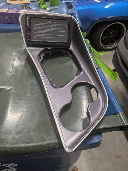

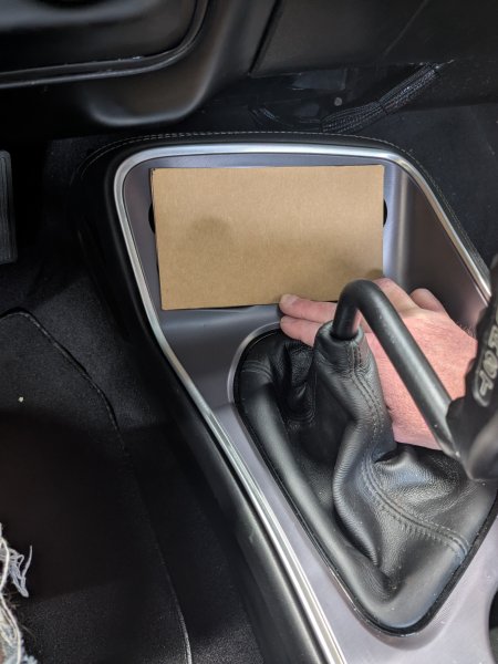

I got my stereo today so I started the process of figuring out how to get it installed. I got the cover plate cut. It's a pretty good fit. The existing opening is slightly larger than the bezel. I may get a piece of laser cut plastic to extend the bezel area. I'll also be doing a wrap.

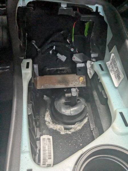

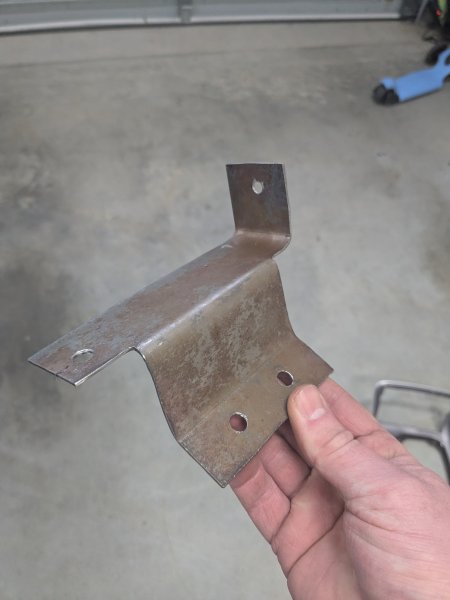

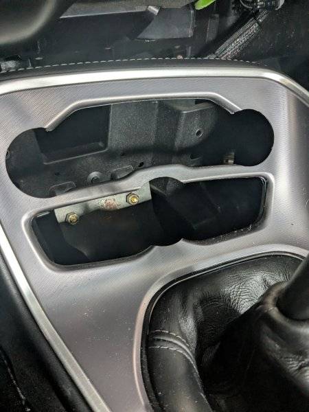

Today I got the console cut up to accept the stereo. I also made a new mounting bracket for the front since the old one had to go.
Don't worry, I put a coat of primer on the bracket.

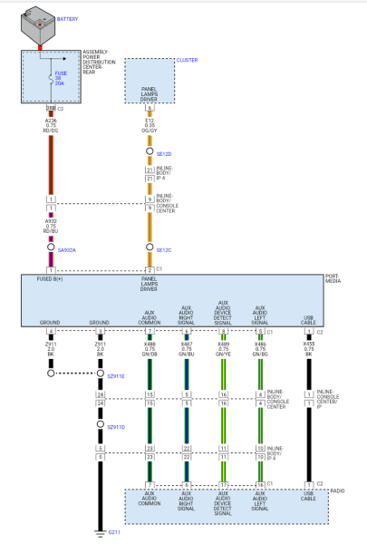

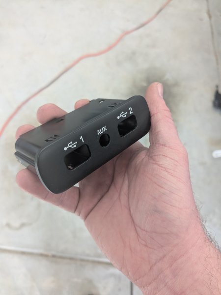

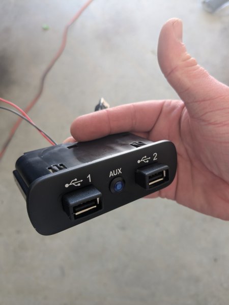

Tomorrow is wiring day. The goal is to have all the outlets and ports on the center console work. I sorted all the wires on the harness. Only one I'm a little confused on is one of the USB ports has 4 extra wires. One is power, the other illumination and the two black ones I'm assuming are grounds. I'm about 95% confident on the black wires. I'll have to be careful wiring up the USB data wires to make sure I don't get them backwards.
I found a wiring diagram (or at least one that's close enough) that confirms the black wires are grounds.
I tried to get the USB ports working but struck out. Alternatively I gutted the module and put in my own USB ports with conventional plugs. I also repurposed the aux port for a cubby light.

I got the antenna installed. I think I modified 3 different pieces to make it work. It sucked, but it's done. I also wrapped the chrome bezel on top to add some black. The antenna doesn't go up with the radio on right now, but I heard it working when I was troubleshooting the radio, so I'll have to look into it.

I did some troubleshooting today. The antenna only works if I unplug it and plug it back in. Not sure what's going on there. My fuse blowing i believe was a bad power connection on the terminal block. Not sure how it was shorting, but after swapping it out, no problems. My bracket wasn't accessible with the stereo in, so I had to split into two pieces. It's much better now
I got everything put back together and I'm really happy with the look.

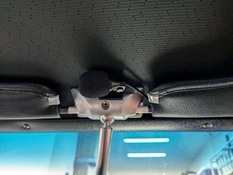

I mounted the mic up on the visor bracket. Seems to work pretty good.

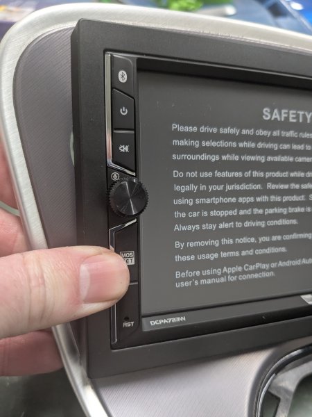

My remaining issue is that the stereo resets to factory default every time I turn it off. I'm not sure why that's happening since it has a battery connection on it. That's a problem for another day.
Sounds like the memory wire is not connected to permanent battery power (Via a
Fuse) normally red or yellow
I agree that's what it sounds like, but I checked to make sure it was connected correctly. I have a power outlet in the console cubby that should have full time power. I'll check that tomorrow to see if that works since it's on the same circuit.
