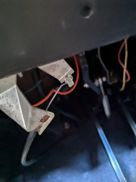

It has also come to my attention that there should be a clip to hold the mixing valve cable to the lever arm on the HVAC arm. I'm not one of those purist, so any ideas to make it stay on since I don't have it?

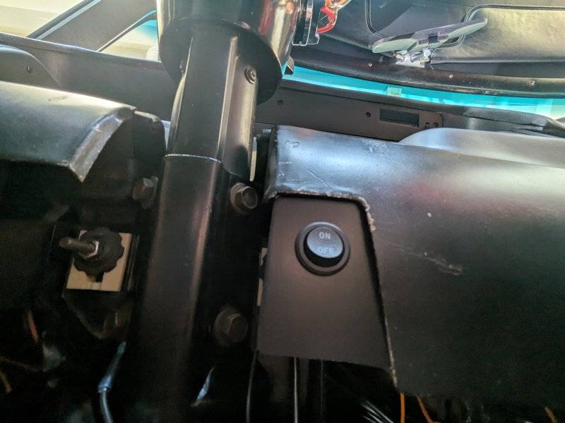

I bought a cheap switch for my antenna. Now when the antenna fails to deploy, I toggle the switch on and off and it works. I can also lower the antenna when I'm only using maps or streaming from my phone and don't need it.

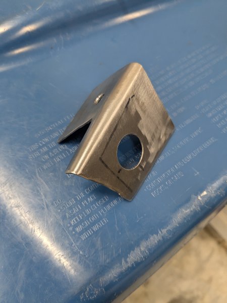

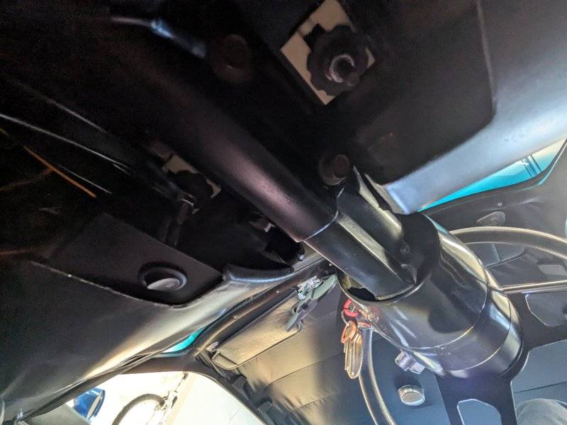

I found a spot under the dash next to the steering column to hide it. I fabbed up a bracket. I've got paint on it drying now. I'll post some final install pictures when I'm done.
I got everything put together on the switch. It's in a nice spot where I can reach it, but not see it.

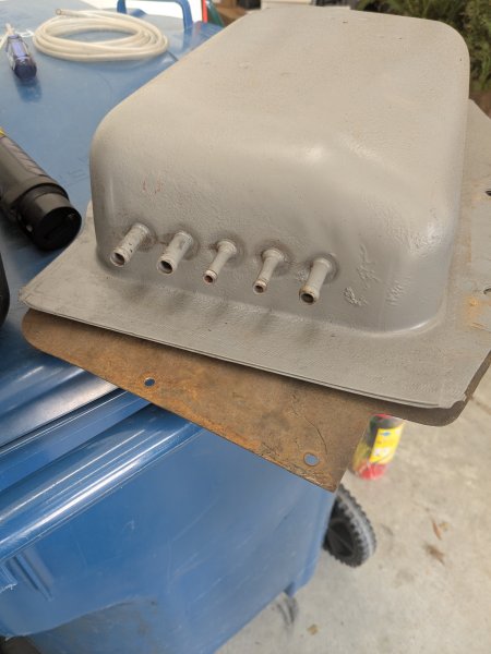

I had a new problem later in the day though. My tank vent lines were puking fuel. As soon as I popped the fuel cap it stopped, so the tank had become pressurized. I ran the original vapor tank in the rear driver fender, but left off the line that originally ran back to the carb. That functioned as my vent and allowed vapor that condensed to drain back to the tank. This is the first time it's done this since the build and it's been over 1500 miles. It's was the same before the build and no problems then either. I checked everything and all seemed well, but it obviously wasn't venting. I ended up taking the vapor tank out and just tying up my lines as high as possible. If that works, I'll throw a breather on it and maybe sell the tank. Oddly enough the drain appears to be the 2nd from the left, but none of them are flush to the bottom. I wish I could open it up and take a look.
