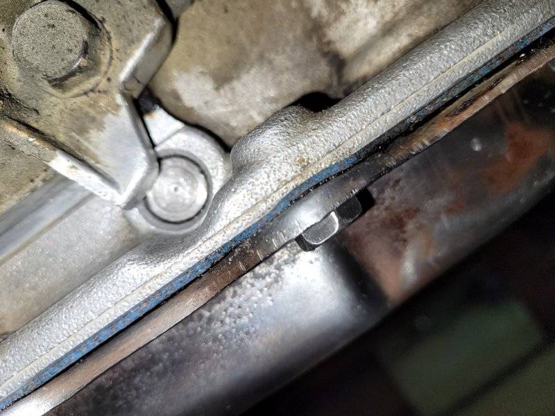

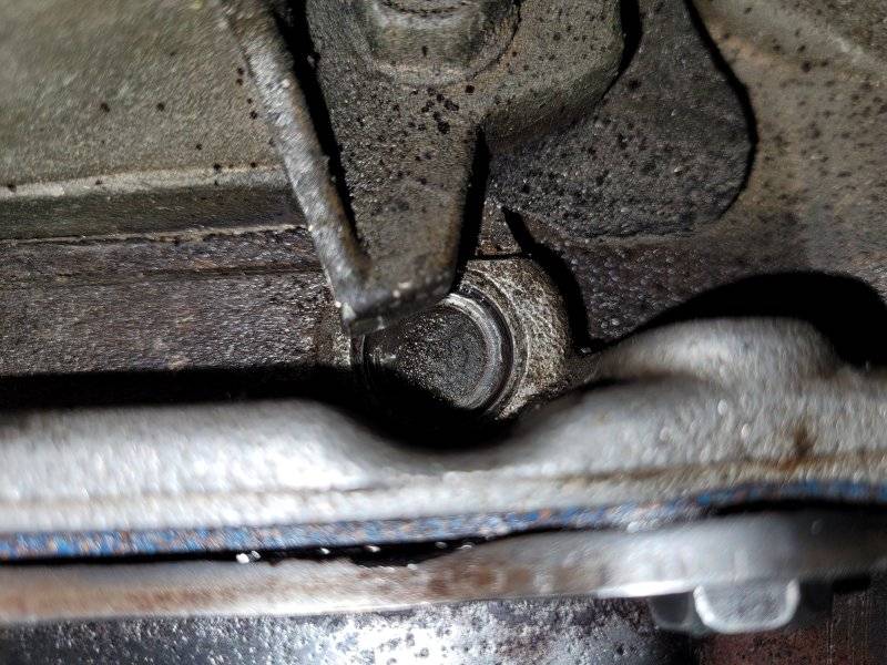

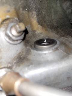

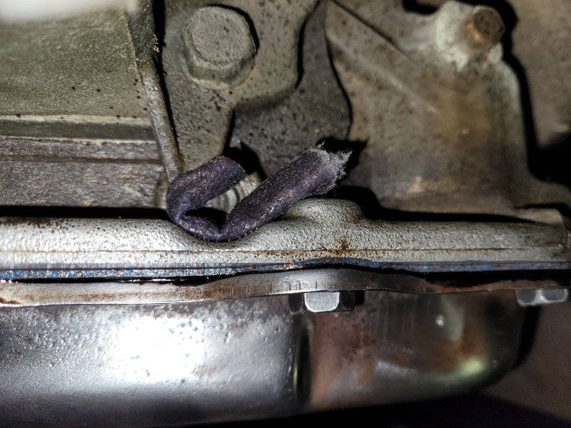

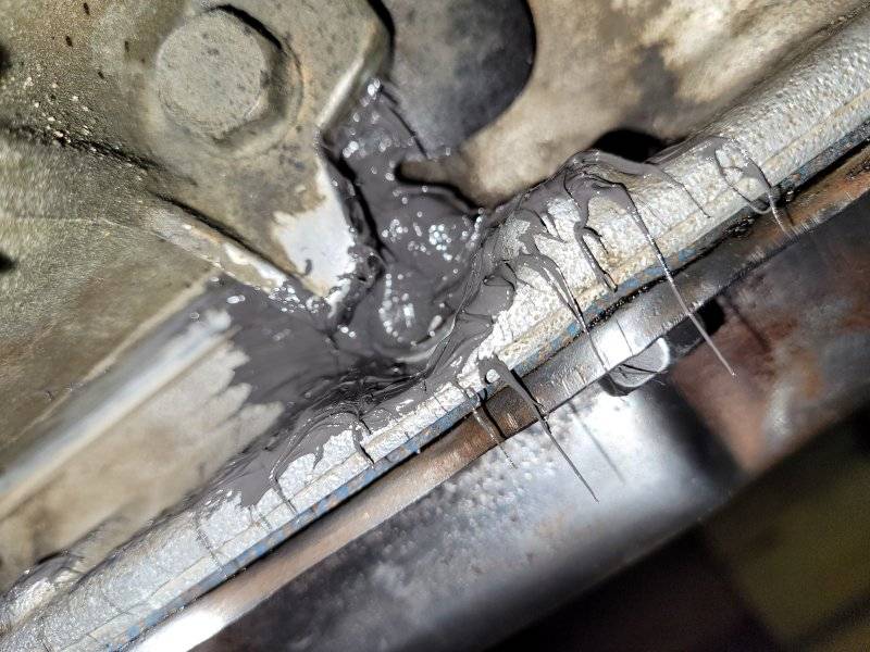

Shifter shaft seal, throttle shaft seal would be my first look. Then the front band adjuster nut/stud (to the left of the shifter/throttle shaft) to see if those are leaking. Then when you have all those sealed.. like I did... you find out it's actually the rear servo lever pin that is leaking out the back of the case.. then all the way around the pan to drip off the front. I wasn't dropping my pan again to change the O ring, so cleaned and sealed it with some PRC fuel tank sealer.
