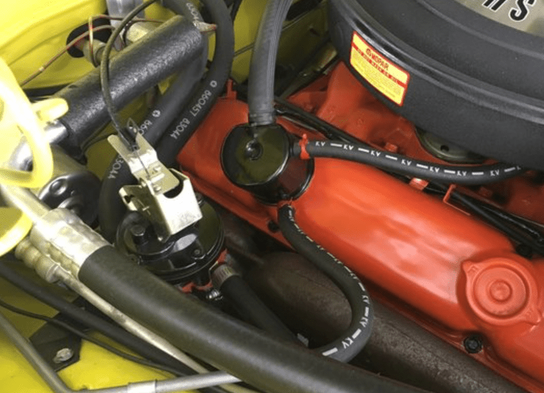

My73 was stripped for racing years ago by the former owner. I found they left the fuel tank vent connected at the tank but found it venting 1/2 way down the pasenger side right next to the hot exhaust pipes. I found an early 90's Jeep Wrangler canister at the bone yard and hooked it up with hoses with filters in them to prevent any charcoal from getting sucked into the engine. Works quite well and was very cheap to do. See attached:
The item in the photo you mention is the heater control valve.
Ahh... you are correct sir. It was hard to tell from that picture. I'll consult my friendly neighborhood FSM for a better overview of the venting system.

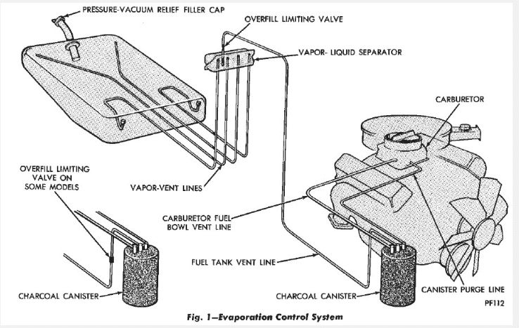

Is there some reason why they have FOUR vent lines? My 68 got away with two. Seems a little excessive.
Here's the answer to your question Hilljack68...
I got it from this website.
I'm guessing this should be identical to all B-Bodies of this era? Is this dependant on engine size or is this standard along all V8's. I'm just about ready to start putting my fuel tank back in the car and figuring this out myself. If anyone has a picture of an original canister with its original lines and clamps hooked to it, I would love to see it. I have my canister but I'm missing 2 of the lines to it, looks like the ones to the carb.
1973 only.
You just have to know what the different lines do on the canister top.
There's also a valve on the intake that opens and closes depending on heat of engine temp.
There is some merit to this system, as it can boost MPG.
