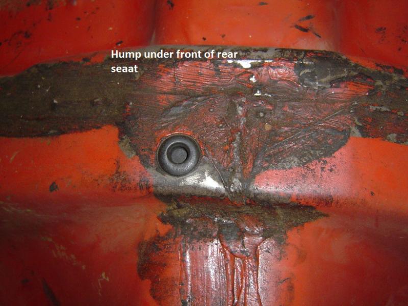

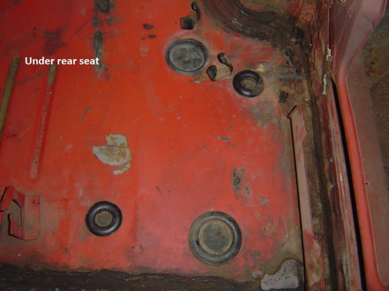

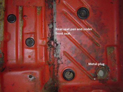

I looked in my body service manual, and did not find anything regarding size and location of body plugs. With that said, its pretty easy to figure out where they go, the only two that may not be in your kit are the two metal ones that are in the rear seat floor pan, one on each side and are sealed with body sealant, and the one rubber one that goes on the center of the hump under the front of the rear seat. If you have those, the rest are pretty easy.

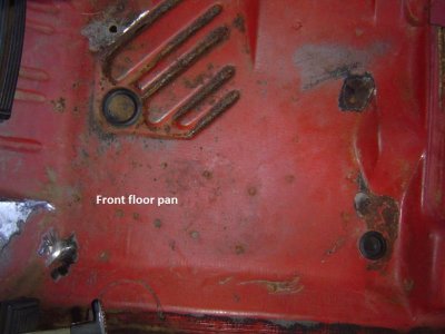

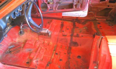

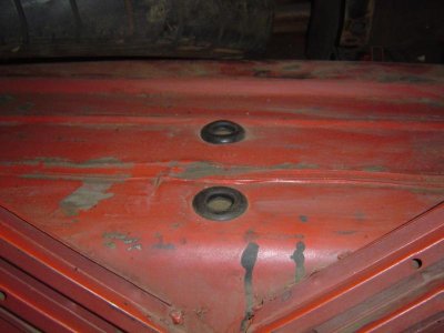

Found a few pictures of the interior plugs, don't have any of the trunk, but hope these help you out.
