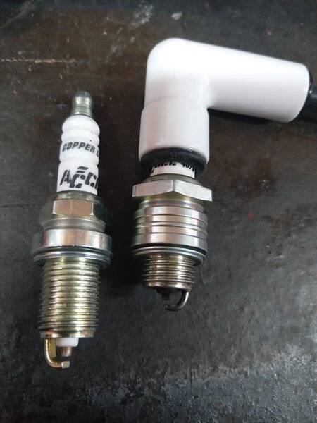

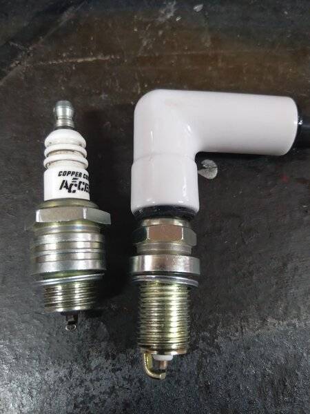

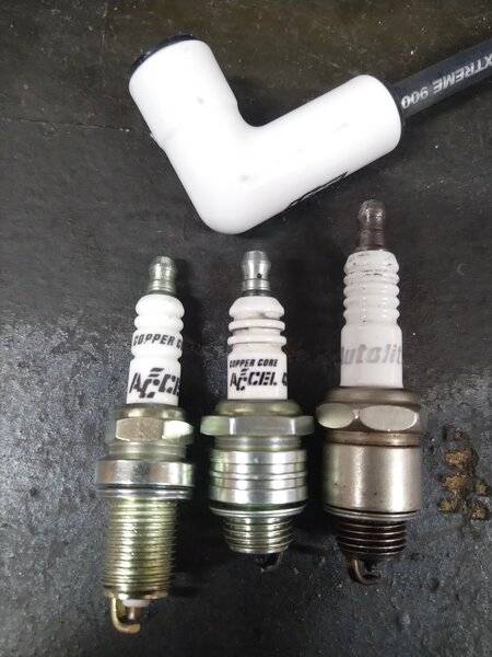

Have anyone used these wires? I bought them for use with headers, but it was waisted money at this point. Wireboots are much to tight for spark plugs with normal size ceramic insulator. I did try putting the wireboots on different plugs.
The only plug they would fit, were the "slim" type shorty plugs with extended reach (witch do not fit my iron heads). I posted some pictures that hopefully visualize the issue.
Maybe i can use them in the future, if i put Trick Flow Powerports on my 440. Doesn't aluminum heads require plugs with extended reach? If so, i can then use the plugs that fit the ceramic wireboots.
Does anyone have recommendations for other "headersfriendly" plugwires that i can use?

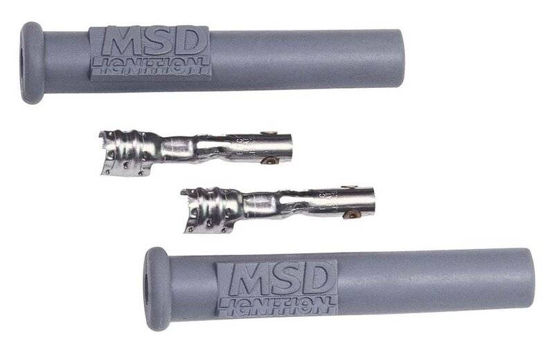

I have found that the 90 degree plug boots just don't cut it with BB headers. I like the MSD boots that are made to "customize". Whatever position you bend them into, they stay.
