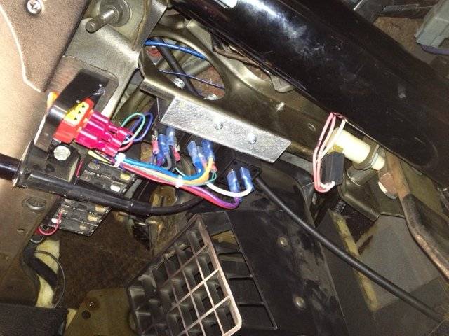

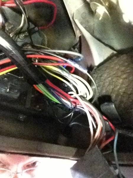

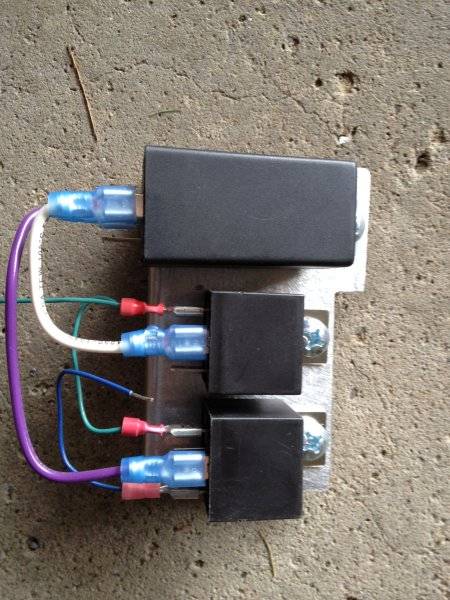

He ya go..... I did it to my 66 Charger. I planned it in a way that I thought would be minimally invasive to the original wiring in the car. Attached is schematic and detailed written description of how I did it. Also are pix of where I mounted the flasher and relays under the dash. I would guess that your wiring colors are likely different, but this is quite a straight forward modification, works with key off and still allows turn signals & brake lights to work, so useable while driving. It alternately flashes between rear tail lamps and front parking lamps which draws less battery current than flashing all at once. I used what's called a wig-wag flasher that provides alternating closures. Flashers are activated by a illuminated switch mounted to lip of underside of dash. You should be able to get everything electrical you need at any auto parts store. Relays mounted to a piece of aluminum angle. In line splice crimps to join new to old. This should be doable for any Mopar that did not come with 4 way flashers. If you don't have a shop manual or wiring schematic for your 62 fury, get one.. it will be most helpful.

Nice clean wiring!

Thank you so much. The older you get the more you worry about stuff like this. This is very helpful.
