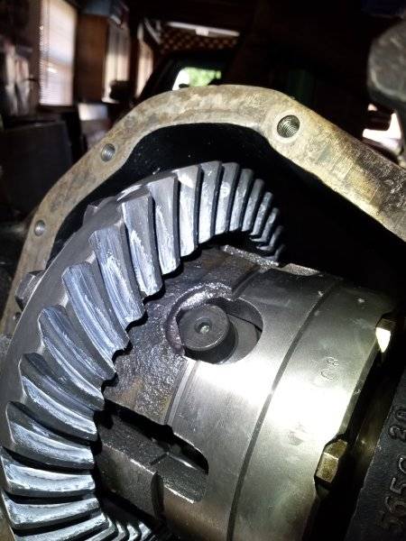

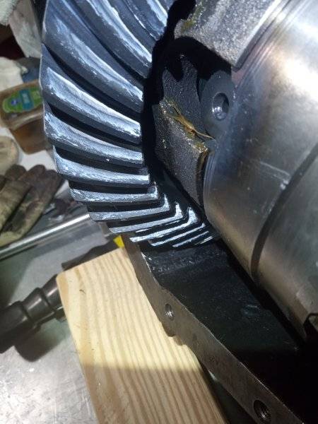

The coast side looks good? but the drive side looks a bit too deep?? When I first started setting up gears I bought a pinion depth tool/indicator and even when I got the depth set right according to the setting tool, the pattern just never looked right to me. But when I stuck a newly set up 3rd member into my car, it was quiet on accel and decel and stayed quiet 100's of miles later. I did that to 3 others before I trusted the set up tool and from then on I never bothered looking at the pattern again. This set of gears isn't marked with a + or - number so I'm having to use the mounting distance method to get my starting point. I've done one other using the MD method and it was good even though the pattern still didn't look right on it.....at least not to me. Anyways, this is on a Dana 60 with slip fit preload and .010 backlash.

Motive gear shows the pattern of the 'competition' in that chart and that is looking like what I have now. Kinda thinking I may move the pinion away .005 maybe. I've been setting up gears since the 80's but just relied on my setup tool so never really learned to read the pattern. This rear is going into a car with around 500 hp.....440 so it should be producing some torque too and I'd rather be a little deep than too shallow.
