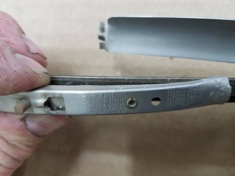

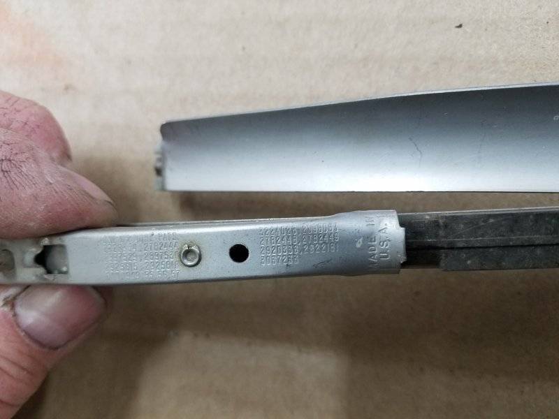

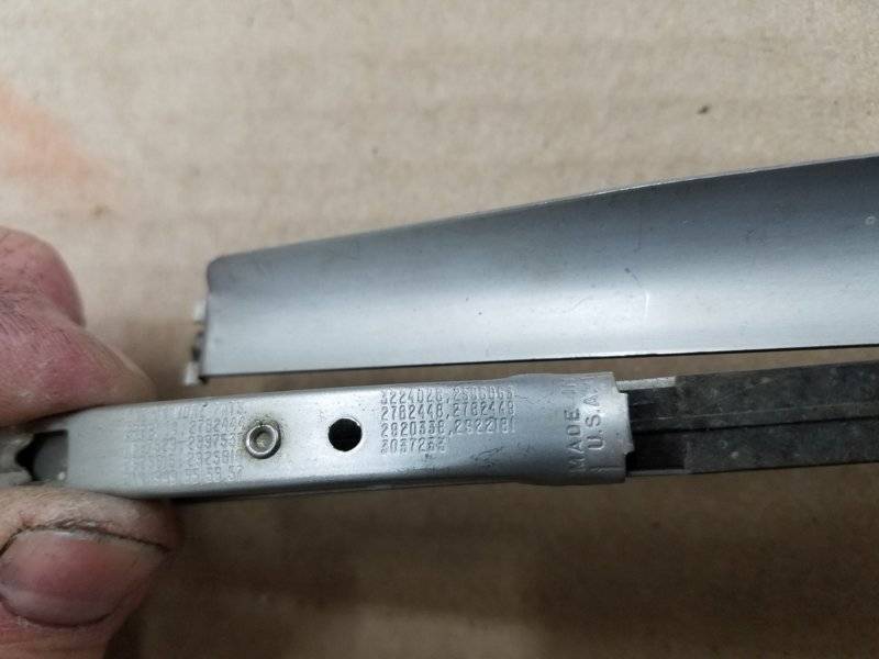

Anybody know windshield wiper arms?
Here is a bunch of patent numbers on the blade assembly if that can help anyone solve the mystery.
Correction, upon closer examination of the parts book, there were 3 different wiper arms available for the '69 Coronet coupe and hardtop models.
The generic - 2822999
ANCO type - 2889860-1
TRICO type - 2983086-7
So if anyone can show what these three variations look like, that may clear up the whole issue.

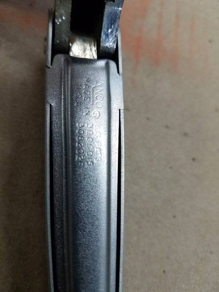

I would say they are the ANCO type as you can see clearly see in JOEL pics
There are some kind of numbers (part or patent) on the underside of the arm (not the blade) right at the wiper pivot shaft. But I can't read them on my car and I'm not taking one off the car to check it. Any on yours?
US PATS 3006015 and 3082026.
