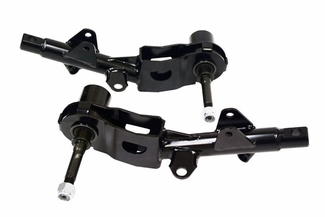

Hey 68 if that question was for me (What car and tires), It's a 1970RR with 2" dropped spindles (from Firm Feel but made by Magnum Force) and Firm Feel Torsion bars, springs with lowered front mounts and stiff shackles and Firm Feel sway bars. I am running 235/60/15 on the front on a 15" by 8" wheel, which fit easily even with the dropped spindles and Wilwoods. I am running 275/60/15 on the back. With 15" x 10" Budnick wheels with a 5" backspace I have plenty of room (more than an inch anyway) between the wheel and the leaf spring but rub just a little on the outside - the tire hits the inside of the rear fender over big bumps.
I'd REALLY like to go to 18" wheels all around but the COST! UGH! I think I can get a 275/45/18 or something like that on all 4 corners, which would be CRAZY sticky. It's really no more tire than I have now in the back, but way more in the front. And you DO NOT want the front of one of these cars sliding in a corner on a track unless you want a wild ride. What usually happens shortly after the front starts to slide is that you decide you want to try to save it (rather than just hitting the brakes and sliding straight off the track). Save it means Stomp on it, which, with 600 ft lbs of torque, is great if you have enough room to Stay on it and on asphalt, otherwise the car goes from understeer to oversteer, hooks up and then spins back the other way and viola, you get to go off the track backwards instead.

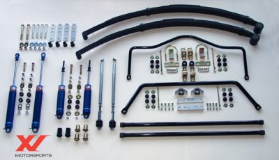

I guess it kind of come down to budget... what you want & like, or even who you trust, for me anyway... Mancini Racing/sells QA1 {formerly Capps Automotive} now offers a tubular K-member for $593.95 {Capps stuff was $1300 years ago for a tubular K Member}, sway bar attachments, tow hook/tie down loops, stock suspension & steering mounts, haven't seen one in person yet, probably ordering one soon... I've done all the tubular stuff before upper & lower control arms, dynamic adj. strut rods & big sway bars front 1-3/8" & 1" rear on a couple of 68 RR's, with stock leaf rear suspension w-sliders, CalTracs, worked out well... I live in the Sierras I like my cars to handle & perform, not really into the Autocross deal, but dabbled a little a decade or so ago, it was fun... Night & day differences between stock & the tubular stuff, especially in adjustability & tune-ability... Seen RMS {Lynx rear suspension} & XV Mostorsports stuff too, never used them thou, seen a few reviews of them that were favorable... I have used the Magnum Force Racing & the old Capps Automotive [COLOR="#0000CD[I]"]{Now owned by QA1}[/I][/COLOR] stuff on several cars, been very happy, there are some rears suspension stuff too, from Ride Tech that worked well too... The newer SPC upper control arms look promising too, adjust on the car, ya gotta like that... look into the bump steer correction too... good luck, not much more I can add...

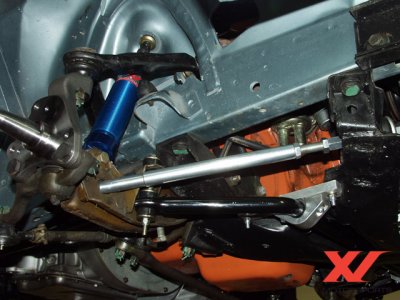

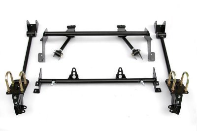

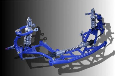

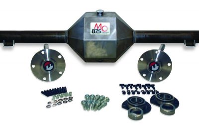

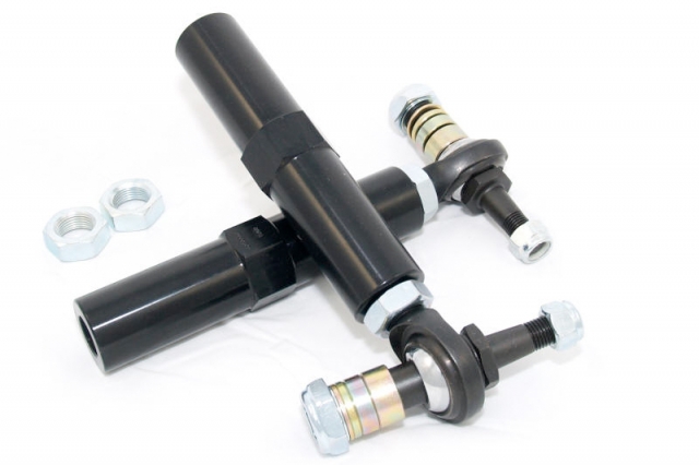

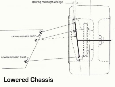

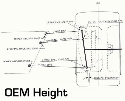

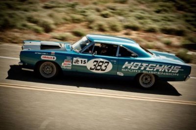

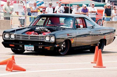

Hotchkis run a 68 RR with relatively good success... among others, hell they were racing them at Riverside back in the day too...LOL...
