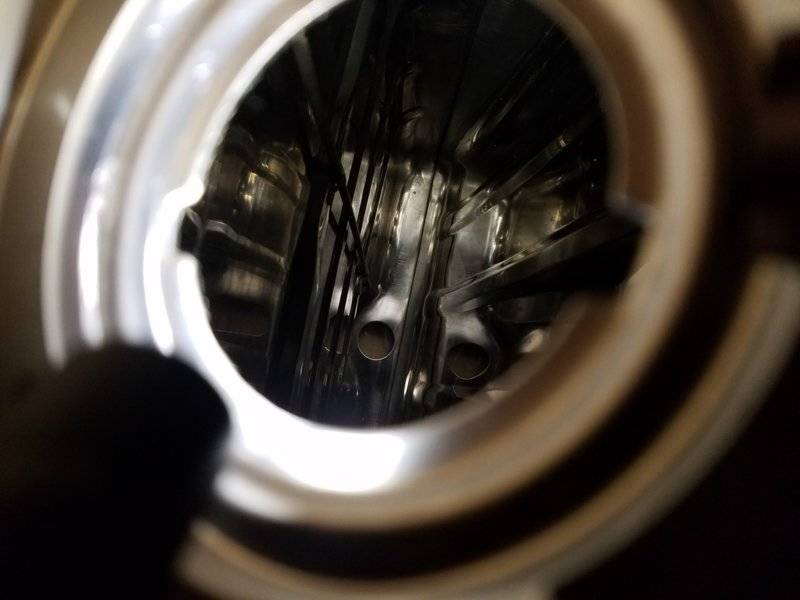

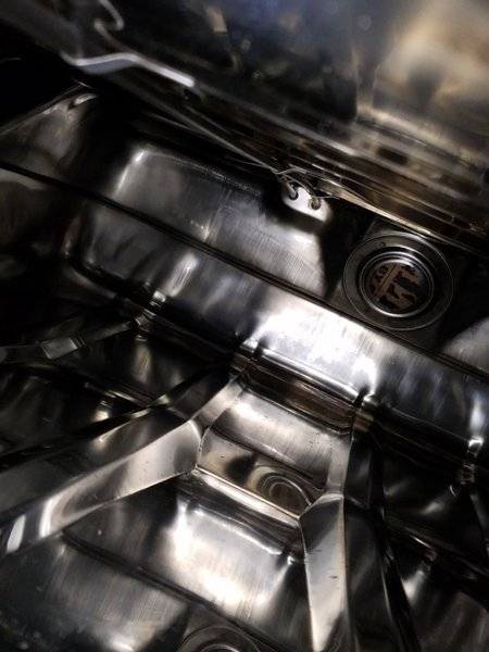

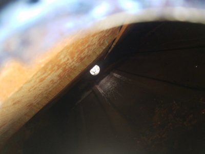

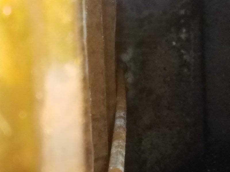

well new tank arrived the results are anti climactic. the new tank and the original tank have the same design and placement. the short "candy cane" ext. vent is on the left when looking at the exterior of the tank from the front of the tank and is connected to the long tube on the inside that runs the top side of the tank to the fill. the long vent tube that runs into the trunk is on the right and is the short tube on the inside of the tank. the pictures aren't the greatest but hope they help. I purchased this stainless tank from classic industries if anyone is curious.

Thanks for taking the time to post those pictures inverse1216.
It seems the manufacturer of your tank had made the tank like it should be.
