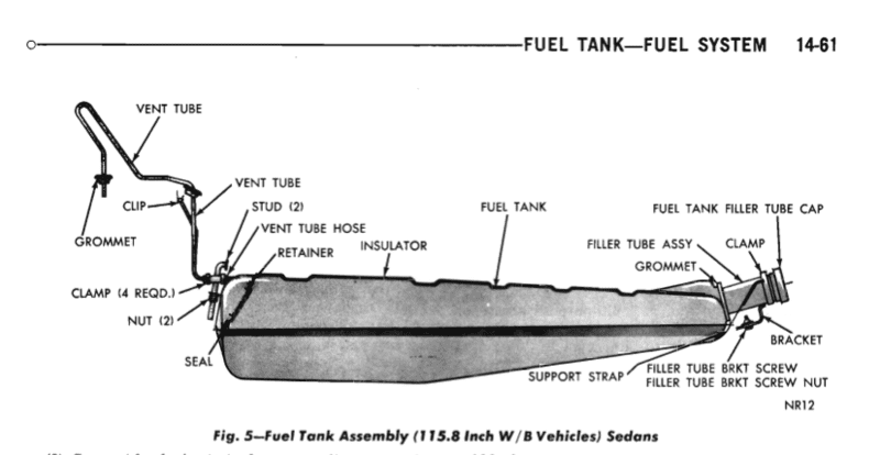

One vent tube is at the rear of the tank and the other is at the front....so no matter which way you park the car...facing up or downhill, the tank will always have a chance to vent off the fumes and pressure built up by fuel expansion.

The little vent line should be all the tank needs to relief any excessive vapour and not build up any pressure...unless it is blocked but then you would hear the pressure release when you remove the fuel cap.
Even then, when the fuel tank is full it will pour out of the filler neck first so if that is not the case it means there is still air in the top section of the tank.
How could fuel be pushed up through the vent tube because the vent sits right at the tank top?

How could fuel be pushed up through the vent tube because the vent tube sits right at the top of the tank?
Exactly what we are trying to work out. Why do the vents not cope? No one is dreaming it - it happens and it seems it happen to quite a few people.
