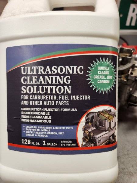

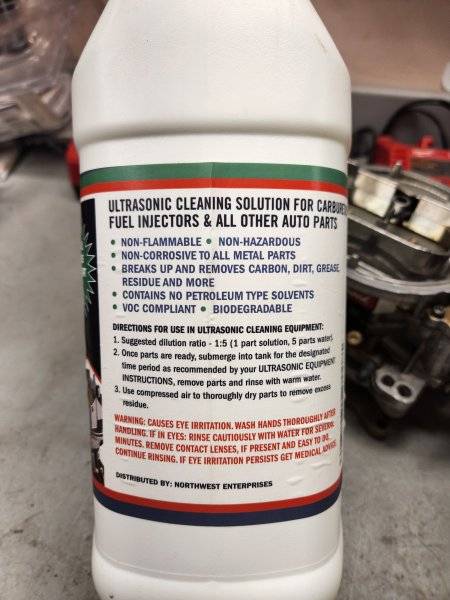

I use this in my heated ultrasonic, but sometimes it takes 3-4 cycles:
https://www.amazon.com/Ultrasonic-S...2&psc=1&mcid=d1a14a5ffa963e60b633d7c4aa4e1f4b
That’s what I use also.
