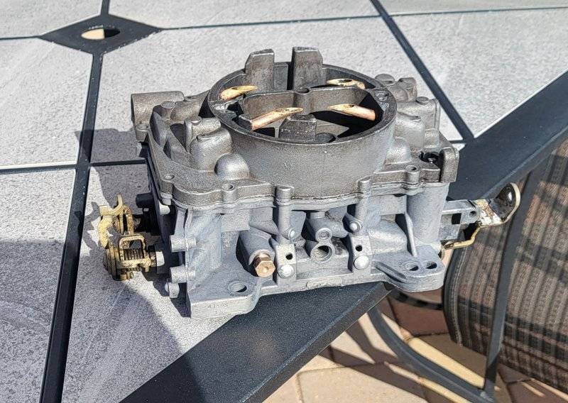

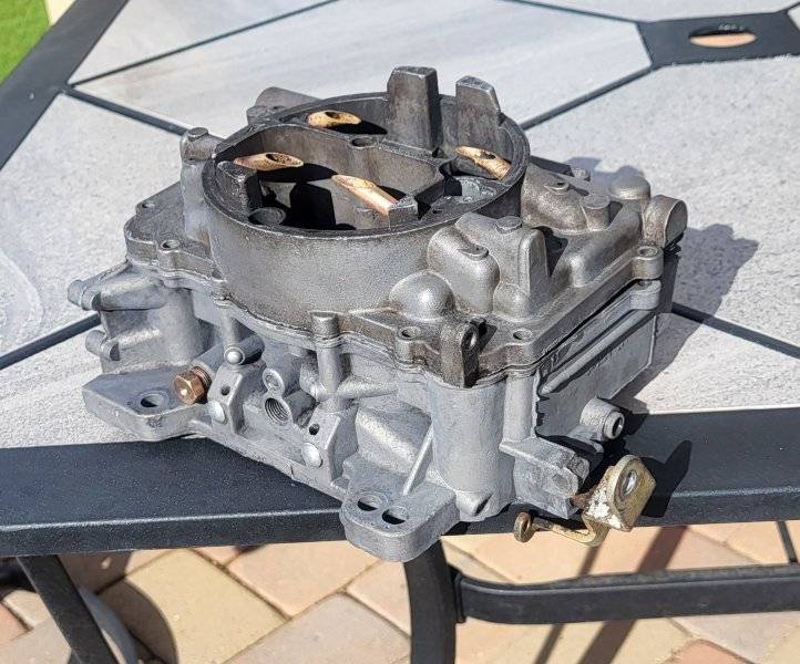

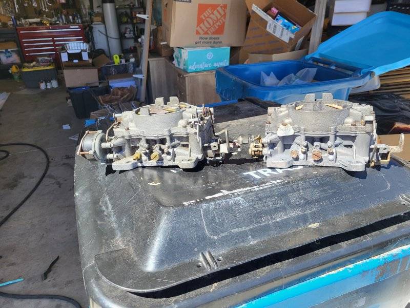

Carb on left was dipped in Berryman carb cleaner
Carb on right I used heated simple green 50/ 50 water mix.
Hard to tell in pictures.
But I like the finish on the right one better ( it's the front Carb btw )

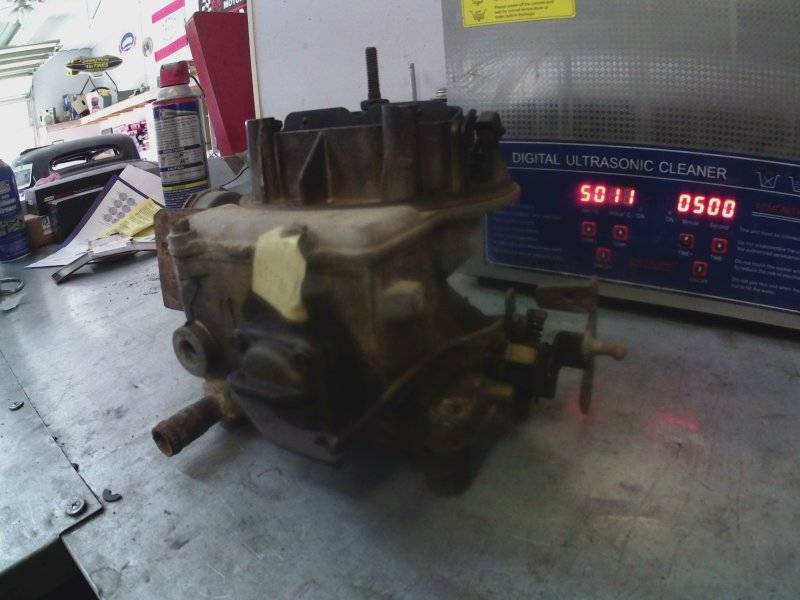

No sonic cleaners avaliable local.
So filled a cheap turkey roasting pan and heated it on outdoor gas grill set at lowest heat setting I could get it.
I'm sold

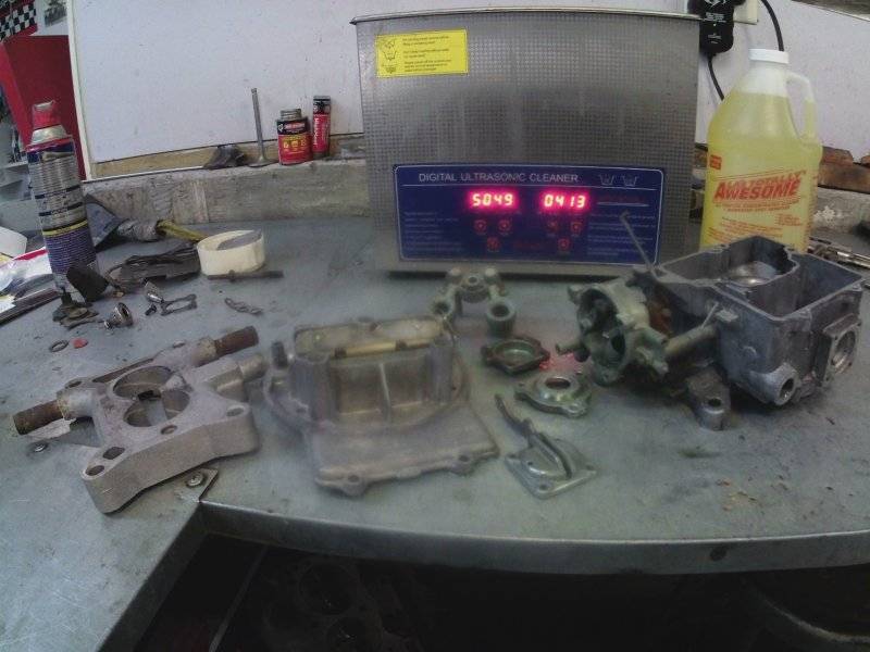

I use some stuff from Dollar General it is called Totally Awesome I use a cheap ultra sonic cleaner off Ebay. Example of before and after. Yes in my experience the Zep products may take off the finish.
