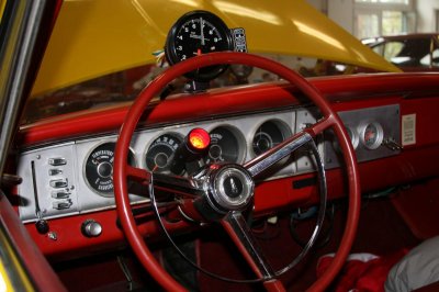

I have one right next to the tach, in front of my face, so that even this blind old man can see it.
It does come on initially, and then goes off as soon as the engine get 15lbs PSI.

That's the way this old, blind fart does it also. I put a "tee" at the gauge and use a standard idot light sender. It comes on when I turn my key and goes off usually in 2 seconds after the engine fires. I mount the light on the tach opposite the shift light and use a yellow bulb..It's is cheap insurance in case you have oiling problems. The odds of you seeing a guage needle falling is slim and none. Some construction eqipment use a buzzer or ringer they could work also..So far I am not that brain dead....all the way???

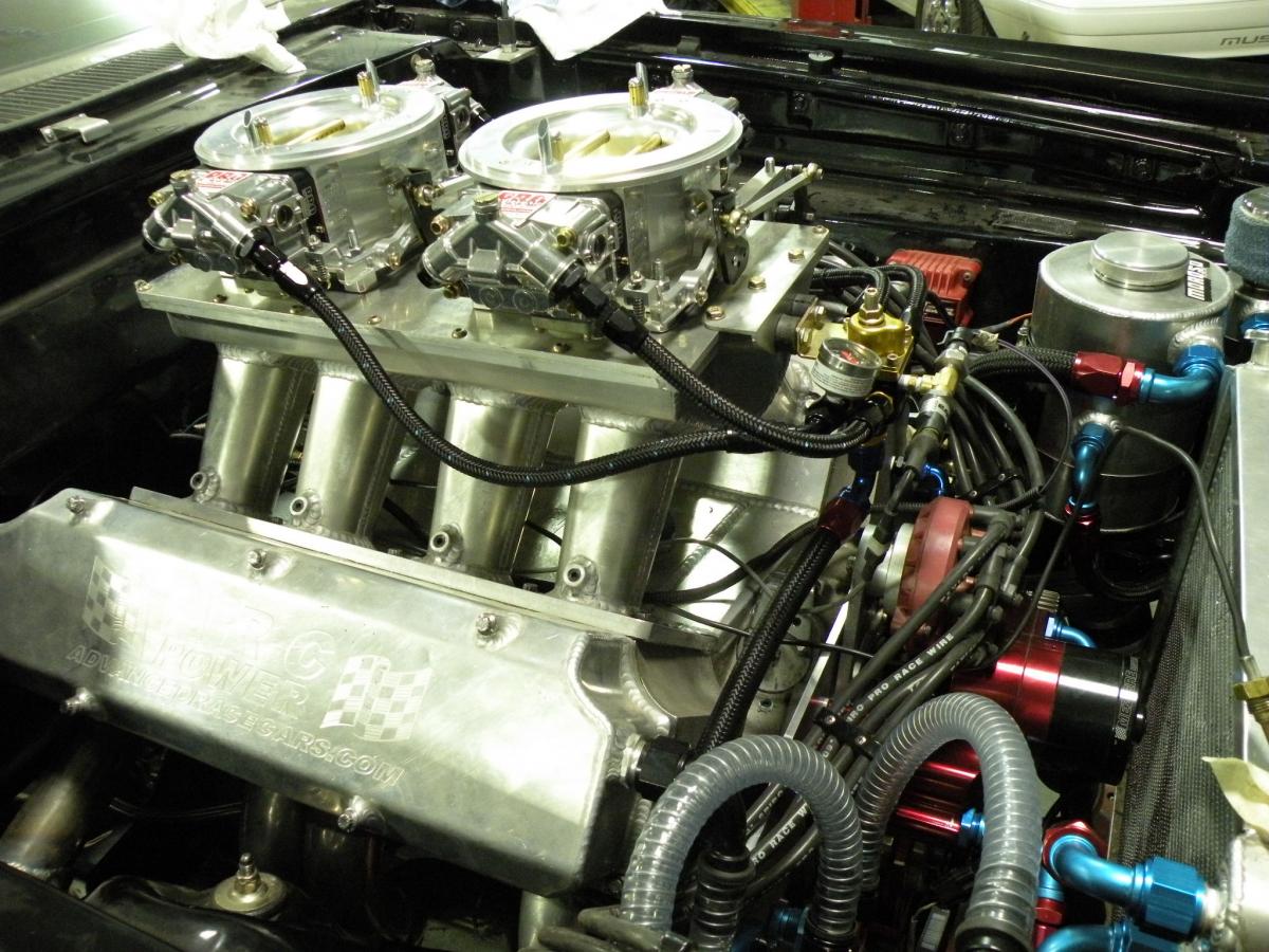

Sweet looking engine & car set up there S/S... a regular oil/electrical hobbs switch will do the same thing basically breaks electronic signal to the ignition & shuts the engine down after it drop below 10psi, only when it's running not before it's stared (I believe it is) , most high end automotive outlets Summit or Jegs will have them, Painless performance sells them I think. I haven't run 1 for a Looooong time.
I feel that 10psi is to low. Heck by that time the damage is done. I could be way off here but I wish they had a warning light pressure switch that comes on at 20psi and shuts the car down if it gets to 15psi. I like to be super safe. I don't have the funds to just keep fixing stuff.

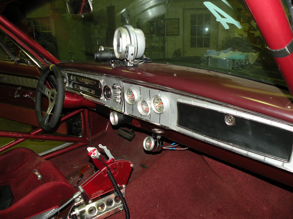

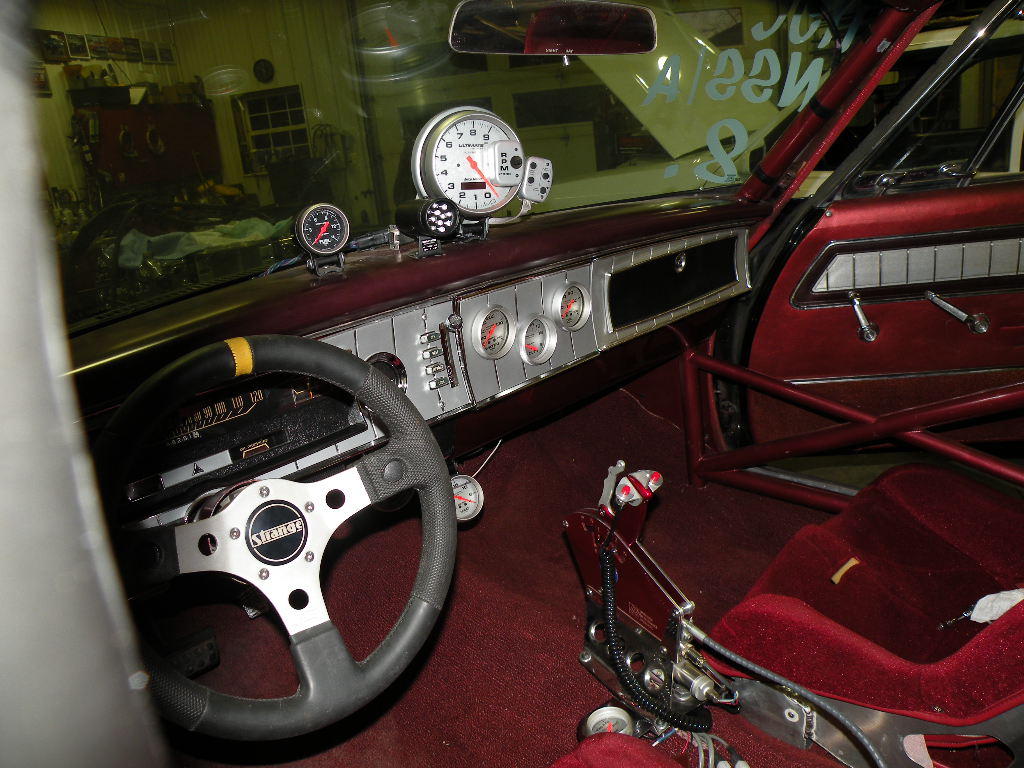

I agree that next to the tach is the logical place to install the light but was just wondering if someone put it in some other high visible place.
I just picked up my Auto Meter low oil pressure switch(15psi) and I got a red 4 LED pod that I am going to hook it up to

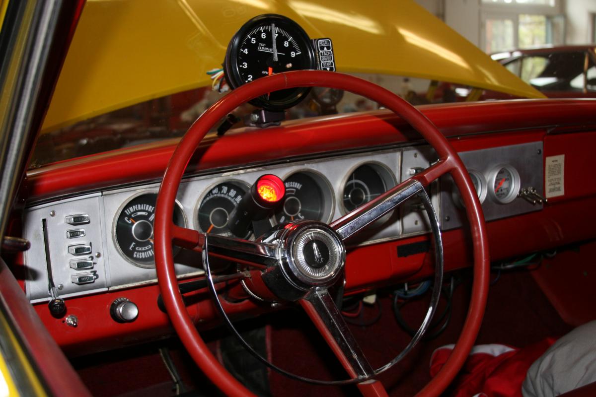

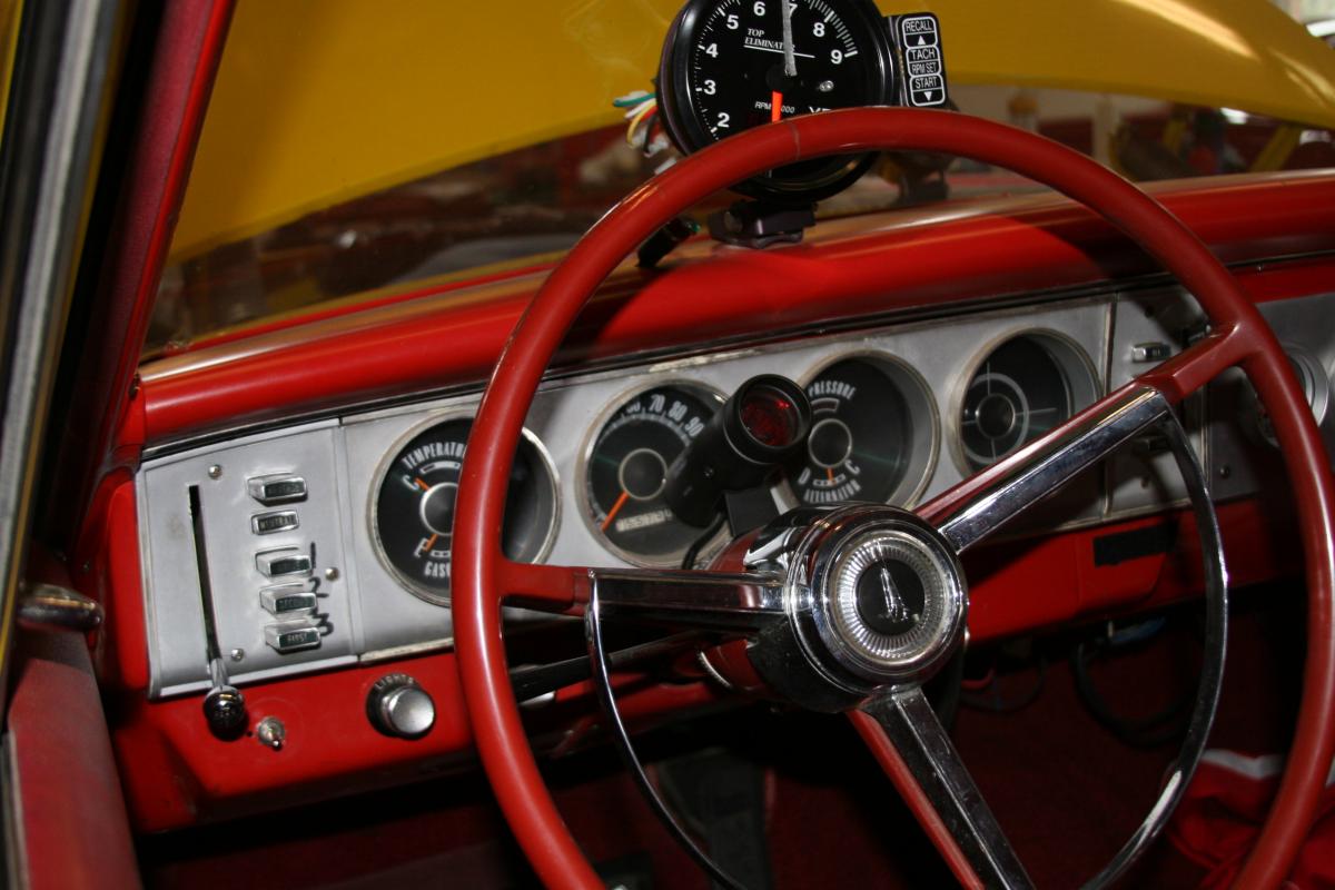

If you want an auto shutdown fug has a great idea. You can get a variety of psi switches - 15-50 to control that. I put my light on the column below the wheel - very plain sight. Mine is key on - light on, 15 psi.
so you used a shift light for a low pressure light?
do you use a shift light?
pretty cool idea.
