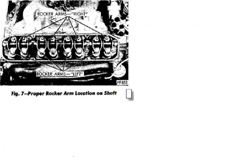

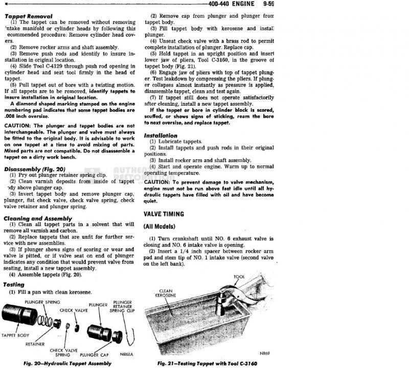

Maybe a bad lifter/pushrod? Could have gotten clogged. Posted manual page in other post. Dropped sm one here.
Here is how the rocker arms look when installed

Found what you were looking for.......
Rocker arms are oiled by way of the rocker arm shaft. Pushrods are not involved in the process. Lifters are easy to replace without removing the intake or head. There is a tool for that but you may be able to do it without the tool (a lot harder without).
Sorry, you are correct. I was thinking of another engine....then the rocker arms get oiled from the shaft, so why is there no oil in one of the valleys?
It must be that the hole for oiling the rocker arms could be plugged in the rocker shaft, yes?
Yes.
Need to pull the rocker shaft, and at least clean it out. There is a oiling port at each rocker arm location. The dry rocker is because the oil port is blocked.
Shaft is hollow, and can easily be clogged by sludge.

Using a magnet to pull a tappet is no problem at all. While it's opened up, check the pushrod, to see if it's straight. Simply roll it across a piece of flat glass. If it 'clicks'...it's bent.
The tappet piston is spring loaded, and you should be able to push the piston, and it return to the top by itself.
Tappets can go bad for various reasons. Clogged oil port, broke spring, wrong size, etc.. And, just flat not getting any oil.

Two tappets? Two choices. Pull both, and go buy two new tappets. Or, pull both, take 'em apart, and find out why their acting up. Trash, broken spring, and so on...even loaded with oil, should be fairly easy to push in the piston. DO NOT mix the parts between tappets. Each one is made as a match.
