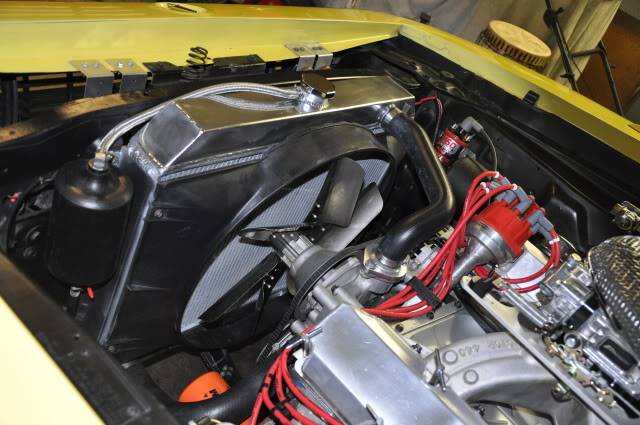

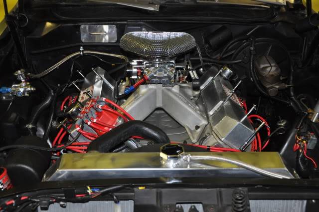

Champion radiator on ebay sold by Reliable Radiator. I can't tell you about thier fan set ups ,but I'm running their 26" 4 core and it bolts up stock and accepts the factory shroud . I was running a 22" afco with a 2600 cfm pusher and flex fan, with no shroud and the car still got hot. It runs cool as a cucumber now and I don't need the pusher anymore.
