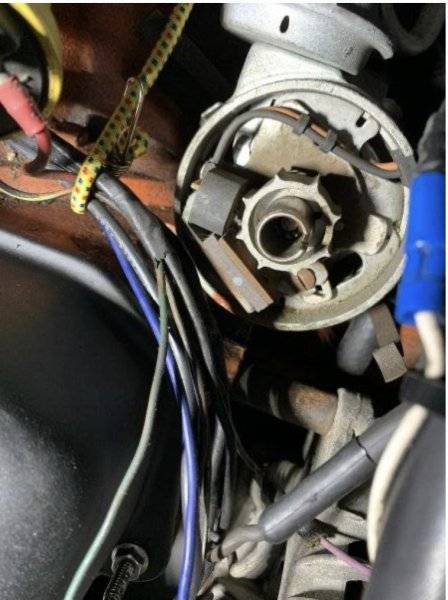

Hi all,
I've read many threads on the "orange ECU"...but am left still wondering where to get one should I need one.
I am chasing an intermittent moderate throttle miss in my '68 Super Bee. Runs fine otherwise. 383, 4 speed. I have recently replaced the plugs (they were 5 steps too hot!), wires, rotor and cap. I also do not know if the wiring is out of whack or not (since God knows how many people have had their hands in it), but it does run well at idle, low and high throttle opening.
I am relatively new to the car, so finding things as I go through it, like it has 452 heads, not the original 906's. It has a Chrysler electronic ignition, not the original points ignition and a Pertronix Flamethrower coil.
What supplier would you recommend to get a quality "orange ECU" to see if that makes a difference?
Thanks!!
Bob
Remove the vacuum advance hose and drive it to see how it runs.
If you can find a good used orange ecu that's the way to go. I would stay away from Proform and other new orange ecus. Just my opinion.

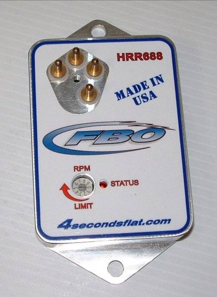

For an upgrade I would go with an FBO ECU. Same plug in, same mount. These get great reviews. And if you want it to look like the orange ecu, spray paint it orange and graft on the aluminum heat sink.

What is the gap on the distributor pickup to the reluctor? You should measure it in at least 4 places. kind of like an
+ pattern

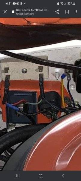

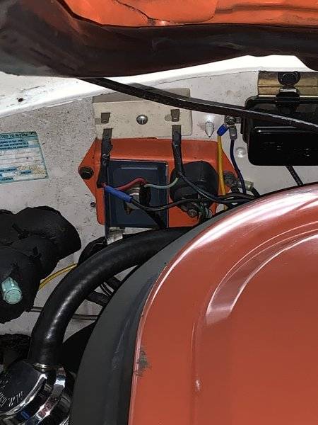

You've got some pretty neat stuff going on with wiring, as mentioned. What I'm seeing here, I would investigate. As an example, it looks like your 12v source to the ecu is coming from the wrong side of the ballast.
It may or may not be. Hard to tell with the different home wiring.
Could you take the aircleaner off and more pics of that area?
With the pin holes for factory wiring connectors on the left side of ballast like pictured
The bottom of the dual ballast resistor is the .5 OHM coil side or probably a 1.2 OHM

Could you take the aircleaner off and more pics of that area?View attachment 1440151
