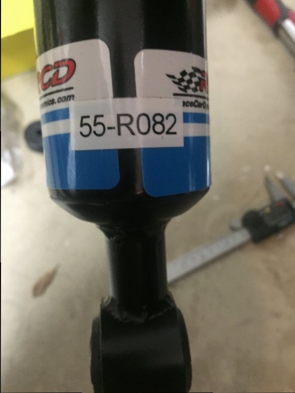

Xp29h... Here is some pics.
What do ya think?

I don't know if this is par for the course, but that part number came out of a Brother label maker.
-Kurt
I bought mine 4 years ago, from a different source, and they have the same goofy part number sticker, so must be par for them to do it this way. I had no problems with fitment.
