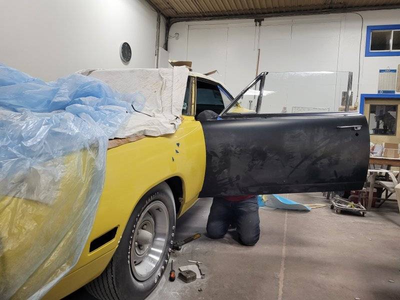

Got a call this morning to tell me the door fit like crap and to see if I could bring the vent frame, glass, regulator and such over to see how we could turn this AMD door from **** to Gold like it should have been to start with for the $1600 cost.

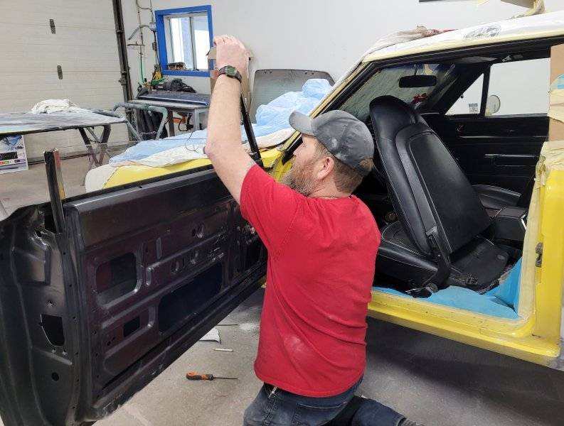

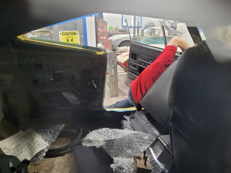

I think this is glass insertion # 3 on the final round after I've been in the back moving the door pillar striker plate outward by bending the factory keeper tabs to get it free. Almost came to popping some spot welds between skin and shell to get the door straight vs some "persuasive twisting".
We had to lengthen the front vent frame attach brackets slots, on the door shell, to get the top of the vent frame to tuck in against the door seals to seal the glass, but we succeeded at that as well with some great team work!

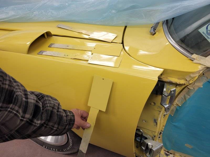

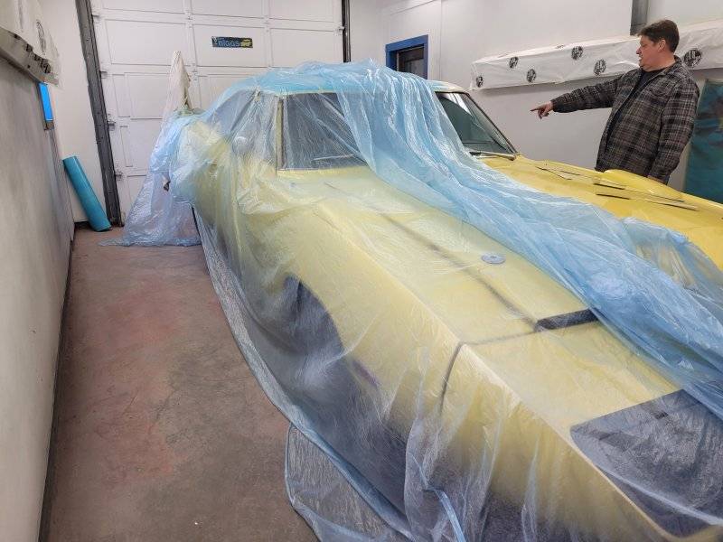

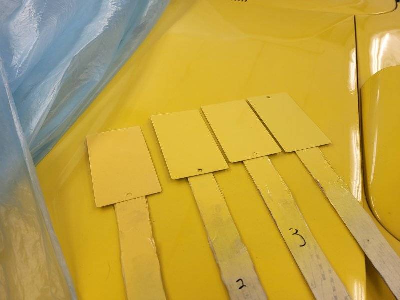

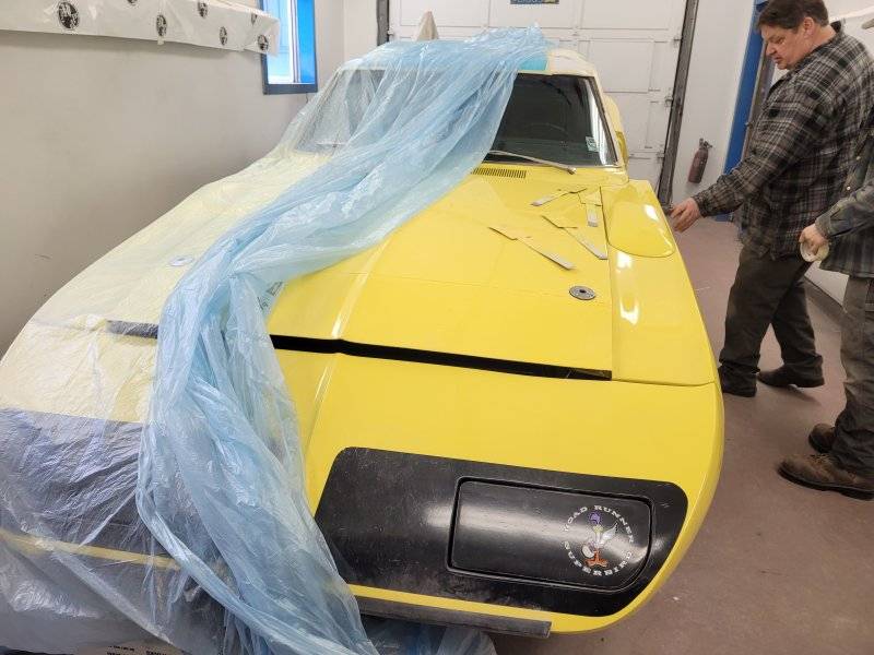

Well the first paint suppliers, PPG, camera/computer shot to get a starting base is a wash. Another supplier giving it a go tomorrow and if that don't work George goes back to old school and 40 years of mixing paint to match this 35 year old paint.
View attachment 1411171View attachment 1411172View attachment 1411173View attachment 1411174
Good thing we don’t live near that guy. Don‘t think there would be room in that town for two of us with the same jacket.
That is apparently a rare skill just being able to match a spray out card to a painted car. It would look like an exact match to me and then once on the car, stand out like a sore thumb. Hope he comes up with a good match for you.
It is not a rare skill, the problem is the toners and paint have all changed. Spies Hecker was the closest for me, and even then it was harder than you think, the original fy1 paint had a slight green/black hue to it under some lighting conditions. FY1 is also way different at night vs day so not an easy job unless you get lucky.
Hence the sun lamp. Takes a lot of the guess out of it.
Oh I guess I was talking about the test cards and the 3-M Sun lamp over on the random thread. Sorry
The ‘bird is well on it’s way to recovery, how’s your arm doing Wayne?
About 80% I'd say. Thanks for asking. As for the Bird I was promised quarter in primer shots for Wed night and asking Thursday where they were I got back "sorry I'm in Quebec sledding". Hopefully he shot epoxy before he left and the boys are blocking it.

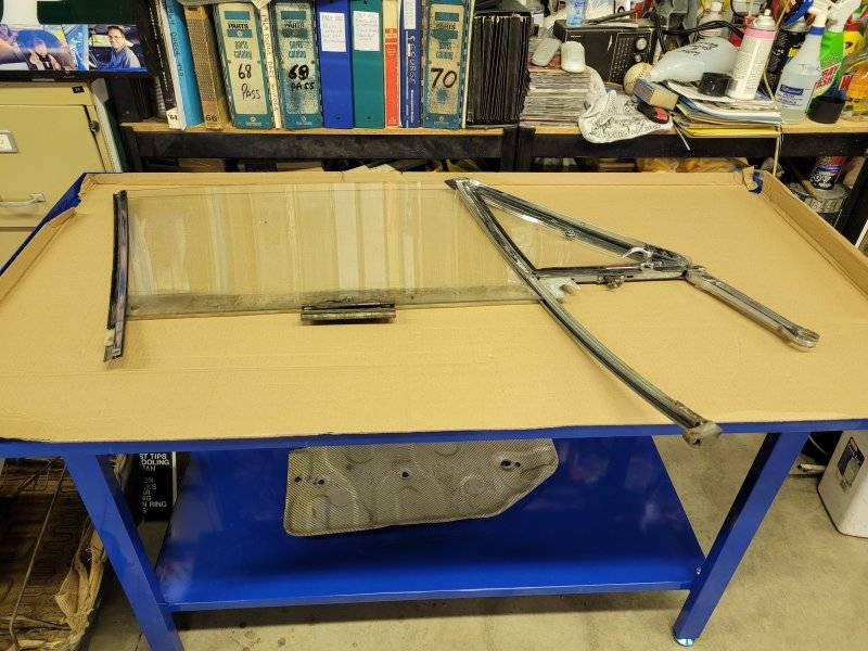

Time to tackle the damaged door glass sliders.
Glass slid out of the vent frame channel.
The glass being jammed into the 7UP machine busted the mylar slider material and damaged the "H" pin slider.

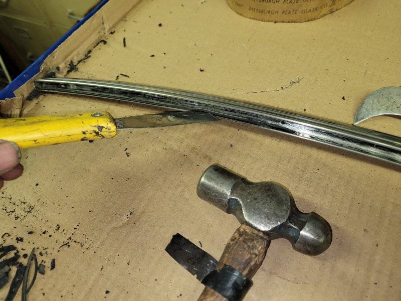

Now to get the 53 year old glass setting tape out of the channel.
People wonder why restorations take so long.
Still going. It took an hour and a half just to get the majority of the old tape out of the channel.

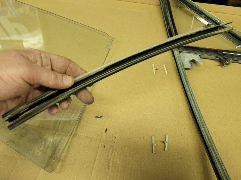

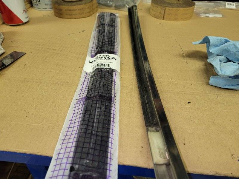

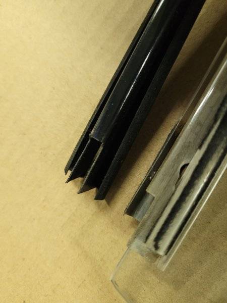

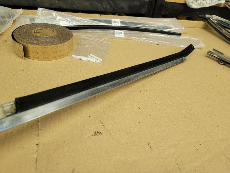

Confusing listing, but this is the correct "flocked" sealing strip for the door glasses rear stainless edge, where it seals against the 1/4 glass.

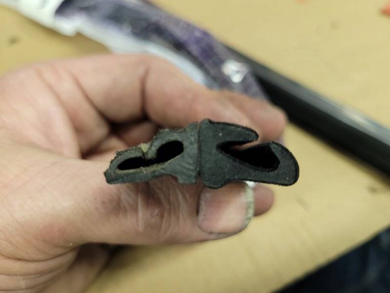

The top of the original unfortuntely got torn apart when it went through the pop machine glass.
Profile of the reproduction is close. Not exact but looks like it will work.

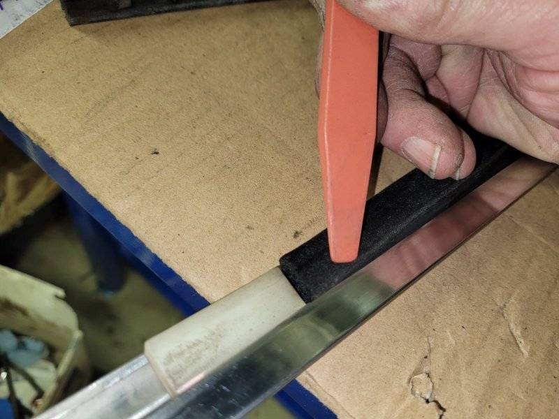

Many say they "just slide the new one down the groves", but I can't see it considering there are three positioning tabs sticking up to negate that ability.
Seal in position and then pressed into the bottom (outer) grove.
Then the other retaining "bump" forced into place in the inner grove, a 1/4" at a time.

OE on the left, reproduction on the right.

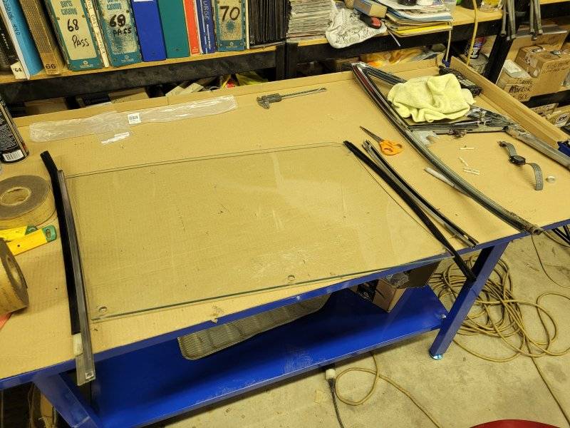

Measured the glass thickness at 0.31 and the channel width at 0.42 telling me I need 50 thou or better tape to hold the trim on the glass tight. Hopefully the 0.060 I have will work. I apologize to any that I previously suggested 0.032/0.040 was the tape for this.
Job for tomorrow, get the trim back in place with the setting tape and a rubber hammer.
