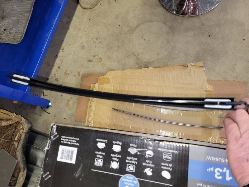

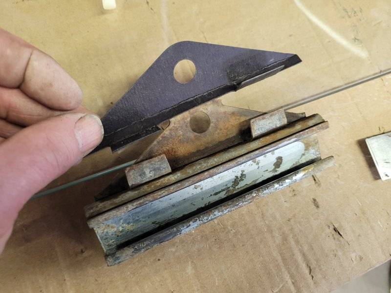

On the lower hole I punched slots for any thermal expansion

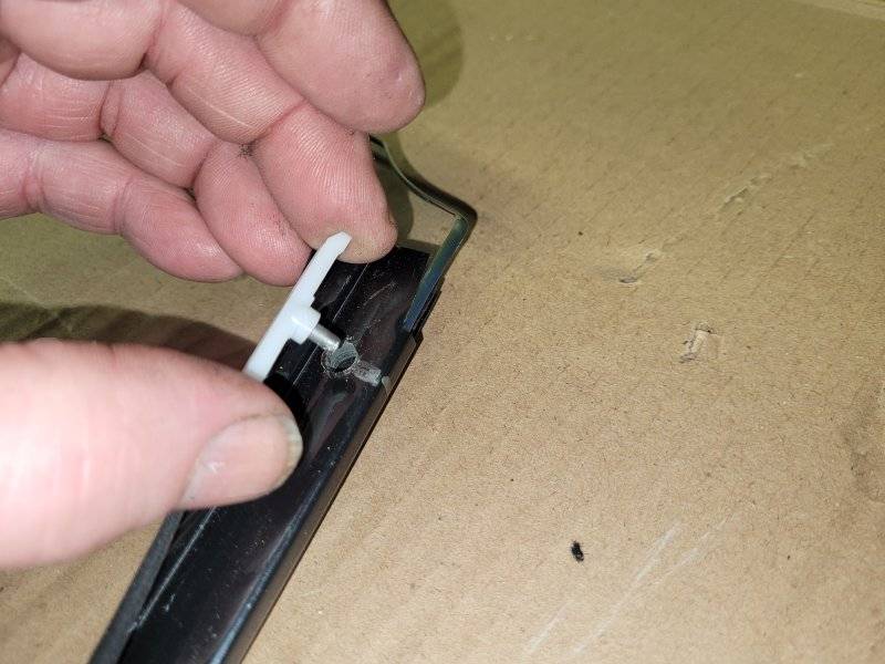

"H" pin slider half going into place.

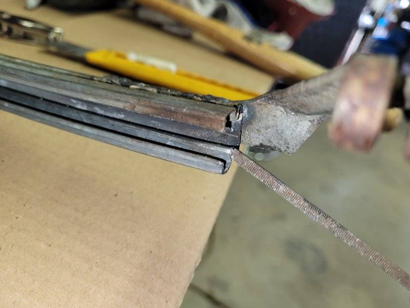

Filing off the sharp corners/edges of the vent frame channel, so they don't tear the 32230 mylar material.

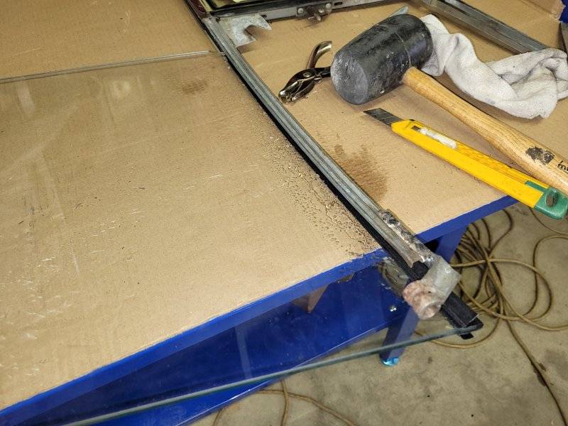

Lower H pin in place and just entering the vent frame channel on the first test fit. Was so tight I had to use the rubber hammer to get things back apart.

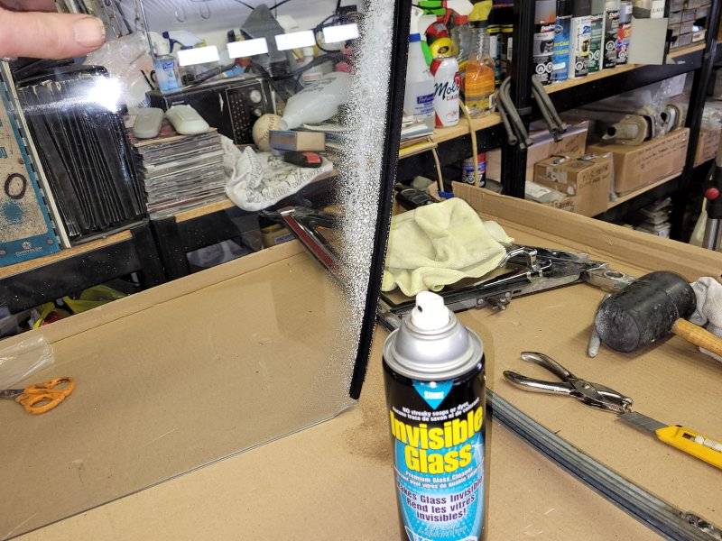

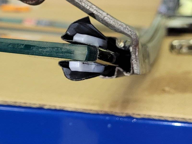

Preparing for test fit #2. Making sure the H pins are fully pressed together and noting the flocking already started to peel on the mylars. Cleaned up and lubed with glass cleaner.
Into the track again for a smoother slide.

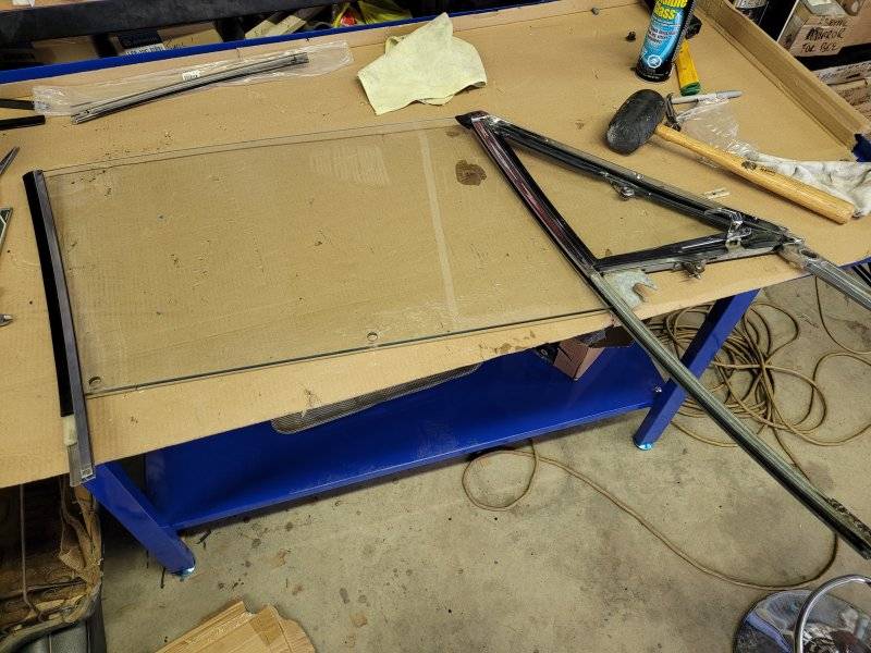

Glass out again and cleaned, then back in for test fit #3.
Together again and some silicon added to the slide channel to free things up and working nicely.

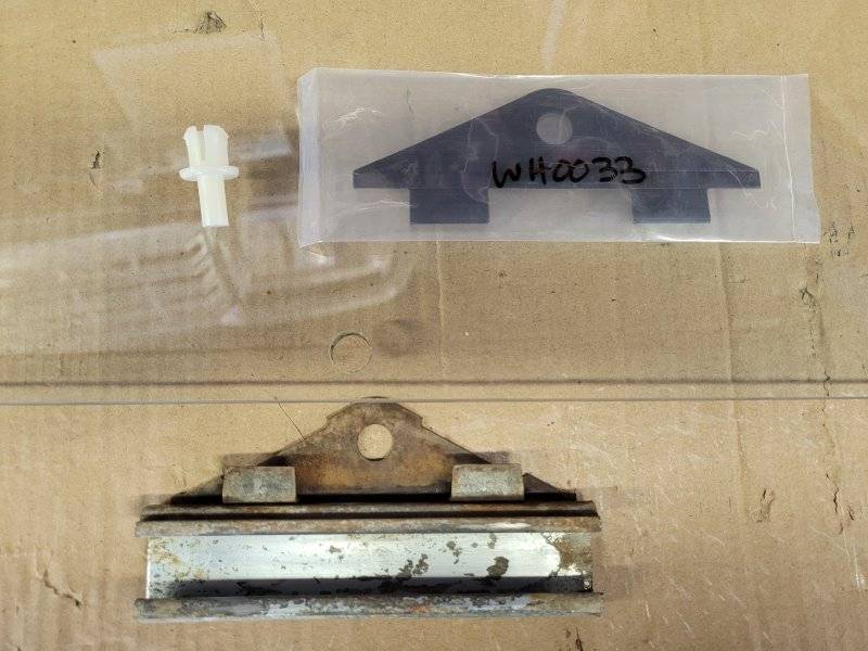

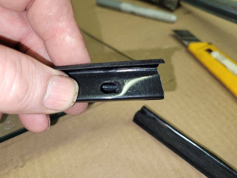

I have found the new white plastic clips are a bit oversized and cause the window to be very stiff sliding in the front track. They usually need to be filed down a bit.
I will use my old sliders if I ever have to replace things. But I was fortunate to buy old stock years ago.
The old repros were useless and wrong in two dimensions. The H sliders that are coming in the latest offering, while not identical to OE, are dimensionally correct.... as I noted previously in this thread.
Yes, I have bought Genuine Chrysler fuzzies that had the wrong dimension h clips included, and repros that were incorrect too. Best to use the original h clips if they aren't broken or crispy.
Yep.... OE's are best, but as I'll note for the third time the latest repro offering has dimensionally correct H sliders. They still have the "mylar" too thick though.

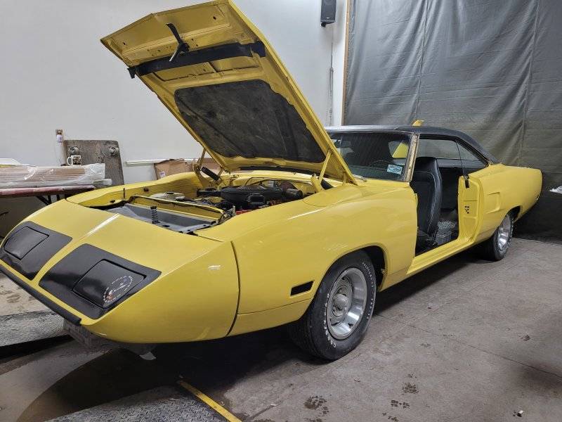

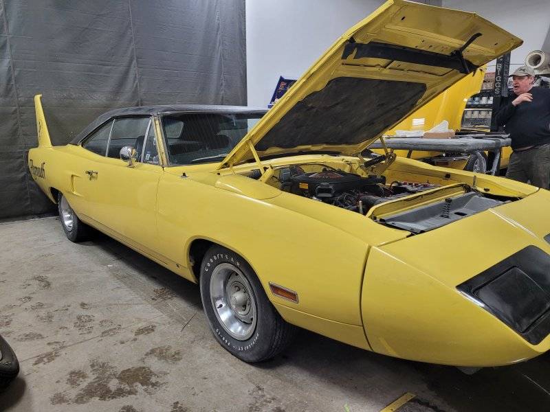

Yellow from my camera, which shows it a bit light.

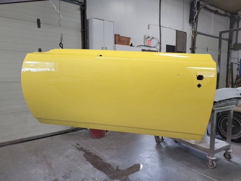

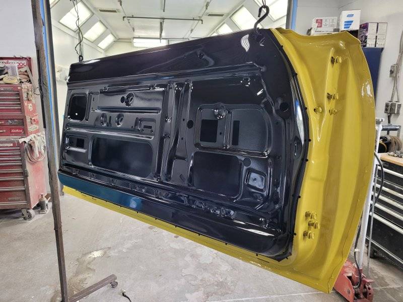

Interior side of the new door painted Gloss Black inside the door seal perimeter.

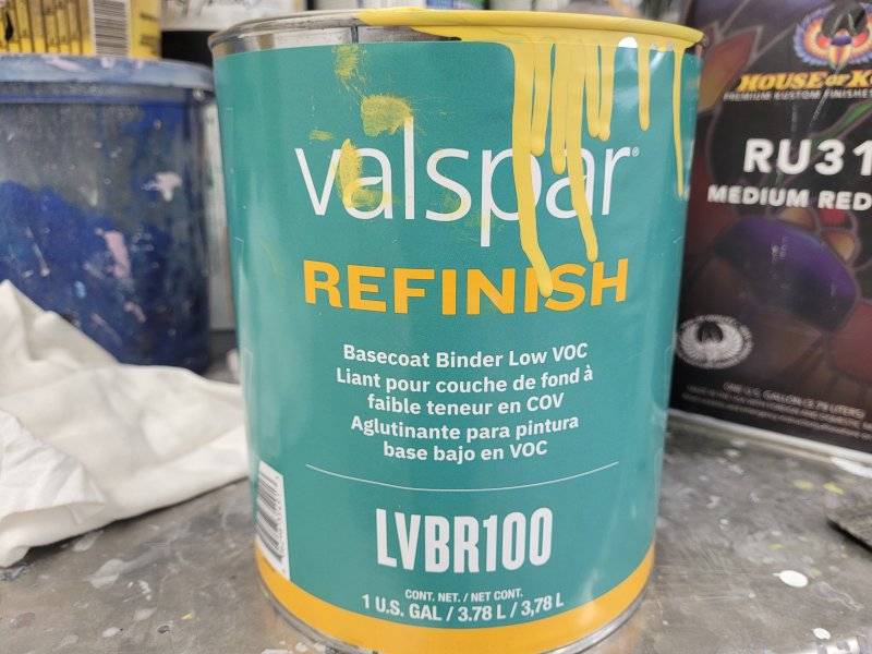

Us Canucks can finally use solvent based paint again, valspar to the rescue!
A very nice match.

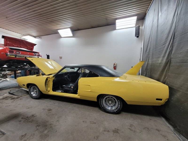

It does make the rest of the car look "beat" though.
Below the body line between wheels was up next.

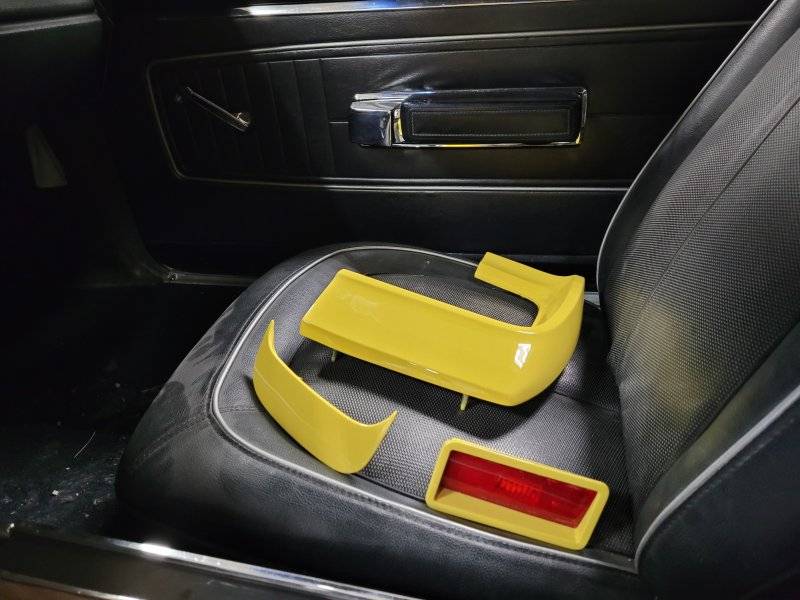

Quarter panel fake scoop, quarter extension and marker bezel all in fresh paint.

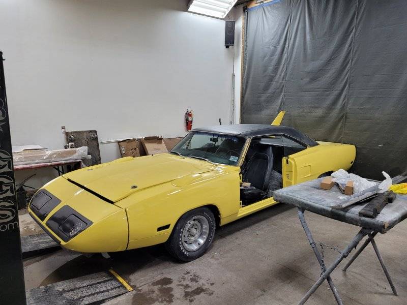

Decisions decisions...

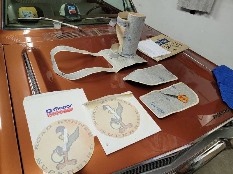

Project creep sets in when you're checking your NOS decal stock to see what else you need!
Looks like all I need is a missing road runner decal for the nose and a small one for the truck lid lip. I start my new job on Wednesday morning at Body by Biggs. I hear the pay sucks...

I just hate to see the crap companies put out as reproduction parts that don't fit, have wrong profiles and need work in order to fit properly. The door, the molding, the mylar. And you are charged a fortune for it. Those plastic h sliders have always been wrong. The mylar is too thick as well. I reused my old sliders in the new mylar and they were still tight.
