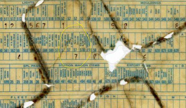

hi all.
a couple of code questions
my 68 runner has factory tach but i do not see it called out on build sheet.
also can not read code for the 15 inch steel wheels
thanks

A package like that did not exist in 68 and if it did, the tach would still be coded on the BS.

Look right in the middle of the sheet for box 57 TACK OR VACUUM. If there is a 7 in the box below the 57, then the car came with a tach.
