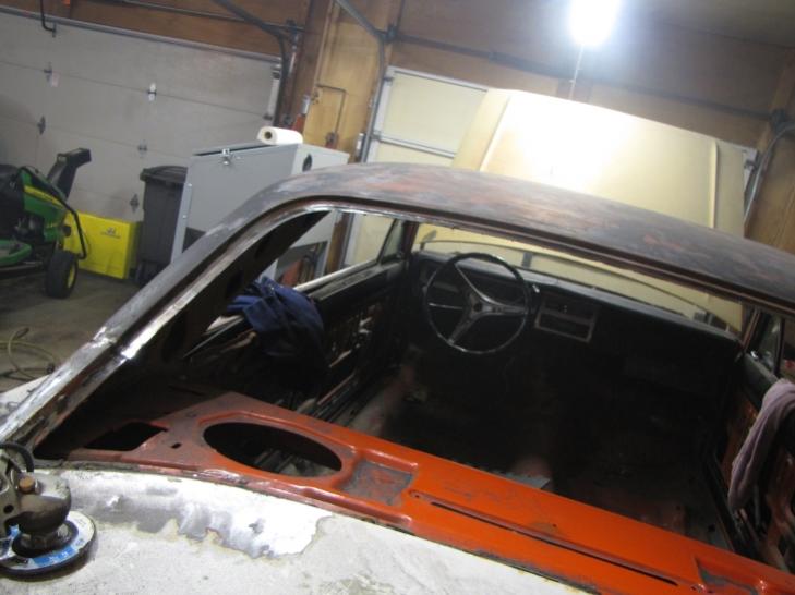

Prepped the donor roof, and also prepped the inner roof frame. Cleaned it down to all bare metal, sprayed Zinc Weld-Thru primer along all the surfaces to be welded to, then sprayed some PPG DP40 Epoxy Primer over the rest of the frame. Roof brace, I didn't any decent panel adhesive to apply between that and the skin, so I went with some run of the mill Liquid Nails in the caulk gun.
Little tough to put on alone, but the skin is on. Fit like a glove. After calling it a night, I'm about 3/4 the way through welding up all the spot welds.
Hey Prop . . . so much for the "special" sunroof option . . . but the work is amazing ( as always ) and the top looks great in place ! ! Are we done yet ? ! ? ! ?

Hehehehe......Thanks Kahn! Yes, the sun roof and planetarium roof are now in the past, but I'm still grateful I got to experience the most elusive of all Mopar unconventional options for a short stint. Star gazing, and the feel of the open road will never be the same lol!

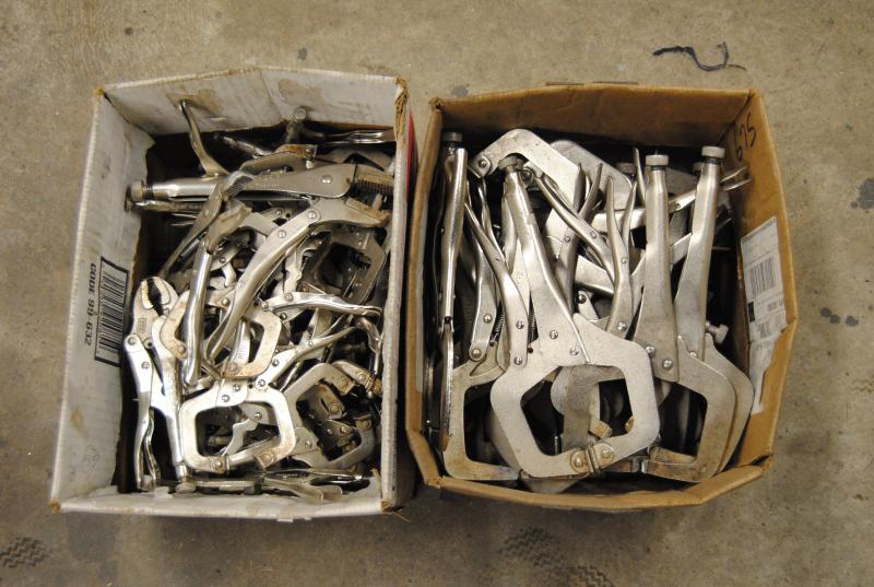

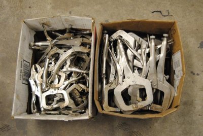

LOL! You know........as I pulled the 15 or so panel vise grips I own off the tool board, and started clamping them on, it become very clear that the 15 should have been about 60. At that very moment I immediately thought of you, and how disappointed you probably would have been at my meager collection of clamps. Hehehehe!
Yesterday was a bit of a "Right tool for the job" Fail, with a definite lack of panel vise grips. Punishment was the use of #10 Sheetmetal screws. I was a bit frustrated, nearing the end of my 75 screw or so option, when the wife came out and said in all seriousness "I can't believe they just screwed roof's on back then...that looks so tacky!" I just told her I was so surprised & stunned the old roof didn't blow off over the years, being all the original screws must have either rotted off or were missing. Close call folks!!!

Like we've said in the past . . . now we know where they all go SGTPaul . . . you seem to have cornered that market ( no wonder Prop's collection is so meager ) . . . LMAO
