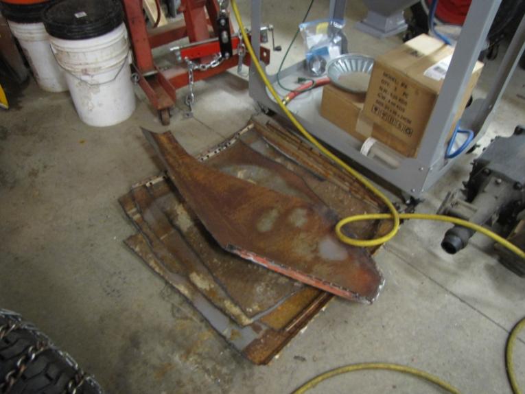

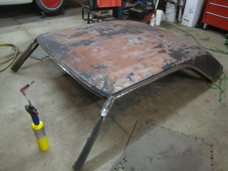

Cut the old rotten roof down to travel size. Need all the space I can get.

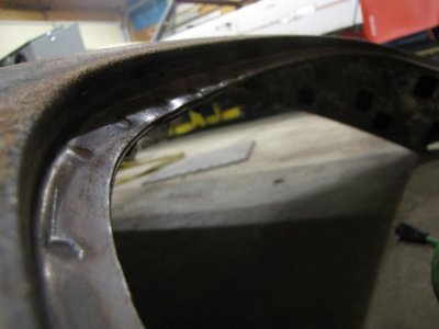

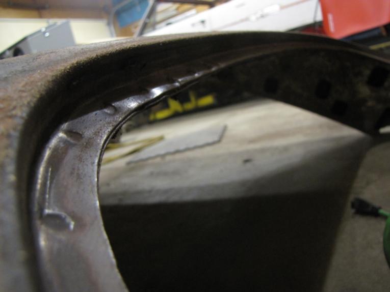

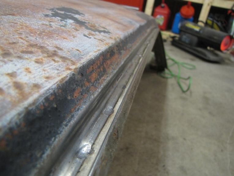

Got the donor roof drug out. Spent a good chunk of the day prepping. About 2 hours with a putty knife and a torch to get all the black butyl ribbon out from around the rear window opening. Rest of the time was spent with a wire wheel cleaning out the heavy seam sealer out of the drip rail gutters.

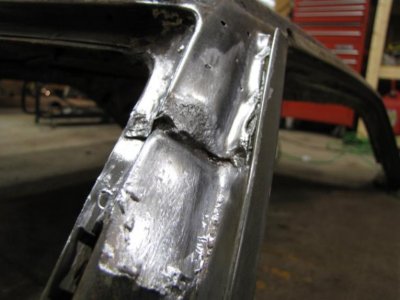

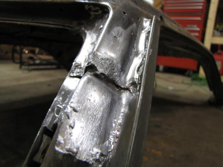

One interesting thing I've found is that the donor roof is from a '71, just like mine, but the C-Pillar on the donor roof/quarter seam was covered over with poly filler, while mine was leaded in at the C--Pillar. Odd. Both of them were leaded in at the top of the A-Pillar's.

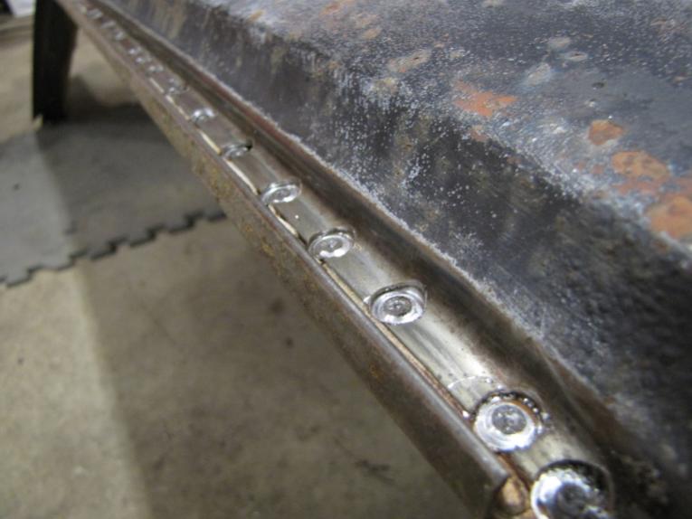

Started going to town on the spot welds, before the wife said play time was over. I plan on pecking away at them over the next day or two.

I see your'e gettin quite busy there Will. On the roof, was it that it was rusted through in spots from the outside? Or did it look bad from the bottom, without the headliner in? Reason I ask is because my GTS had a vinyl top that was taken off a while back. I haven't put a DA to it yet, but it looks pretty solid .

Is it possible the donor roof is from a vinyl top car and the original car wasn't? Reason I ask is I had a 70 Gran Coupe Barracuda w/ vinyl top that the same area was a filler material, not bondo, but a spongy compound that you could dig out with a small chisel.
Thank you sir. It was rotted from the outside Mitch. It was a vinyl top car back in the day. A few years of the California sun dried it up and cracked it wide open. Throw in some rain showers soaking in between the cracks, and it's just a perfect recipe for a rotten roof. While digging through the paint on the old roof I noticed the roof did not have any factory paint, just factory primer. Kinda doomed from the get go. I'd really doubt that your GTS is rotted from the inside out. If so, you probably just need to move out here and become part of the rotted rustbelt club..lol

That would be a very good guess fella's, but the old roof was covered in vinyl back in the day. Kinda wish it wasn't...sure would be saving me a lot of work. Maybe the lead guy called in sick that day that the donor roof car came down the line. LOL
