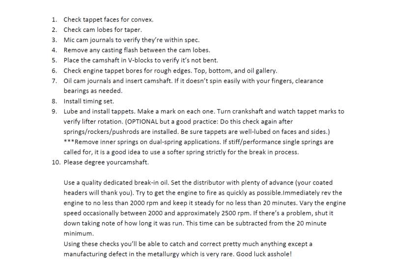

This is my personal checklist, sent to me many years ago by a cousin that owned a performance shop (and races a 6-second Ford....yeah I know Ford eww WTF!)
Now obviously I'm not guaranteeing anyone's success, but this list has kept me from maybe losing a cam through several engines and different cam/lifter brands (including Comp!), as well as engines I've worked on for other people. You know as well as I do, the 'horror stories' are numerous. IMO anything we can do to increase our chances of success is a good thing. I even had one break-in that went really bad that (among other things) took several seconds of cranking to get it to start...and that one ran great.
***If there's anything else anyone wants to add, feel free.....I'm just posting this in the spirit of keeping FBBO high speed low drag!
