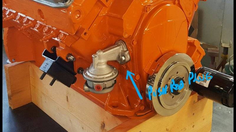

I thought of that as well with respect to the pushrod being worn...can that be replaced externally (through the opening for the fuel pump) or will I need to remove the intake anyways to access and remove the worn pushrod?
There is a pipe plug in the block you need to remove after you take the pump off. It's pretty easy. There are other threads here where someone posted a correct length.
