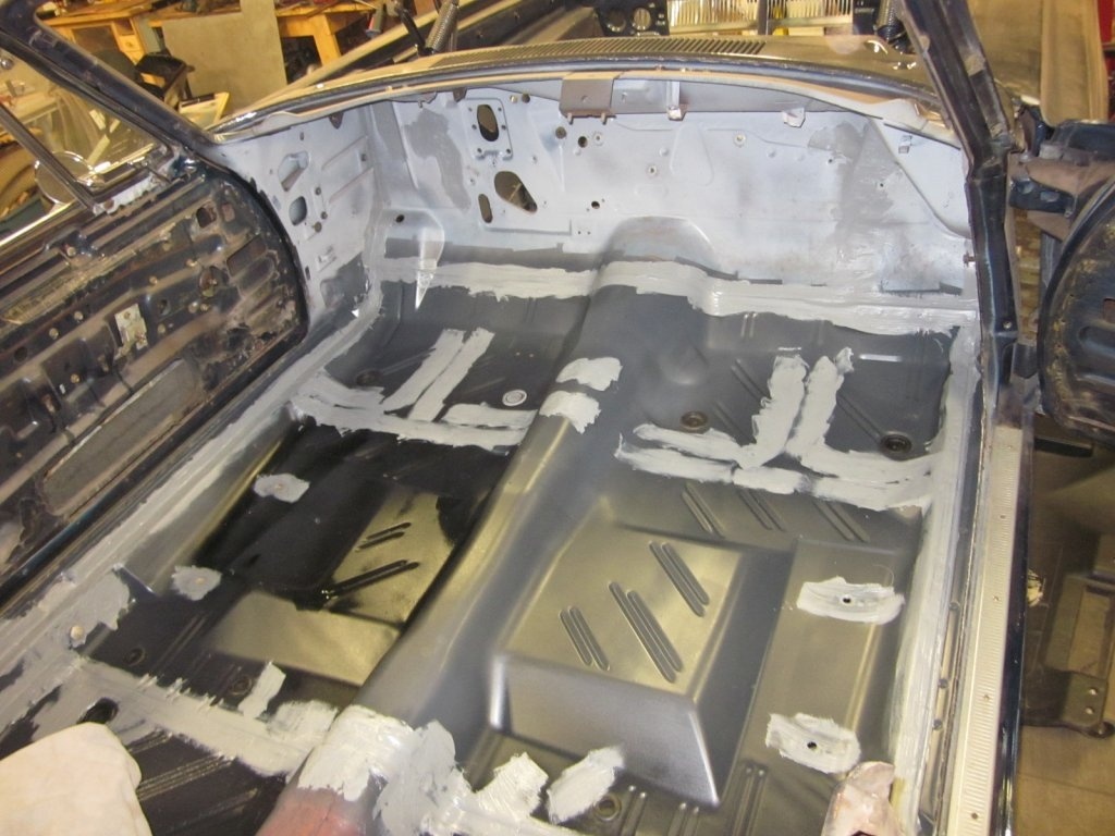

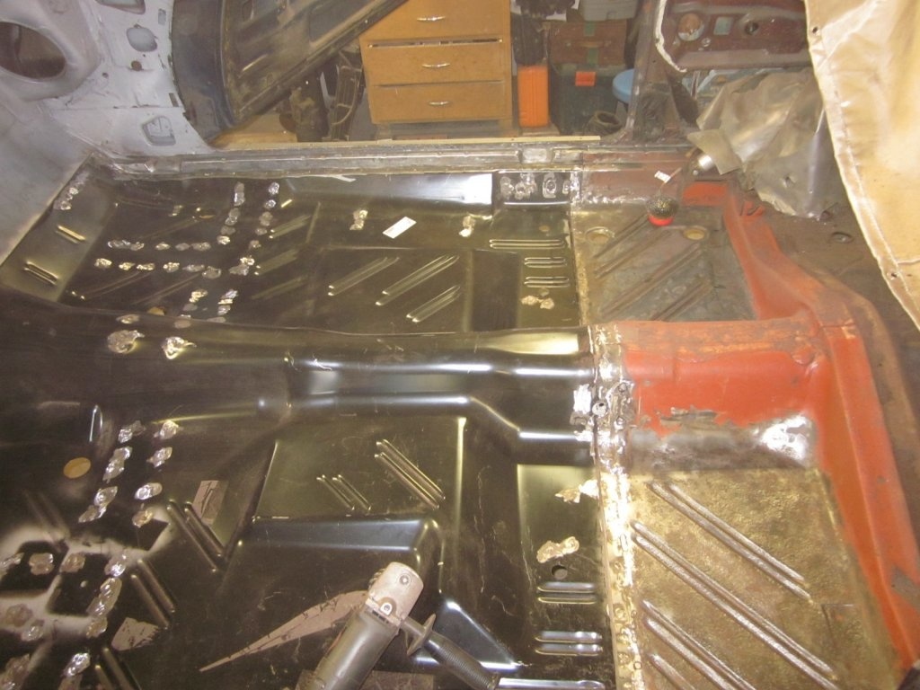

After I finish some major portion, I think 'hey, that wasn't so bad after all' and 'damn that looks pretty good'. That after about 3 hours of grinding 200+ plug welds yesterday!
I hated seeing these floor patches from the day I bought it. Bugged me more than the rotted out air box/firewall because of they way they were done. I really like seeing the new floor pan in there now. Makes it start to look like a new car sort of.
Having never done any type of restoration work before, it's exciting watching it come together. The trunk is next on the hit list.

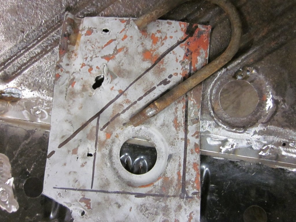

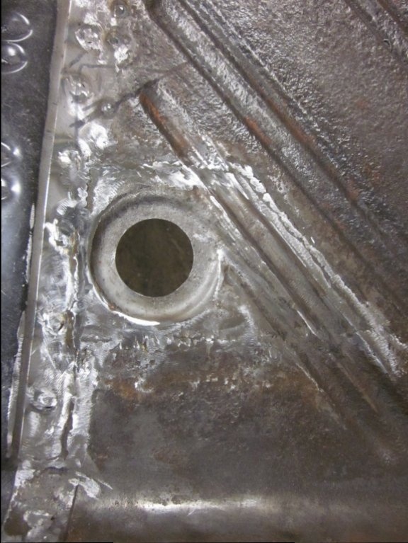

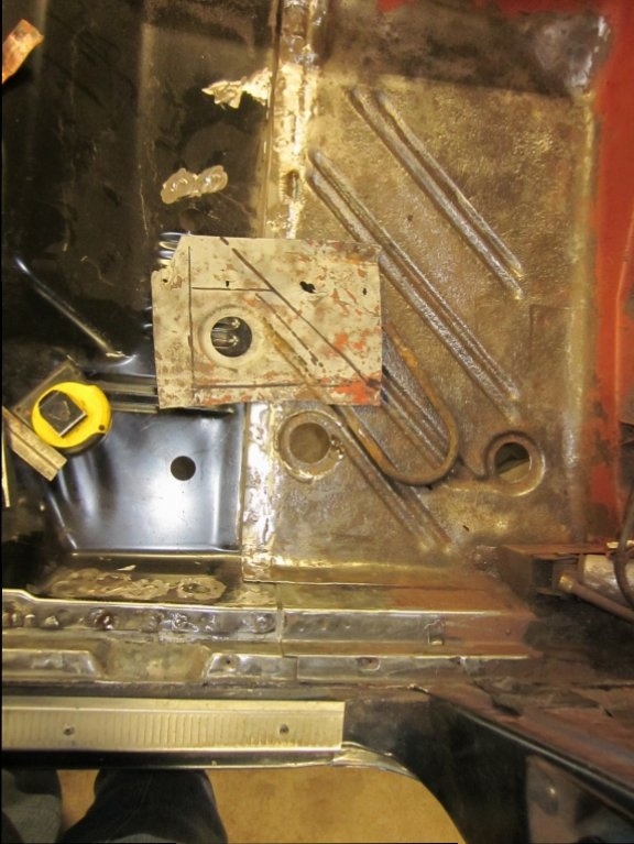

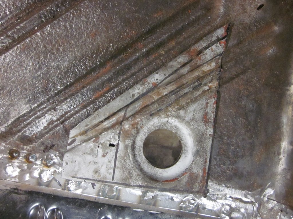

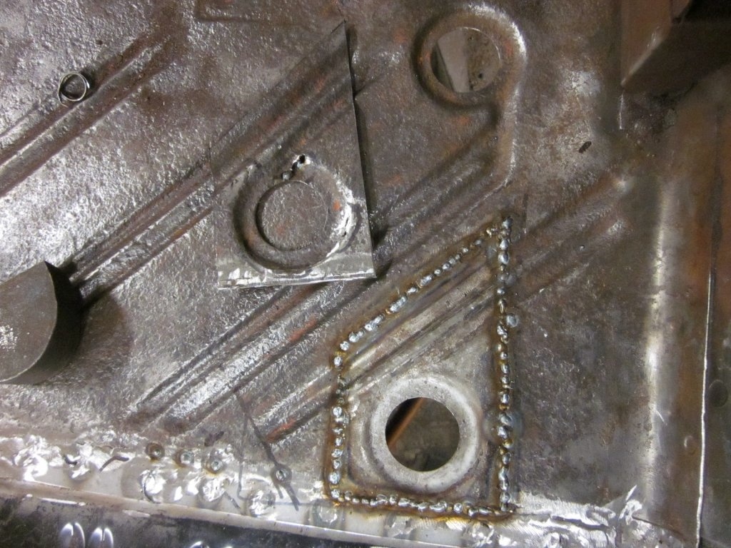

Finished grinding down the welds but still had to address some swiss cheese in the rear pan. I had to replace a strip that overlapped with the new pan, but one area revealed some pin holes after some wirewheel work. In hindsight, I probably should have replaced the rear left pan as it is pitted, but I wanted to see if I could repair it and not disturb the convertible ram mount.

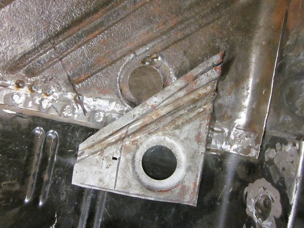

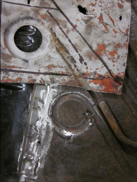

I was going to tyry to replicate the hole but I think that would be tough without a press and some sort of molds.
I found the same size hole in trunk, about the only good metal left in the trunk lol. I carved out a piece.
The surrounding metal is flat though, so I had to replicate the grooves.
The 1/2 ubolt from the rear axle was about the right size and worked out well.
Took some time to shape the metal, but I got it pretty close to the original.
After grinding and checking for pinholes, I think it turned out pretty good.

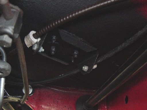

That's a good idea clipping the cables to the bracket.
Only guessing, since it's been awhile, but off the two tabs on my bracket, pretty sure four in all cables were clamped to it. P brake, speedo, and both shift cables, just using two clamps back to back on each tab. Just so the picture is clear. I'm now using shift linkage.

Sprayed some epoxy on the floor and applied some seam sealer. Looks like I'll have to fab up wire covers along the sides. The originals are missing in some areas and rusty.

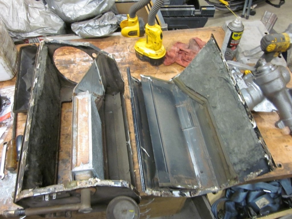

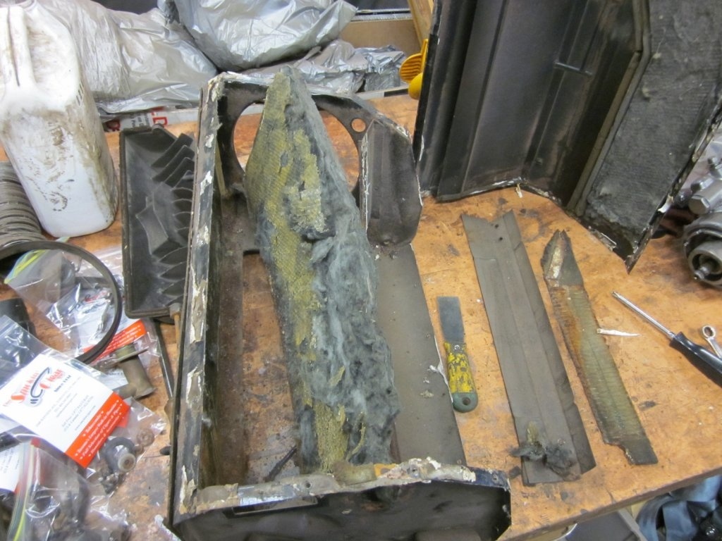

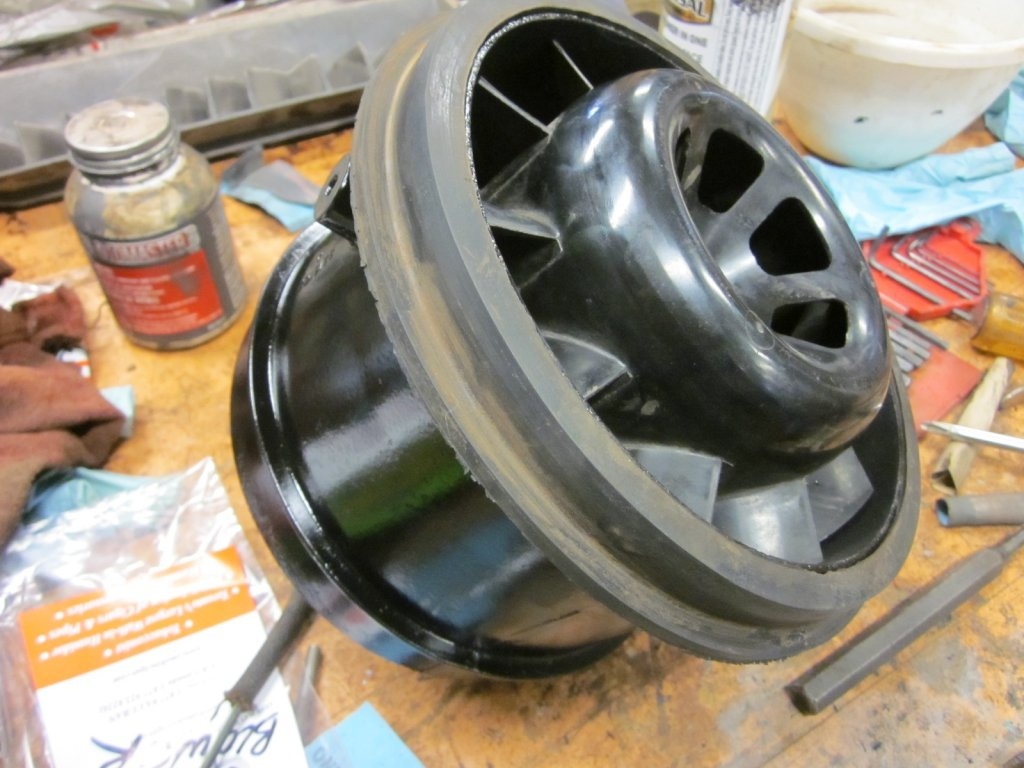

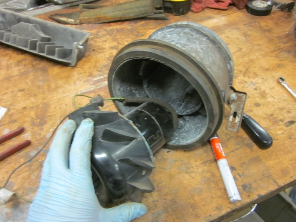

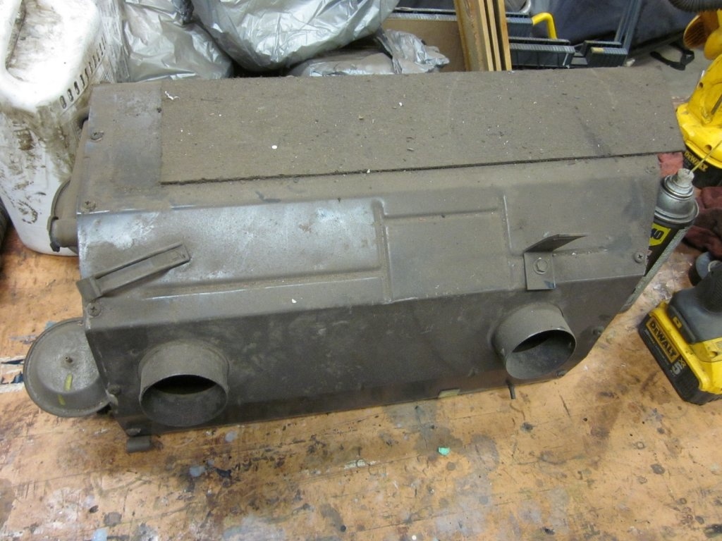

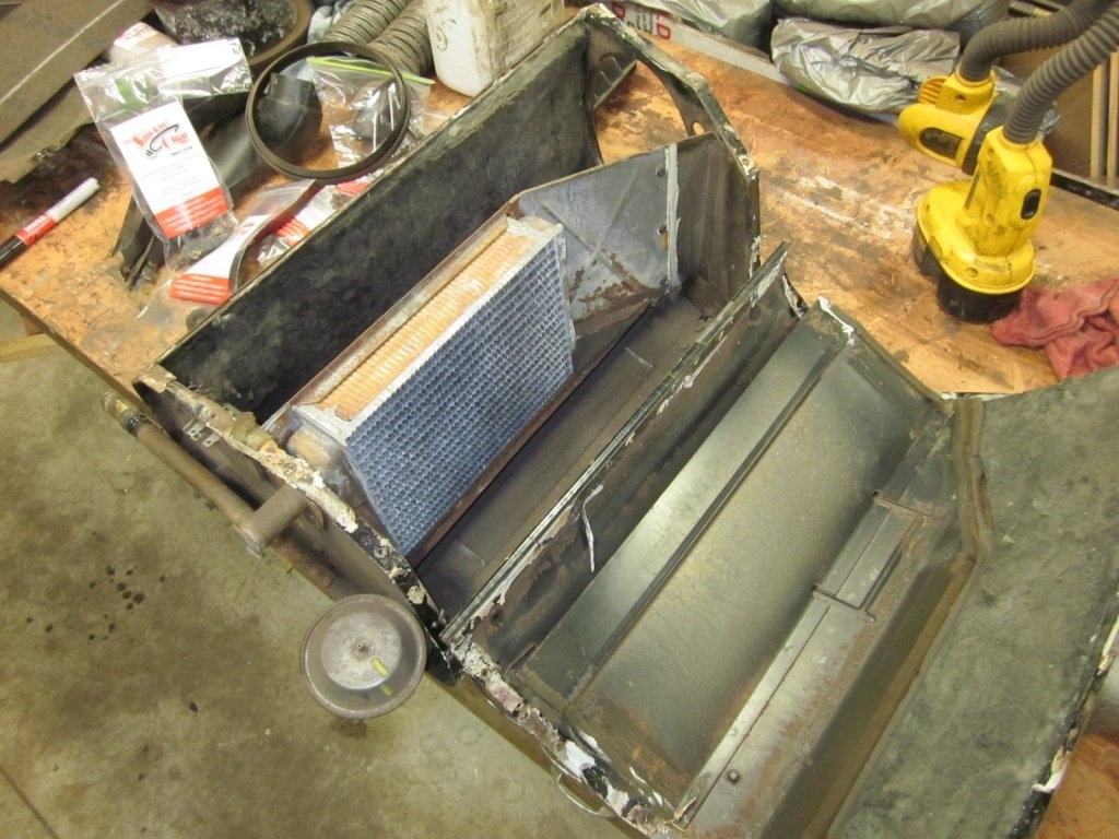

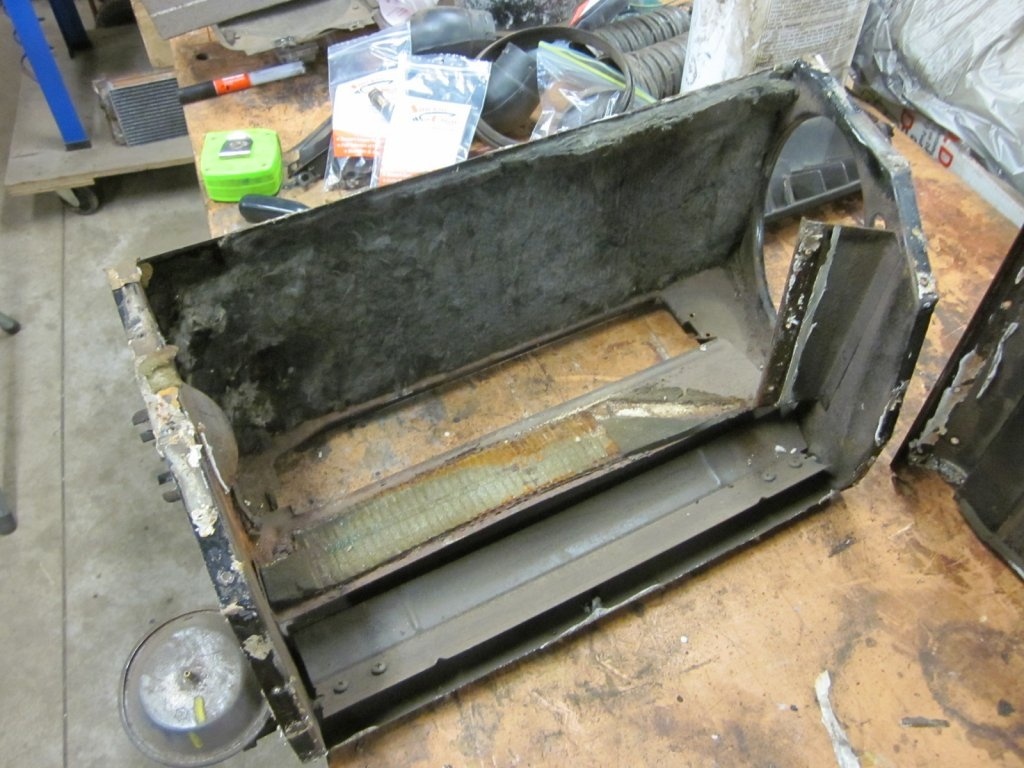

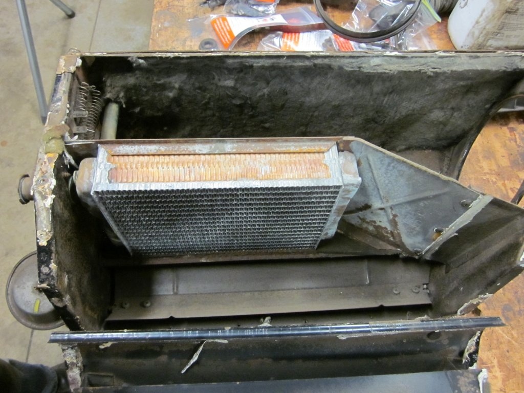

Parts were disassembled and blasted. Sprayed some epoxy so hopefully prevent any further rusting. Ordered a gasket kit from DMT to finish it up. Still have to find a heater valve for the core.

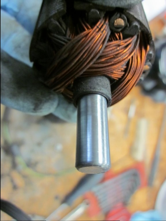

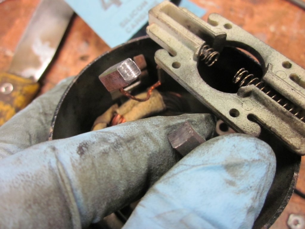

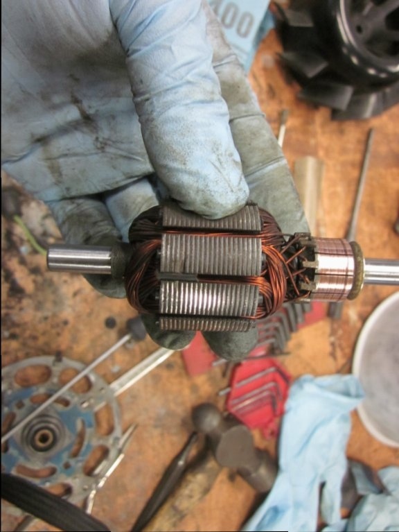

Cleaned up the fan motor and housing.

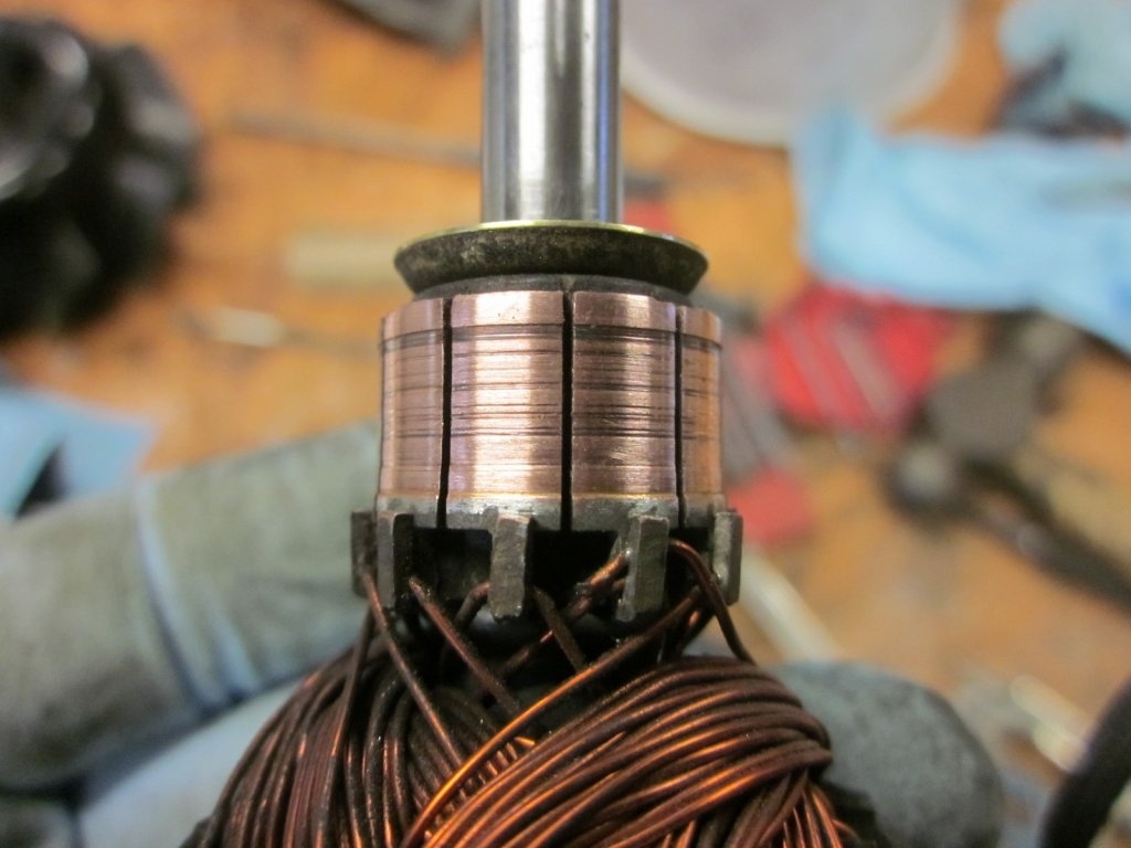

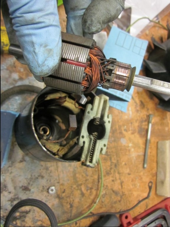

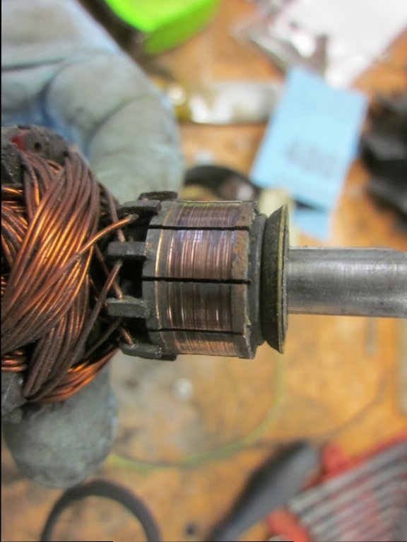

Commutator and brushes needed a little sanding.
If you think about it, might get your heater core pressure checked. Mine had a minor leak...just had to have rad shop put a fix on it.

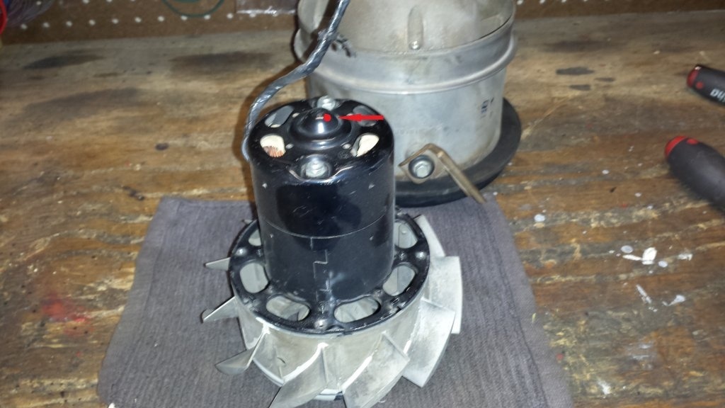

When I rebuilt my blower motor (exact same one) I drilled a small hole in the bottom bearing cavity so I can lube it without disassembly. Hole is plugged with some rtv until needed. Mine was squealing pretty good before hand.
That's a good idea. These motors have brass bushings and the steel shaft of the armature gets a little corroded over time, causing them to bind or squeal. It was a pain to get it apart and needed a little finessing to re-assemble.
Here is where I drilled mine. Small hole, but I have a small oil bottle with a needle end that works perfect.

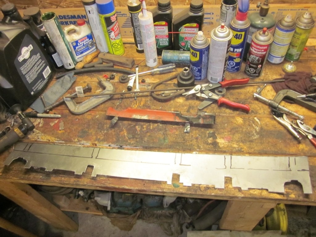

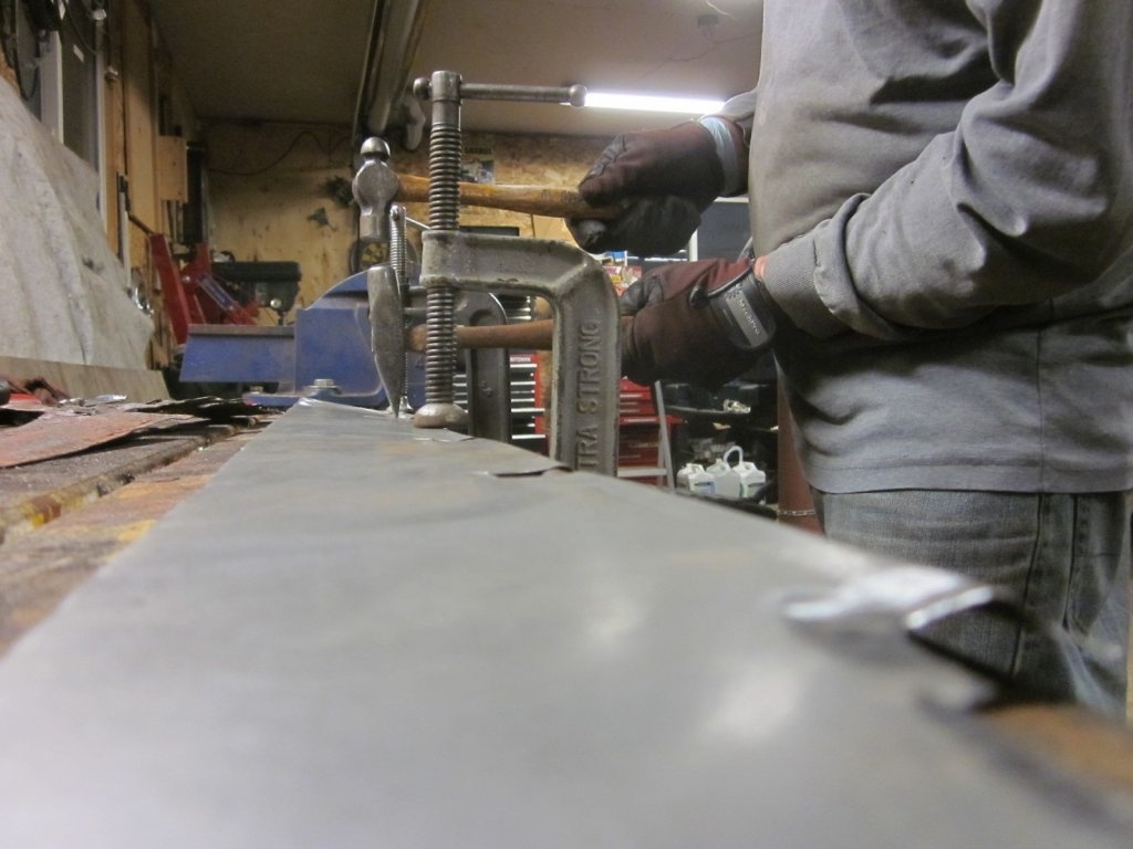

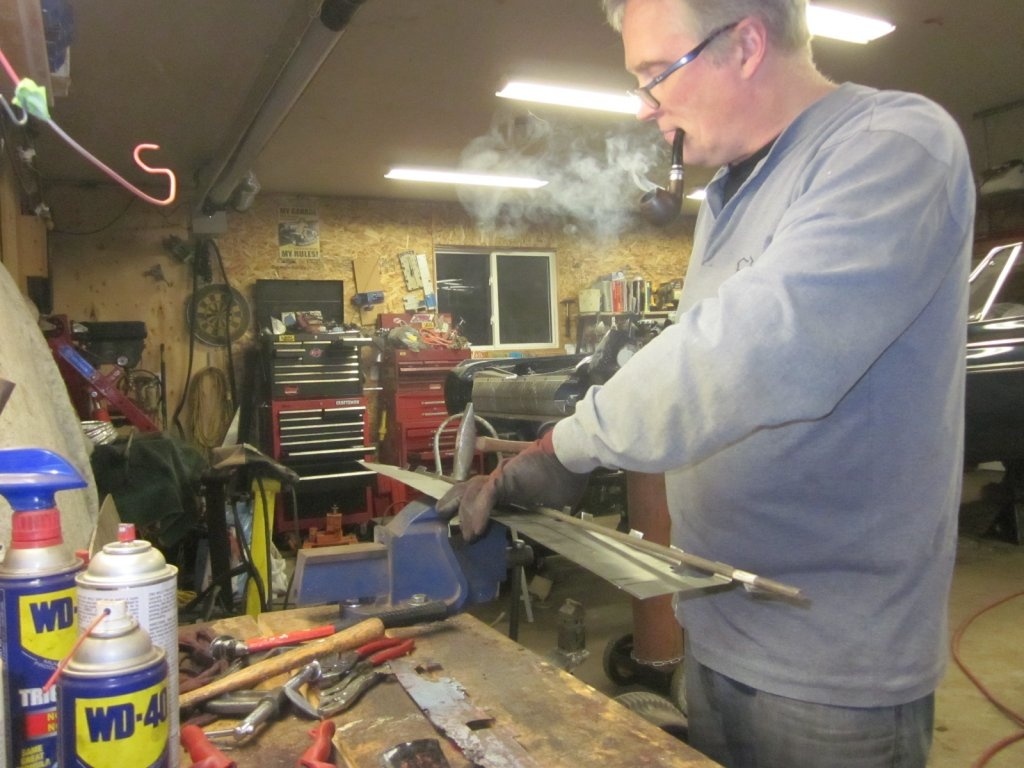

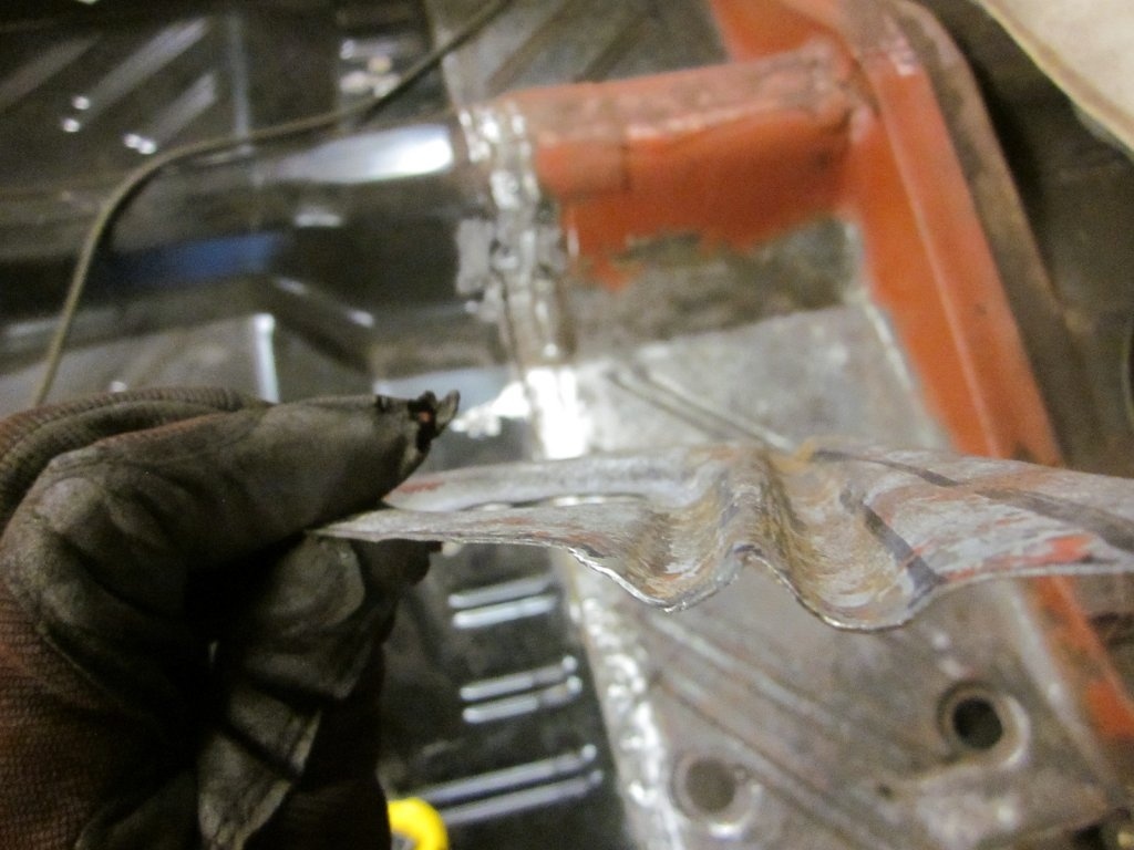

To make the wire covers, I flattened out the rusty one to use as a template on some 22ga.
Some round rod works great to tap in a bead.
Creasing the reverse side.

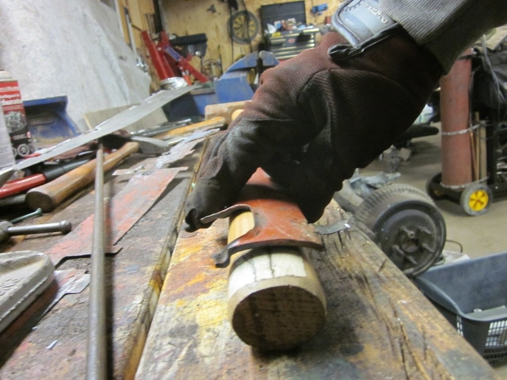

My sledge hammer handle had just the right profile to create the curve. The 22ga bends easily by hand around the wood.
