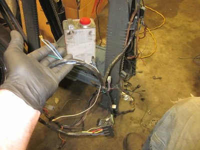

Found some time to clean up the rear chrome and install. After which, I inspected the rear wire harness, soldered some wire-twist/taped connections by a PO and tested.
I pulled every terminal out of the headlight harness from the light and bulkhead connectors to inspect and clean. The harness is in good shape and had little corrosion. After a good scrubbing with electronic cleaner, the wire ends of each terminal was coated with dielectric grease and the flat blades sanded lightly with 600 grit. This original harness has the wire for the windshield washer bag separate from the taped harness for some reason. I do not have the original washer bag so I have to find an alternative reservoir. I was thinking of locating behind the grill, out of the engine bay, so I would have to replace this wire. The original horns are also missing, so it should be fun finding them.
I bought a new bb harness for electronic ignition last year but am disappoint with the quality. I checked each wire against the original for accuracy, color and gauge. None of the wires have tracers as does the OEM, which is understandable I guess. Otherwise, the main color, accuracy of bulkhead port and gauge are correct. The very first connector I looked at had two wires crimped into one terminal and one wire just fell out. So for the next several hours, I took every single wire terminal out of its plastic housing and re-crimped them properly. Tedious work, but a necessity to avoid a fire! Each had the wire stripped too long, which may interfere with the mating terminal when pushed on, so these had to be snipped. Each terminal was then coated with dielectric grease where the wire is exposed to keep out moisture.

The harness has the horn wiring taped with the alternator and distributor wiring. I may untape and reroute the horn wiring. Hard to tell what to do with it until I get the engine in. I don't really like wiring setting on the engine to the alternator and distributor, but this harness may be too short to route along the inner fender.
Cleaning the connections helps alot. I did that on my Challenger years ago. Pulled the terminals out of the housings, heated and cleaned them with tinning fluid, soldered them, neutralized after, packed them with dielectric and re-assembled.
Who made the engine harness you are having trouble with? You are fixing it correct although you shouldn't have to in the first place.
Biggest issue with my harness were the female spade connectors being loose so I tightened the fit with some pliers and cleaned the connections. The floor dimmer was loose and caused some weird issues including a hot connector.

It was ordered through Mega parts. I don't really trust these reproduced harnesses anyway, so I prefer to check them over like the originals. I didn't notice any loose spades yet, but I haven't connected everything yet. Next, I'll inspect the original dash harness. Hopefully nothing crispy in there!
Pretty much what I did on mine. Actually had the original, plus an extra, both having cut/bad wires. Used a sheet of 2' x 8' plywood, to lay a harness on, nails to locate lead-offs on the harness, and each wire end. Just to make sure, what I finished with, would fit the same. Worked out great!
Actually used the best wires off both harnesses, to get one complete. It's a mess to deal with, but needed! Some wires were completely replaced. So far all is good, after testing. Only issues are a few instrument lights not working...but, can be from no power, bad bulbs, or connections.

That's a good idea Miller. My old engine harness has fried wires from the horn relay and down to the starter from heat. The starter control and power wiring are not included in with the harness, so I'll have to make them up and I'll use 10 gauge instead of the 12ga the factory used. I also have to make up the battery cables and ground jumper. I'm contemplating running a bonding ground wire front to back and various points in the engine bay and under the dash to a common terminal base to ensure good grounding where sheet metal is relied on. I'd like to replace the fuse board if I find something I like with more circuits. I'm pulling apart the dash harness today which looks to be in good shape. I'm paying close attention to the ammeter wiring. I'd like to find a way to replace the ammeter with a voltmeter in the cluster. I'll likely either put a fusible link in series with it or bypass it altogether.
