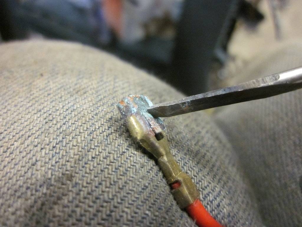

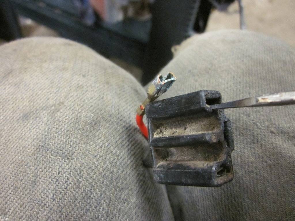

Went through the dash harness which took much of the day. It's in good shape, so each wire terminal except the cluster and steering column connectors were removed, cleaned and greased.

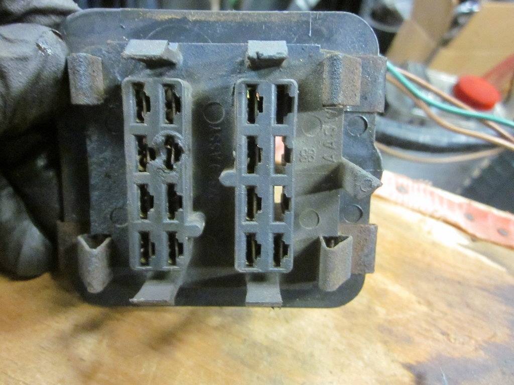

Here's the high beam switch connector which has seen lots of moisture in 53 years.
The door light switches cleaned up pretty good.

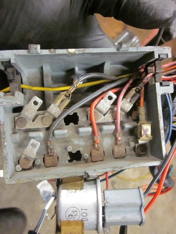

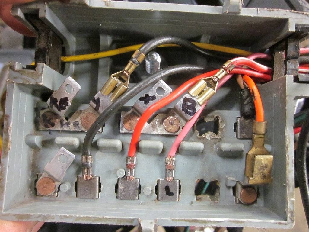

The infamous black wire that carries current for lights and the start relay was starting to melt the plastic bulkhead port. It was stuck to it, making it tough to remove but was in relatively good shape after a cleanup.
