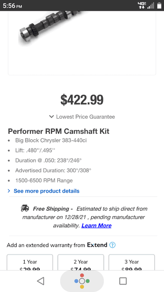

Hey guys I'm building a 440 and had a ? About how big of a car is needed .
So fairly str8 forward build
Eld rpm top end intake cam alm heads 84cc I'm thinking of a 440 source lower end to get compression to 10.1
Comp roller rockers 1.5
I'm told I need a 850 CFM minimum
I have a brand new 750 CFM carb sitting here will it work or do I need bigger ?
I'm looking at a holley brawler 850
The 750 will work fine. Run it for now to break in the cam and engine. If your performance feel falls short, then perhaps the larger carb will fit the bill. The 850 will provide more top end and most probably a better throttle feel as you press on the go pedal.
If you have a vacuum gauge, run it and see where it goes when your at wide open throttle. 1.5 or less is the target. If it is above 1.5, you do indeed need a bigger carb. The differences will probably be small but noticeable.
Unless you'll see track time, the 750 is fine. Especially since you already have it. You can jet it to meet your performance goals.
