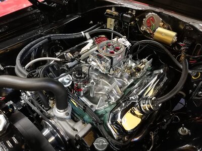

Tuning the carb and I have a bog off idle I cannot get rid off. (413/650 carb)
Standing still making a quick blip to the throttle and the engine almost dies.
With the afr meter im at 14 idle, cruise 13.6. From standing still I can move the throttle slowly just a bit and I reach 13.6.
The strange part is where I just put my foot on the pedal ever so slightly so the car creeps away then the afr meter shows and holds on 17 until I press the pedal just a tiny bit more.
Ive played around with different pump nozzles/cams, float levels, but no change.
Timing is at 14 (Too advanced?)
Could it be too big idle air bleeds?
If anything advance the timing some more

My vacuum is now on ported, will try moving it over to manifold to get a little more timing.
Am I looking at the wrong place, should I hunt for mainifold vaccum leaks? Am a bit lost here...

Yeah, sorry, its a QFT plate that has ported and manifold right next to each other.
