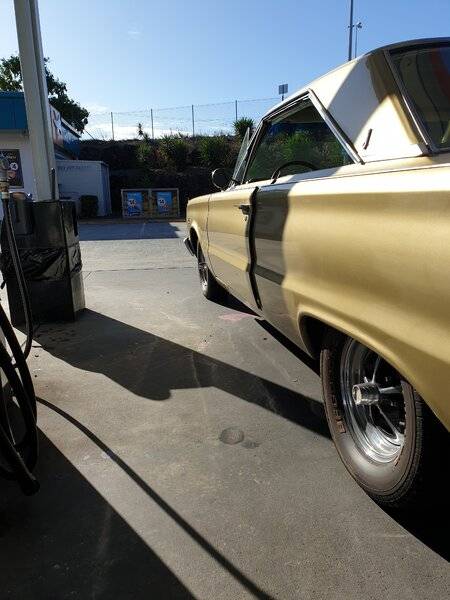

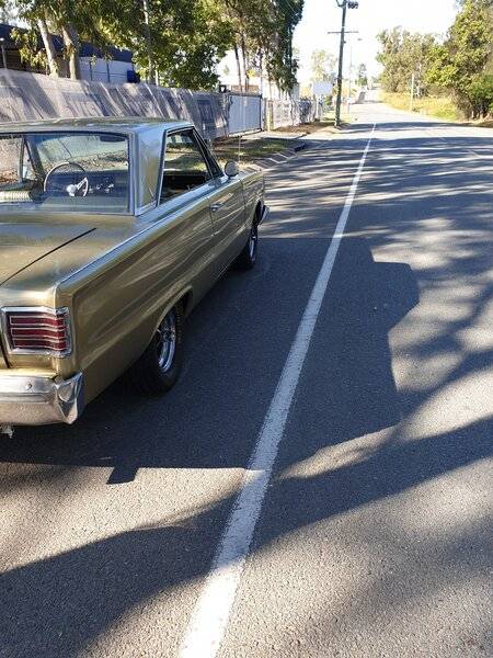

These are the "after" photos
The "before" photo below sort of shows the positive camber
