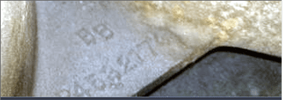

Chrysler Mystery [?] Intake
Thanks for your help! I guess on mine, the 2nd number is a 5 rather then a 6, so I couldn't find info on it. When I changed the number, "presto". It seems to be the "M1 Single Plane" intake just like you said, thanks!!!. Now I just need to figure out if it's any good, and if I should keep it. I guess they are discontinued now. Hoping if I ever have to pull it off, I can get the gaskets
I am wondering if these are more "drag race" type set ups, and not as good for a street machines
The regular Performer and DP4B are virtually the same. The RPM is different. Depending on the specifics of the motor and car, one might be better than the other.
