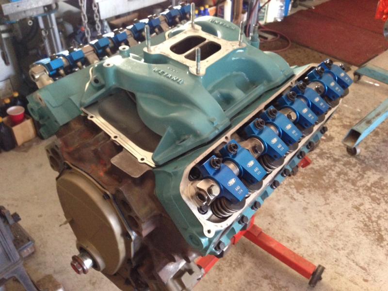

Collapsed lifter?
are those the stock red magnum springs? if so it ain't the cams fault. check the valve seals to see if they're clobbered and roll the push rods across a flat surface to make sure they aren't bent.
No idea what springs those are.
Again, I didn't build the motor and the fella who did is no longer with us.
They ARE newish looking, however. If they are the "magnum" springs you speak of, are you saying they're too stiff?
Push rods look to be re-used originals and they all check out true, thankfully.

I've seen a lot of cams like that over the last 15 years and it's not just the Purple Shaft MP cams doing it......
See, that's what I'm concerned about when buying another cam.
Which ones are considered more "quality" than others? Are they all made of "Chineseium" these days?
By the way, do any of you knowledgeable fellas see evidence of a lack of lubrication on that cam?
How are the lobes oiled, via the lifters?
...or is this a case of too stiff a valve spring, as lewtot184 is suggesting (I think)?
Anyone know what my "red springs" are?
It may be low quality materials or the lack of proper break in using lubes or oils low in ZDDP. If you didn't build and break in the cam/engine yourself, you just don't know. As for the springs, over the years, I like to use the lightest spring possible for cam break in. It's a pita but worth it. And the only way to know what you really have is to take them to a shop and check them.

my money is on improper brake in, pretty much all US cam makers make a quality cam core, but the changes in the motor oil over the last 15 yrs have wiped out TONS of flat tappet cams.
just get some Joe Gibbs break in oil with your cam of choice and follow the manufacturers directions.

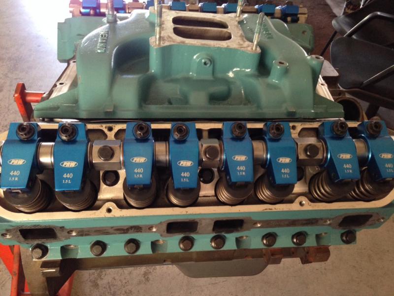

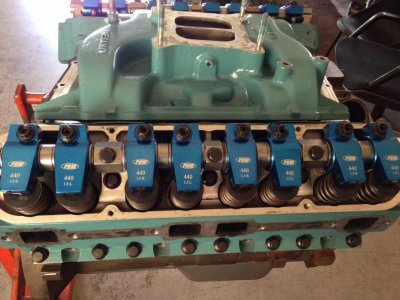

Essentially moparedtn, (Ed?) I was in your very same shoes, I recently purchased a 67 GTX from someone who had the engine re-built in So Carolina. The video is on the forum, anyway it had some issues so I decided to pull the entire engine apart and do the re-build my Bud.
I was afraid the 440 would LATHE the lifter like yours.
PS: The engine had less than 200 miles on it.
The 440 pics are from the pics I took last week. The Comp 268 is a broad torque cam. 1,600 t0 5,400 ?
