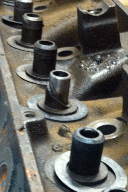

When I disasseblied the new 915 heads THIS shows up under one spring...
What to do? Can I use it as it is, and just prey, or can I fix it in any way do I start to look for another hobby.... ;)
