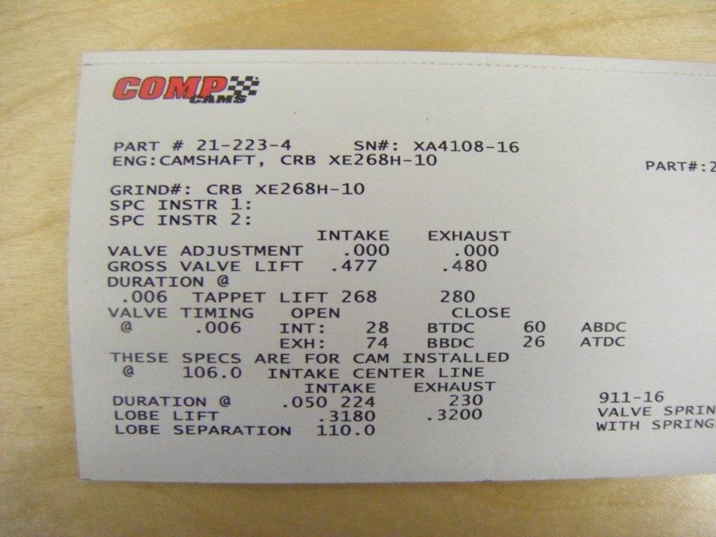

Yes. As soon as I have all the parts back from the shop I will start by measure clearance with the old cam (270/270) wich will give me some pointers on what to choose. I hope the clearance is enough to feel confident to buy the comp XE268 shaft.

You know, I'm running a .585 lift roller cam with 2.14 int and 1.81 ex valves. Duration @.050 is 243/249. I still have .080 clearance at the closest point. And my pistons are at .010 below deck. I have 4 small eyebrow reliefs in them. If you're running a shorter duration cam, under .500 lift, you should be OK. But you should always check it.

I just put some light springs on 2 valves, set the lash, and turned it over near the overlap @ TDC position. I checked clearance by putting an .080 stack of feeler gauges between the valve tip, and rocker arm tip. That method has always worked good for me. Especially if the heads are already on the motor. Need to use a solid lifter and adj rockers to check it like this.

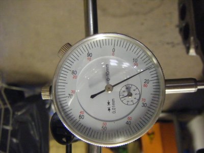

Here's a few pics from the build.

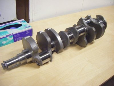

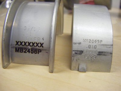

Crank was cut .010 and blasted spotless.

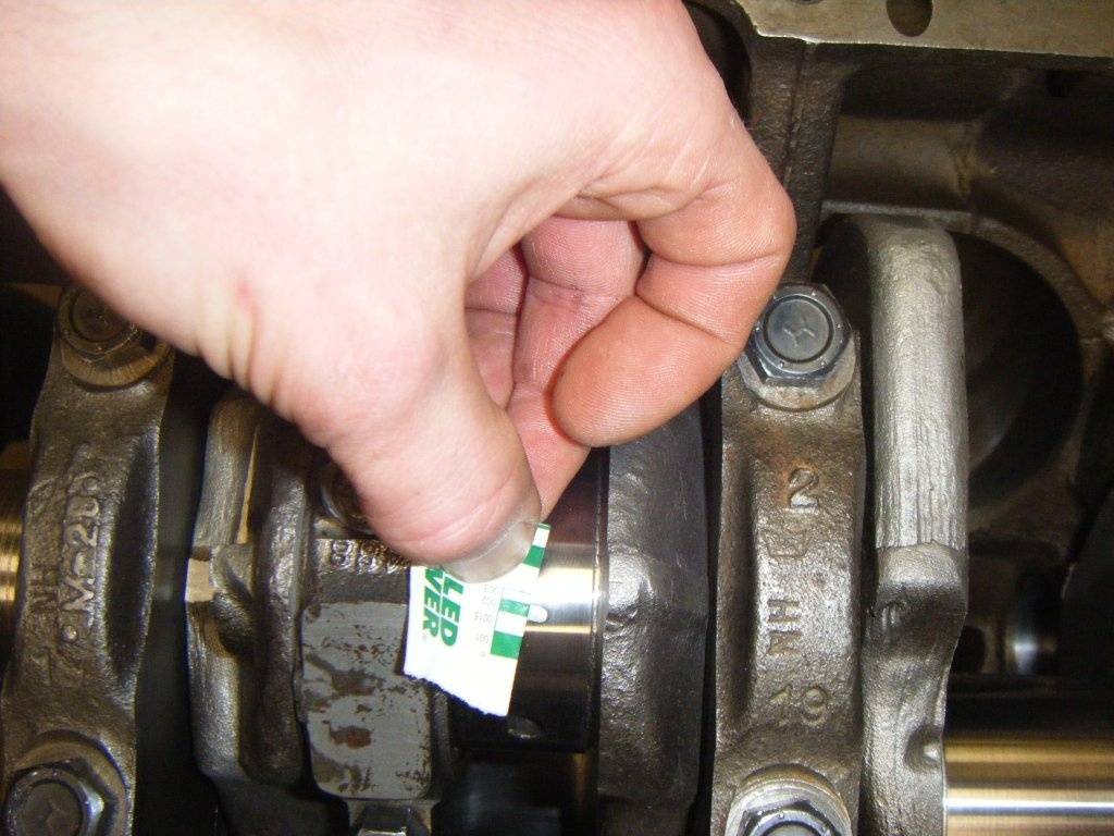

measured between 0.0015 and 0.0020 clearance with plastigauge on all journals.

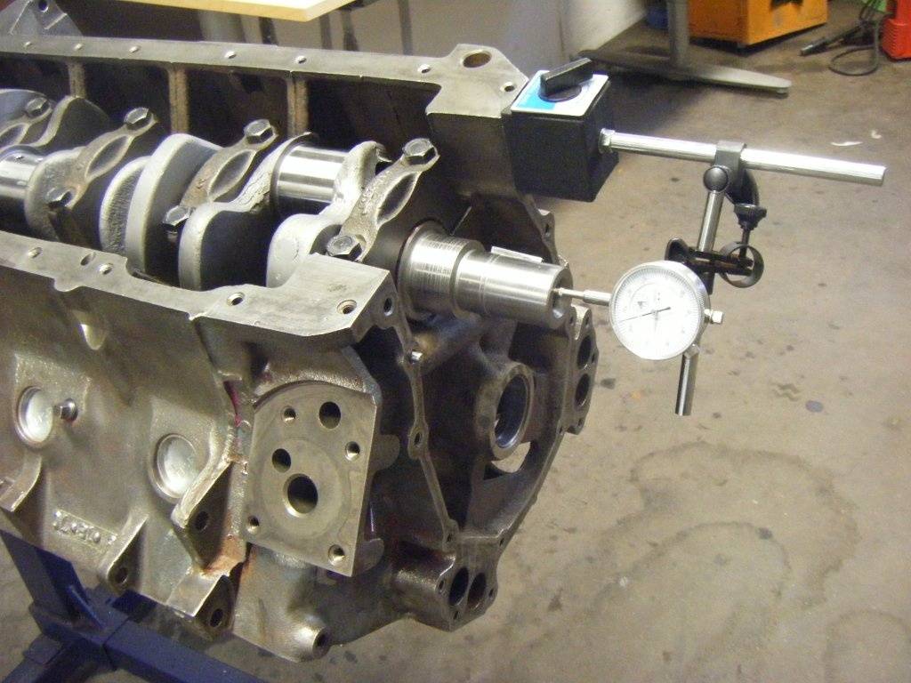

crank endplay .006" (0.155mm)

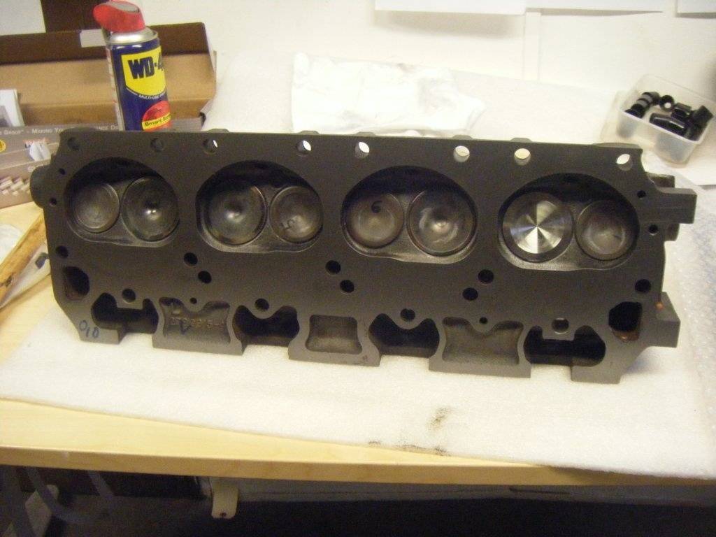

the 915 heads milled .010 with new valve guides and seats. Valves back cut 30degrees. Combustion chamber measured 74cc.
Piston to deck measured .022"
